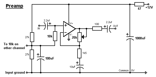

You showed a good electret mic preamp that uses a dual NE5532 or TL072. Why not use its unused opamp as an amplifier? Delete the input's 10K resistor and connect the negative end of the 2.2uF cap to the PDA's line output. Connect the 1.5K resistor directly to the 10uF cap without using the switched 27K resistor. Don't use a pot on the output and connect the output 2.2uF cap to the aux inputs of both channels of your stereo. Use a 20K or 25K pot wired as a rheostat gain control instead of the 33K resistor and don't bother using the 2 puffs cap. It will have a gain adjustable from 1 to 14.3 or 17.7 which is plenty.
I recommend using a rheostat gain control pot that replaces the 33K resistor in the mic preamp circuit too, so that you can turn down its gain if it overdrives. Don't use an output pot. :lol:

Sure, make a stereo preamp similar to the circuit that you posted. Don't use the 10k input resistor nor output pot and use a gain adjusting pot instead of the 33k resistor. It will be able to be driven by any circuit that can drive an impedance of 10k or much less.
With the gain turned up, you're darn right you'll have feedback! Without filtering for its bias, it will also have a good amount of alternator whine if you power the preamp from the car's 12V. I have added filters to eliminate alternator whine and here is how it should be wired with your dual opamp. :lol:

Also.. in the schematic it was mentioned to tie the 10k resistor to the other channel's 10k. What is the purpose of this link?

Most opamps won't work with a supply voltage as low as 9V, and a regulator needs an input voltage 2 or 3V higher than their output so a 12V regulator won't work in a car. The 47 ohm resistor and 1000uF cap and 100uF cap should take care of noises.
The 10k resistor establishes the reference DC voltage for the opamps. It connects to the two 27k resistors that set a half-supply voltage. It allows the output of the opamp to swing equally positive and negative with respect to the half-supply voltage. :lol:

You simply connect a 10K from the existing pair of 27K's to the inverting input of the other opamp - you only need the single pair of 27K's.
Hi Nigel and Indecided,
Both channels have a 10k resistor connected to the non-inverting (+) input of the opamp, and the other end of both 10k resistors connects to the junction of the two 27k resistors. :lol:
