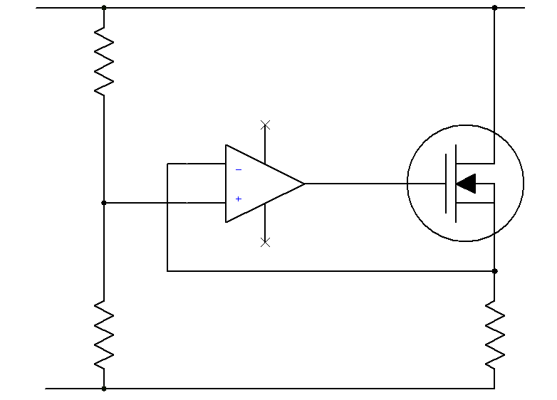

You could use a microcontroller to adjust the drive to give constant R, or you could use an op-amp as in the diagram. You can make the resistors on the left a digital potentiometer to give adjustability.
Or you could buy some big resistors and switch them in or out of circuit with mosfets. If you have 3 suitably chosen resistors, that gives you 7 values and open circuit.
yes this is what I did for the constant current.. currently, I don't want to use microcontroller as much as possible... since I know it will really work, I really want to exhaust all possible options first using op-amps or other methods. using MCU will be my last resort.

My design, and the one from Mr RB, should be constant resistance. In each case the voltage drop across a fixed resistor, is kept the same as the a fixed fraction of the total voltage.
oh yes... I didn't saw that... the top resistor is attached to the drain and as opposed to constant resistance circuits that the top resistor is attached to a fixed voltage. wow..

Hello Diver300,
I verified and it worked.
thanks for all those who replied. I appreciated it so much! :)
I'm glad to be of assistance.
I noticed that your divider has a ratio of 50% so the circuit effectively doubles the resistance of the physical load resistor.
I would suggest a much bigger ratio, so that less power is dissipated in the resistor and you have a wider range of adjustment. You can't go to less than the physical load resistor in any case.
