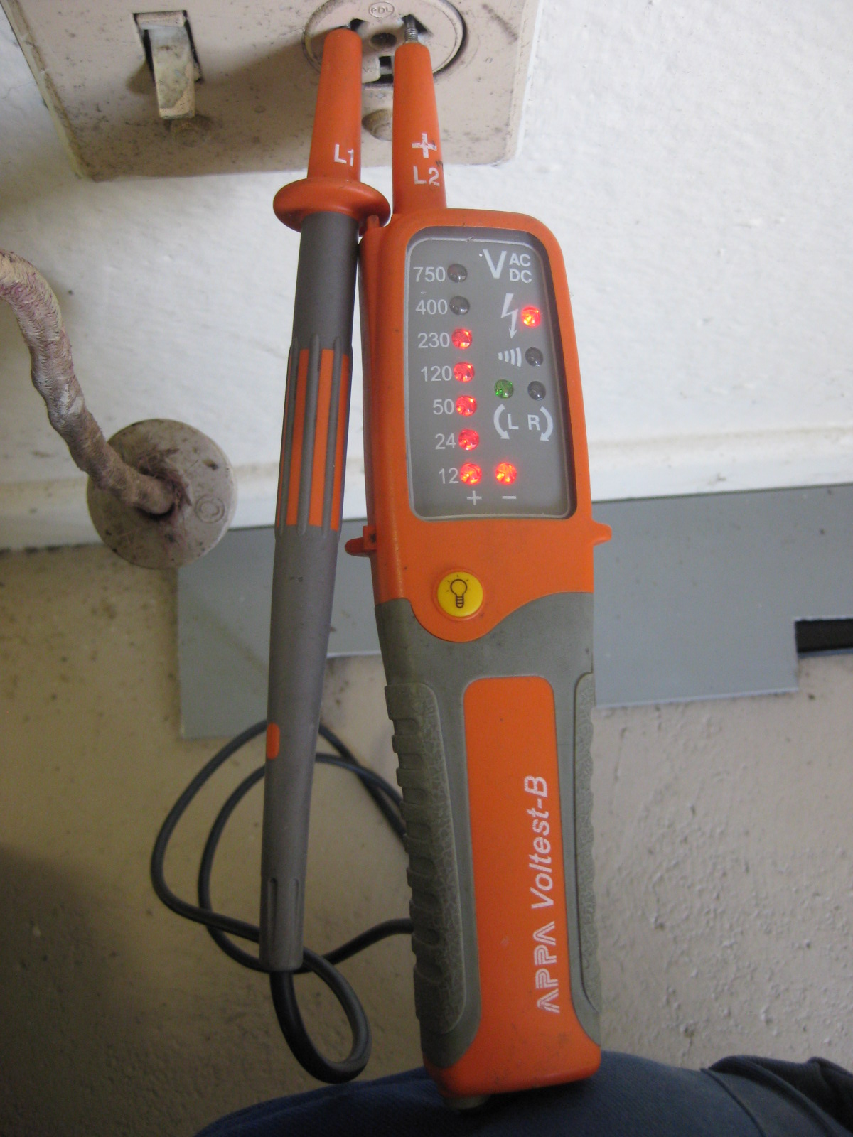

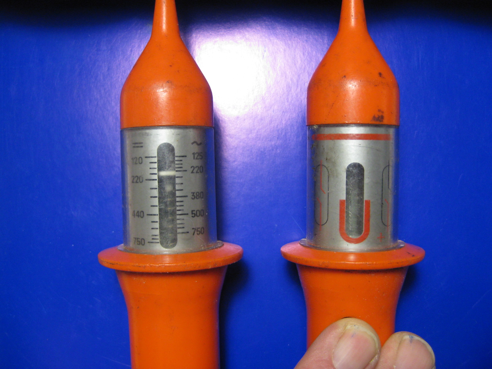

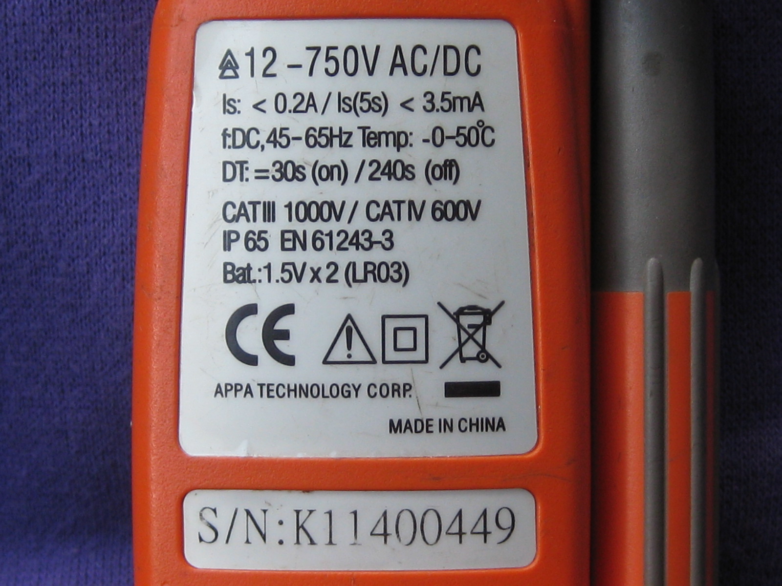

I took some photo's of my Appa and Bennings Duspols.
It appears that the older style Bennings duspol is not available anymore. Everything has gone to LED or LCD indication with or without Voltmeter display.
On the Bennings Duspol the Neon glows over 50 - 60 Volts AC. When the button is pushed the plunger pulls in, imposes a burden and gives a course voltage indication.
The Appa is self explanatory. To be hones I use the Appa most of the time.
