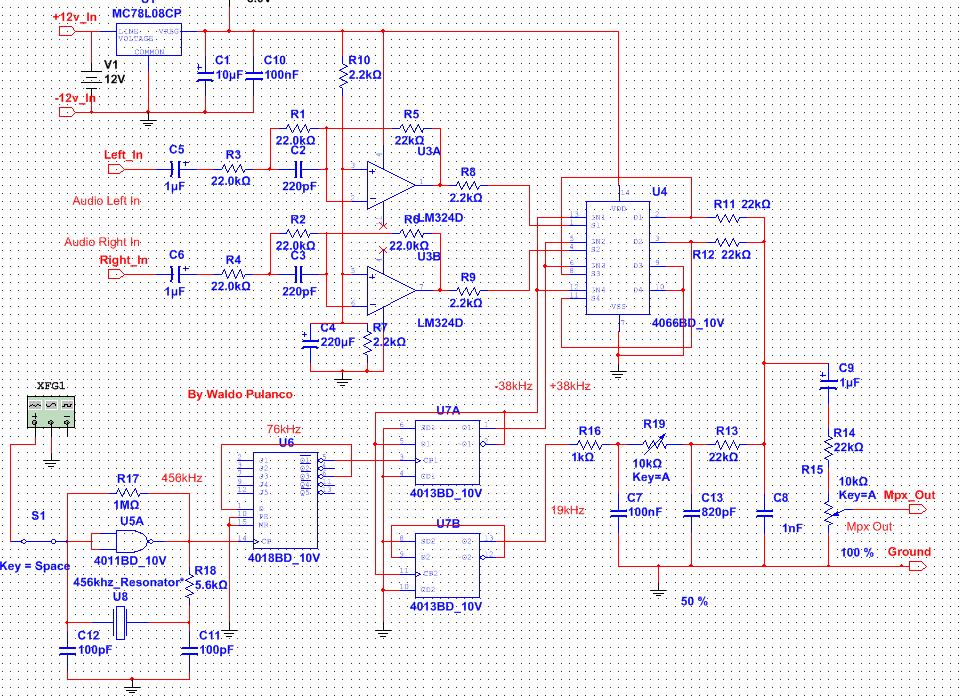

I am looking for LM358 Replacement, that there is no change the value of resistor or other component for the use of LM358. but low distortion and high frequency which is about 100khz and sigle supply almost similar to LM358 dual opamp.

Sorry hehehehe!! I use it with stereo coder!! the max frequency is 15khz the supply voltage is about 8v the output voltage peak is a max of 1v peak the input voltage is max of 1v peak..

What supply voltages will you be using? Will the output swing plus and minus?
The LM358 can handle 15kHz at 1v peak output (2v peak to peak) because the fastest dv/dt of a 15kHz sine is only about 0.1 v/us (0.1 volts per microsecond) and the LM358 can do 0.5 v/us.
To get the distortion in line, you have to bias the output with a resistor from the most negative supply voltage to the output. That eliminates the crossover distortion.
If this is to be a very high end system you may want to use a low distortion type op amp made exclusively for audio applications though. If you can test the LM358 as above then you can decide for yourself.

In an FM stereo coder the L-R 38kHz sidebands are from 23kHz to 53kHz which is much too high for a lousy old LM358.
It gets very confusing when your stereo coder thread is on a different website forum.
The LM358 lousy old dual opamp in Harry's stereo coder is not used for L-R. It is used as left channel and right channel input audio (20Hz to 15kHz) buffers with a gain of 1.
Switching the left and right channels on and off (alternating) at 38kHz creates the L-R 38kHz sidebands.

hehehe!! i forgot to post it on the forum!! i have 3 forum that similar post to ask an expert for every forum so i combine it!!
Post the circuit so we can all take a look ok?

i was change the opamp to LM324
theere is a problem uploading attachment i will upload it to other hosting!!

I have 4pcs of LM324 and 1pcs of LM358! what kind of dual opamp can i use? i have a problem on biasing specially on Opamp im not expert! if you give me a dual opamp what value of resistor and capacitor that i put it?

Also, i took a closer look at the circuit and if you want to try the LM358 or LM324 first then you'll need to connect 10k resistors from the output of each op amp to ground. That keeps the upper drive transistor of each op amp 'on' all the time so that the lower transistor can not turn on. The lower transistor inside the op amp is what causes the crossover distortion and it is significant without the 10k resistor.
Did you check to see if that op amp was good for audio purposes? It looks like it may have a similar output stage which means it may have crossover distortion as well.
In the data sheet they are claiming an "all NPN output stage" yet in the internal diagram they picture a PNP pulldown just like the LM358. So it's anybody's guess. If it is an all NPN output stage then it is probably biased to keep both transistors slightly 'on' at all times, which means little crossover distortion. There is also the possibility that this part is being discontinued also.
