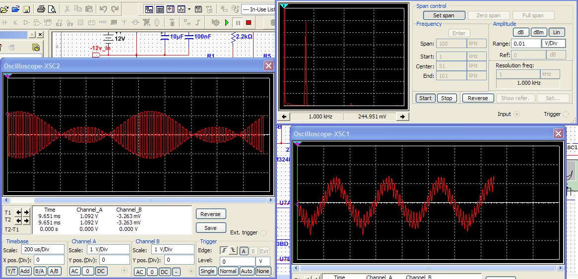

this is simulated using LM324!
the Oscilloscope - XSC2 - is the output of 1khz Audio modulated to 38khz carrier!
the Oscilloscope - XSC1 - is the final output of composite stereo with 19khz pilot!
Spectrum Analyzer - XSA1 - ther is harmonic at the range of 57khz with 2mV only, and the 19khz pilot is 70mV out!!

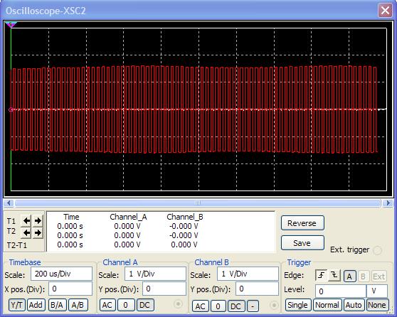

i tried TL072 but there is a problem in output! the output is very high peak, i did not change the bias and input resistor and output resistor from LM358!! what the correct value i use when TL072?
here is the screenshot that there is no change in value of resistor and capacitor
TL072 = As you can see the 38khz peak is very high at 1V/Div on oscilloscope, there is no Output Audio but i feed it 1Vpeak of 1khz Audio

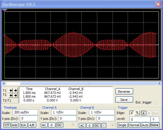

LM324 = there is A chop of Audio or 1Vpeak at 1khz Audio with modulated 38khz it is also 1V/Div on Scilloscope like on TL072 Oscilloscope!
how to correct the TL072 to make it modulate on Audio like on LM324?

You need a higher supply voltage to use that op amp. Maybe 10v might do it but 15v better.
The minimum supply for a TL07x opamp is 7V. On some of them the minimum output swing into a 2k ohms load is zero when its supply is 7V but I have used many of them powered from a 9V battery that drops to 6V playing music into a 10k ohms load.
Perhaps some may work at 7v, but due to the data sheet list you can not tell someone it will work at 7v because for a load of 2k the spec is such that the output could be 5 volts away from both rails, so that means with a 12v power supply we know we can get at least 1v peak sine output, but with anything less we may run into clipping or other problems. I suggested 10v to 15v with 10v as min, but now i would like to upgrade that to 12v min for a 1v peak output and that makes sure i covered all the bases. Also biased at 1/2 Vcc.
