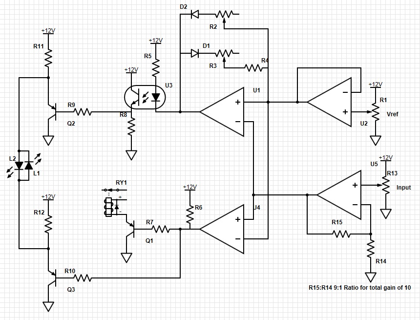

We have only been discussing one portion of the circuit. The section that I have believed is causing the issue. Here is the entire circuit.
There is no reference for the comparator. You need to set the reference in the center where you want it to switch and then use the hysteresis to adjust it.

I knew something looked wrong. I moved that opamp buffer 2 or 3 times. Turns out it was supposed to be Vref and I forgot the input stage.

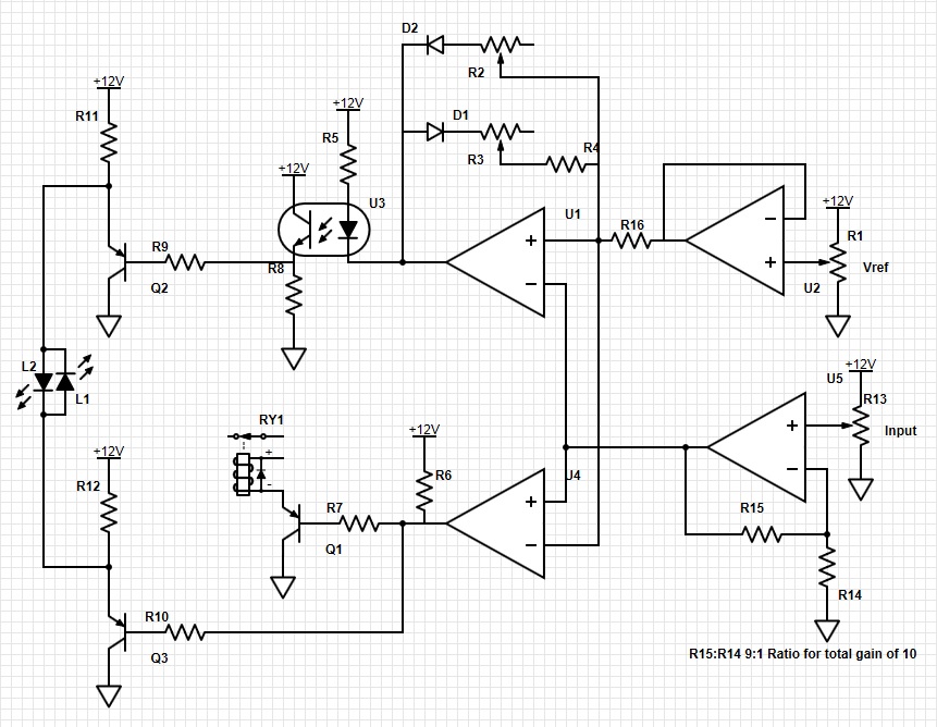

Now you just need a resistor between the ref. output and the input of the comparator so the hysteresis can move it around.
The only other thing I can think of now that might give you trouble is that if your power supply has ripple that is higher than the hysteresis you want it might chatter at the ripple frequency. But if you have much hysteresis at all it should be ok.

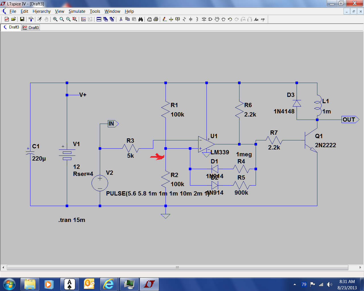

My target is about 0.5V hysteresis with Vref around 7V. I'm thinking the voltage(s) required to forward bias the resistors are somehow an issue. I'm using 1N914 diodes, the DVM says 300-400mV Vf drop. With Vin increasing, the chatter starts at VthLow and ends at VthHi. Based on my last circuit which diode is for VthLo and VthHi? I think D1 for Lo and D2 for Hi.
I have changed the power supply from prototype to final install. I will reconnect to the bench supply and see if I get the same result. I believe the bench supply is a Power One, the final install supply is one of these **broken link removed**. (spec sheet show 120mV ripple on the +12V supply)
Since I'm slow close I'd like to figure out what is wrong. I'll put this one into service while I concoct version 2. But I'm sensing a version two coming. I would really like to be able to set the thresholds independent of the state of the output. This circuit does not allow me to do that.

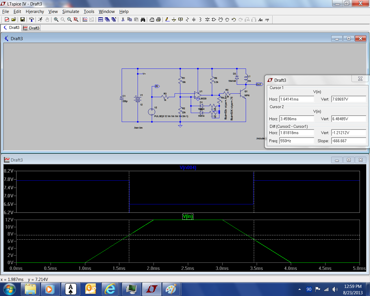

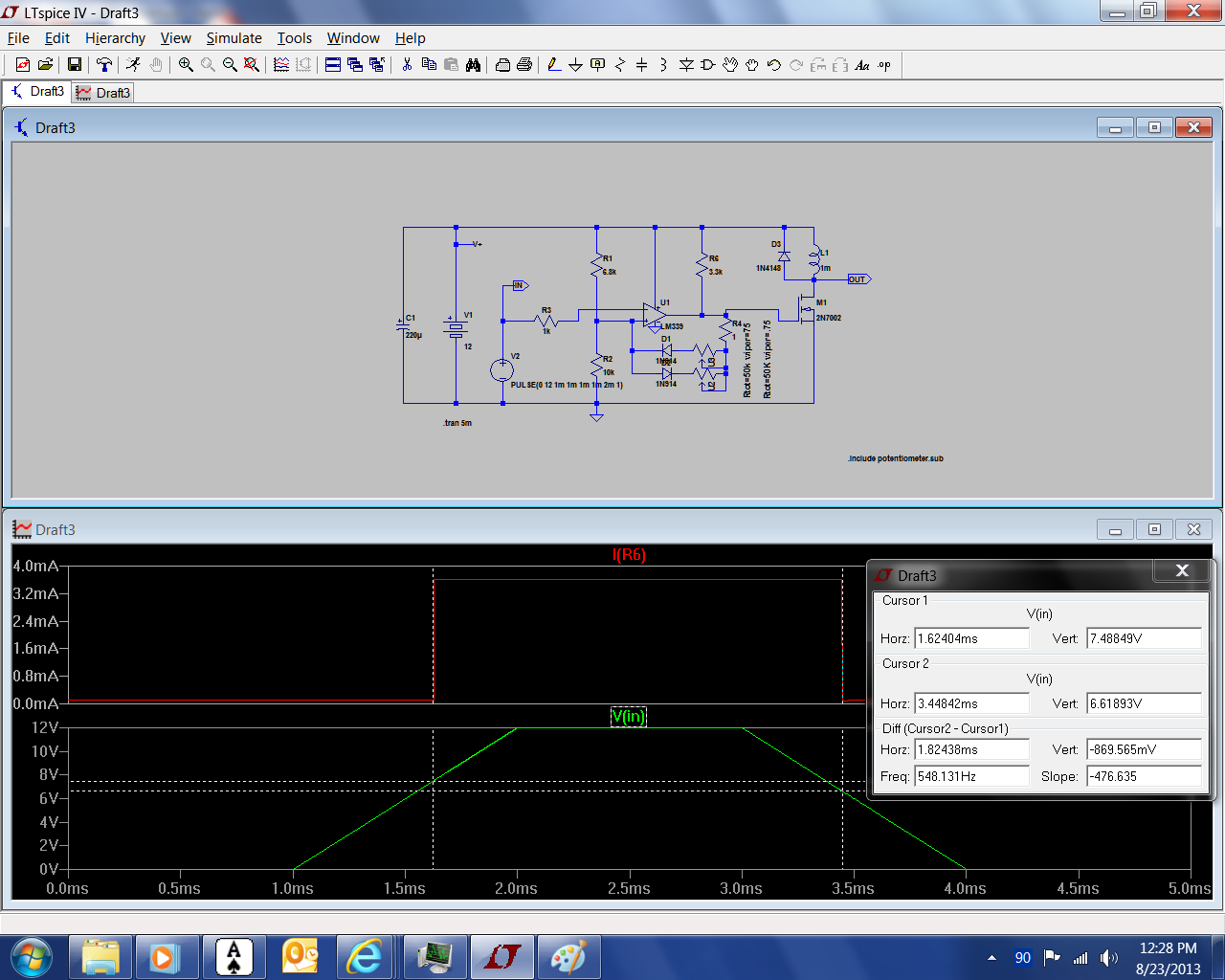

Now you have a problem. Since the output never goes above 6.65 volts you can't adjust the upper threshold high enough. If you change the transistor to a FET like a little 2N7002 you will get the full voltage swing at the output. Short of that you would need to divide the input down.

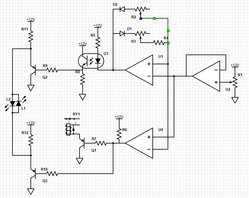

I lied. :eek::eek: You can bias up the reference like this:
The FET would be better for temperature and stuff like that, but this should work.

With the optocoupler in the output (per the schematic in post #27), LM393 Pin 1 output goes to just over 11 volts and as low as 0.4V (pullup current ~5mA, pullup R=2.2k). But the problem still exists. The relay chatters when VthLo < Vin <VthHi.
I think the first problem was the real one. But if there are different outputs you will need different sets of values for the 2 comparators since that voltage is in the feedback path. Try it with just the relay side and see how that works then it might be time to make them symmetrical.
I don't understand. The only change I have made is the optocoupler. Is that the 'first problem' to which you refer?
Why do I need two sets of values for the comparators? I have been using this configuration for years. They are not supposed to be symmetrical but inverted. Note the inputs are swapped, so the outputs are opposite polarities which allows the bicolor two-pin led to work. Since there is no feedback on the relay comparator and the inputs are VERY high impedence, having the second input tied into the same feedback/hysteresis circuit should not have any impact.
