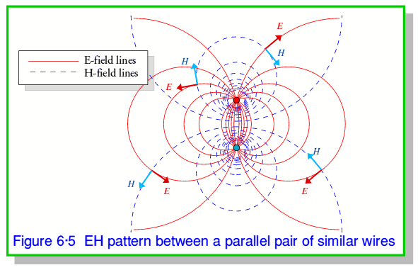

Because he is a troll. I briefly engaged him on an earlier thread and started answering this particular question, but he has clearly 'forgotten' this post from this thread:
Tesla23 said:
I found a suitable picture of the current flow between two contacts
This is the solution to a different problem (which is why the lines are labelled E and H), but the equations being solved are the same and so the picture is relevant. In the picture the E lines correspond to current flow (and the closer the lines are together the higher the current density) and the H lines for your problem correspond to lines of equal voltage (with equal voltage difference between adjacent lines). Note that the current density gets very high around the conductors, and the voltage gradient increases. This is what makes the problem very sensitive to the actual area of contact, and what I think is the achilles heel of the design.
If you want to explore further, you can get Maxwell SV from Ansoft, a serious commercial solver that is free, and has no limitations for solving this sort of problem. **broken link removed**
