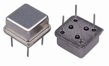

external oscillator (can type)
Is it a two legged part like this: (where you use two pins on the micro and have two capacitors)
or more like this: (where you use only one pin on the micro)

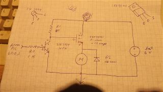

Here's the output circuit from the PIC. The MOSFET is plenty good for the small 6 volt motor. All is powered by a 6 volt SLA gel battery. The PIC circuit is simple as can be and uses the sqaure 1/2 can, 4 pin oscillator. I've also attached the complete code but it may be full of my own notes and reminders. The motor runs right away when powered up or reset then supposed to repeat after 24 hours. Inside on my work bench I tested 3 days and it was accurate to within a few seconds. It had been outside last week and acted the same way. I took it inside to check everything and was good so tested 3 days, flawless but when it gets out in the cold the long delay gets longer.

How are going from 6V battery to 3.3V for the micro? or 5V?
Regulator and what capacitors?
What are you doing with the reset pin?
I'm dropping the 6 volt with 2 diodes in series. Have 10 and .1 uF capacitors across Vdd/Vss. MCLR pulled up with series 100 and 10k resistor with reset switch to ground between resistors
Can you post a complete schematic that's bigger than a postage stamp - including ALL components. What you posted above is unreadable.

There could be lots of reasons which is why I asked for a complete schematic - but the outside conditions would be helpful too. Reading between the lines it sounds like proper decoupling capacitors are missing. Couldn't see from the diagram above if the mosfet is N or P and how it's being turned on etc.
He states he is using the "IR9540 ", I think he means the IRF9540. That said, full on requires -10V Vgs, which cannot be supplied via a 6V power supply. He may be better off finding some different "logic level" P channel MOSFET instead. While it may work with the setup he has now, the MOSFET may not be fully on.
Also, why high side switching? Maybe that is the way it was in other schematic, but using a IRL type (like IRL540) N channel MOSFET on the low side for switching should also work, provided the high/low logic is checked for proper levels. This would allow direct gate control from the PIC without the need for an intermediate transistor.
Looks like no internal osc being used.
