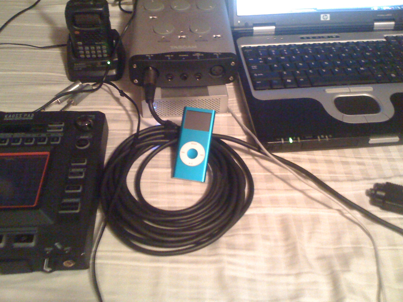

I found a DB-15 F connector and built my proto right off of it.
.: IMG_0700[1]..jpg.: .:IMG_0705[1]..jpg:.
This is one i made just to make sure that It works.. and of corse it does...
illll try to make a schematic in paint and post it later.

Note: If using as a SUB ONLY 6&3 get tied together and get capacitor coupled over ground instead of using the balanced method. This will Give you one input )
p.s. before you connect any audio sorce, Test your audio input for voltage...
My blue iPod Nano is now sounddddllleesssss!
.:IMG_0707[1]..jpg:.
AGAIN before you connect any audio sorce, Test your audio input for voltage...
.:View attachment 40003:.
Hi HxCxK ,
I am not sure what you mean, the remote pod can destroy the ipod?
When you mean Test your audio input for voltage you mean
a) to test the audio input circut on the remote for voltage. I this case there should be now voltage, correct esp not the 17v
b) or do you mean to test the ipod audio signal for correct voltage...
