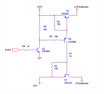

Yes. This circuit would be the kind of thing you want for that. A high logic level will turn on both supplies, a low will turn them both off.
The only concern I have is that the circuit dissipates almost 1 Watt, most of it in the 1k resistor. That resistor could be changed to 1.5k, which would reduce the dissipation to less than 600mW, but it's still pretty high. Changing the load switches to MOSFETs (and changing some resistor values) would allow the dissipation to be reduced dramatically, as long as switching speed isn't an issue.
As a side issue, the value of R4 could be at least an order of magnitude larger.

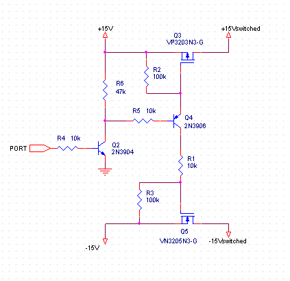

Ugh, I didn't even notice that. Here, got rid of the 1 watt resistor. On state resistance is .3 ohms, 50v breakdown, over an amp of on-state goodness in a TO92 or smaller package.
Thanks duffy the negative MOS schematic is good , Though I was a bit reluctant with the BJT pasrt due to its heavy dissipation.
