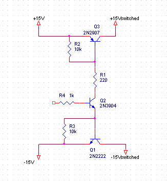

I have following supplies going to my module:
+15V,-15V,GND . I want to switch it ON/OFF , which is the best way to do this . Is it enough to switch the +15V line , or a switch at -15V is required too ? if yes how can -15V be switched N-Channel Mosfet?

Actually I want to switch off an IC when not in use for the measurement . Can you please tell me what damage could result if only -15V and GND keeps connected and +15V is raised. I think to use PMOS and NMOS to do this .

Shoot, if it's under 200 ma you could just use a 2n3904 and a 2n3906.
Dead simple - emitter of the 2n3906 on +15v, emitter of the 2n3904 on the -15v, collectors are outputs. Now, make a series circuit running the base of the 2n3906 through a 220 ohm resistor to the collector of a third 2n3904, the emitter of that to the base of the 2n3904. Switch that transistor on and it turns on both supplies. This second 2n3904 will bias on at -13.6v. If that isn't convenient, there are other ways to do it - what is delivering the switch voltage? A port pin or something?

dark - something like this -
I replaced the 3904 with a 2n2222 and the 3906 with a 2n2907 to increase the current capability from 200 to 600ma.

Q2 has to be driven by a signal referenced to -15V.
Yes, like I mentioned in an earlier post, it will turn on at -13.6v. The could be an advantage or disadvantage depending on the rest of the circuit. You could change Q2 to a 2n3906 and flip that part of the circuit upside-down to get it to work with a ground reference, but then it's inverted and sitting near +15v, so you would add a fourth transistor...
Better to wait and see what dark is driving it with.
Duffy , I do have a reference GND for the IC . I have the circuit for running upto 85C and I think 2N3906 cant be sinked for worst temperature conditions or am'I worrying too much.

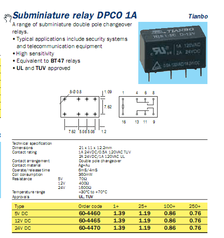

Sheesh, its not hard, a minature DPDT relay would solve the problem simply. No leakage and as small as a circuit involving transistors.
I'll go with that, simple, small and cheap.:)
