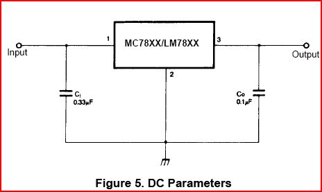

I have a 9V battery and i want to turn on a microcontroller. I am using LM7805 as a voltage regulator. what caught my eye is why i need to use capaciter ??
I tried without capaciter and it work!
The thing that amaze me is the suggestion of manual LM7805 to use capaciter.
See diagram below
hi uaefame,
Some of the older 780X Vregs can go unstable under certain conditions, the low value caps are there to prevent the instability, I would recommend you fit them.
Use the capacitors. I was using a 7815 voltage regulator without them one time. Sure enough I got 15V out of it when I was using a multimeter, but when I hooked up an oscilloscope it showed there was a large AC voltage superimposed on the 15V at a frequency of just over 1MHz. A multimeter will never catch anything like that. The data sheet for this specific regulator said it didn't need any capacitors, but when I put an output cap in there the high frequency oscillation went away.
7805's rely on the low output impedance of the emitter of their pass transistor to ensure stability. That impedance is not something that should be relied upon to be 'low enough'. Use a capacitor. 0.1uF ceramics are cheap.

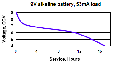

I have a doubt on this. When a 9V battery drops to 5.5, where is the capacity in the battery to deliver power, even if the LDO regulator accepts the input and tries to give 5V DC as output?
Hi Sarma,
The internal resistance of an alkaline battery increases which causes its loaded voltage to drop. Then a low dropout regulator simply turns on more to keep the regulated output voltage at 5.0V.
If the load current increases then the voltage from the battery drops. If the load current decreases then the voltage from the battery increases.
Here is a graph of the loaded voltage dropping from Energizer's 9V alkaline battery:
