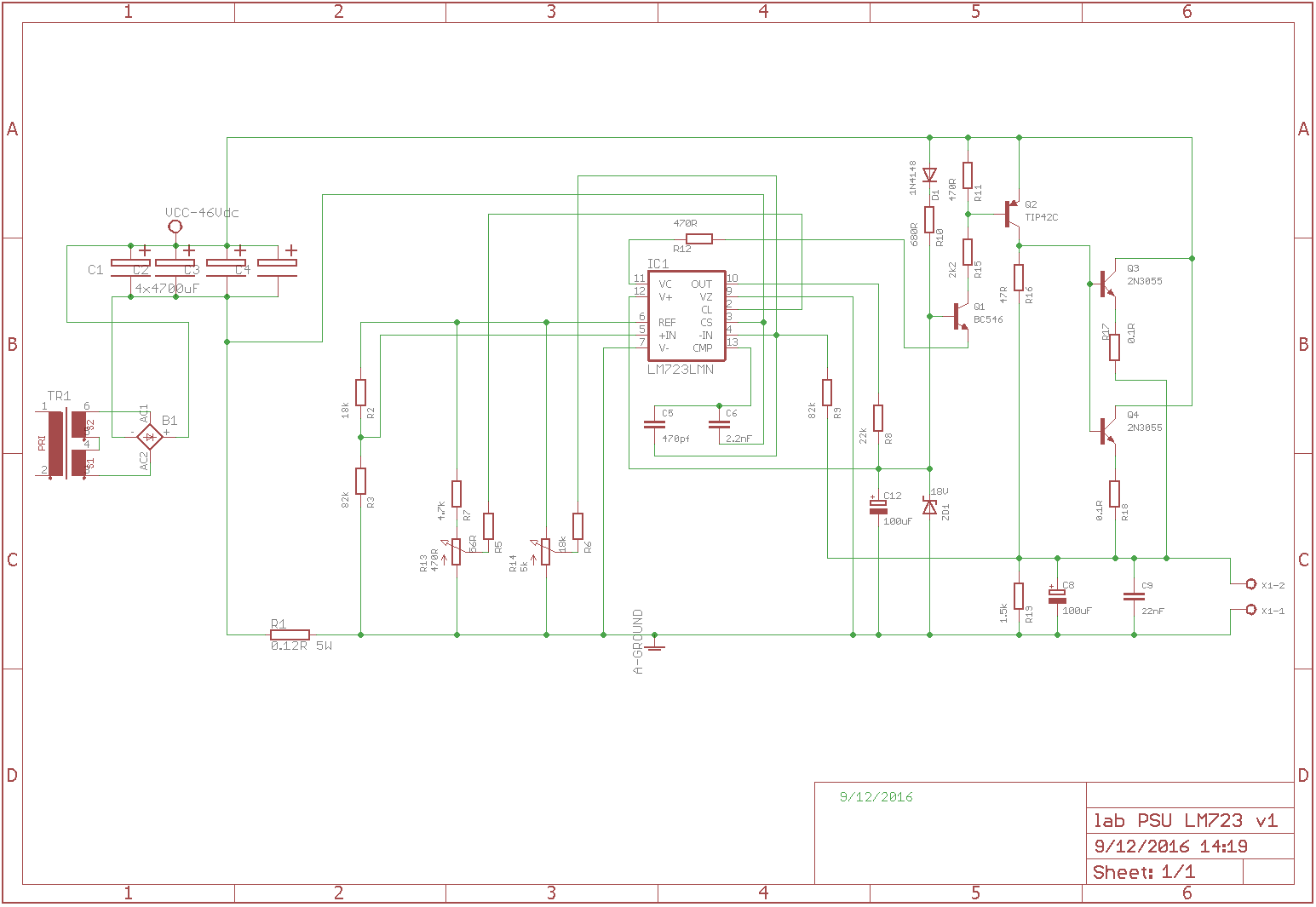

I studied all the ideas of the last few hours and have a few questions, just to confirm before I start building tomorrow (and spec: I promise not to wait until the prototype is ready and finished, I try to start on the Eagle drawing tomorrow):
I refer to the drawings in post 113 and 119:
1. I miss the voltage feedback circuit to -comp:
a. no need to recalculate the voltage divider 18k / 82k?
b. value for the voltage regulator pot: remains at the original 2k2?
c. maximum 46V gets fed back to -comp via the 82k resistor: +comp remains unchanged compared to the original circuit; surely this is not right?
2. 18V zener regulator: currently based on 40mA (both zener bias and total load for 18V).
a. Is this sufficient?
b. Why 18V and not for example 30V? 36V?
c. Why not a series regulator with a transistor? (if it can be solved with a zener, sure why not?)
Thanks a lot!!
Erik

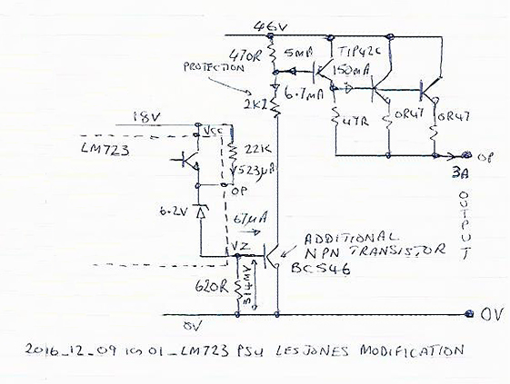

Edit 2. I have just has a look at your new circuit. It will subject the collector of the internal pass
transistor to the full 46 volts. Also the 39 volts you are using to power the LM723 is closer to its maximum rating than I would like.
Les.
Full agree, 39V is too close to the LM723 max ratings.
What about using 36V zener?
What is the problem of connecting the collector of the internal pass transistor for the series regulator to the rectifier output?
Transistors have a maximum collector/emitter voltage rating and if it is exceeded they can fail. I think 36 volts should give a safe enough margin.

I did wonder about connecting the base to Vz but the non liniarity as the Zener just starts to conduct may cause instability. In the original version you kept the Zener biased into conduction with a resistor to the positive rail. This would not now be possible using the internal Zener.
You could still use the same approach- just put a resistor between the base and emitter of the new transistor so that the voltage drop across the resistor is not more than about 350mV, so that the additional transistor is not turned on.
The only problem I can envisage is that a grounded emitter transistor will introduce more current and voltage gain, which could make loop frequency stability more difficult, especially with the PNP driver transistor.
I did not look at the modification to look for mistakes but just to see how you had solved the problem.
It would be much appreciated if you did look for mistakes- my stuff needs to be checked.:D
spec
Hi spec,
The resistor between base and emitter should work. (Why didn't I think of that.) I think Eric may as well stick with your design to save doing another schematic. I like the way you explained to him about the way to makethe schematic easier to understand. I was mentaly turning the PNP transistor upside down so the emitter was at the top.

Schematic attached; upload of .sch not allowed, so I zipped it.
Edit: zip edited to include exit capacitors
Edit 2: I do not understand the drawing in post 132? Where is the output voltage driver?
Edit 3: added the schematic in .png format
  • lab PSU lm723_edit.zip
The output transistors are the two NPN transistors, as before.
The output NPN transitor driver is the TIP142C, also as before:)

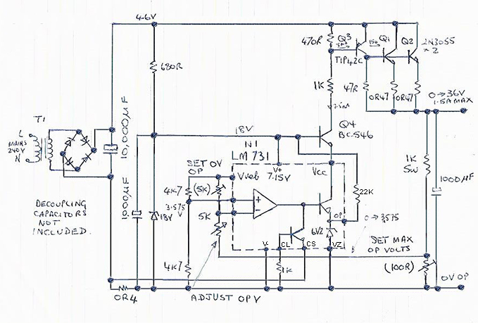

POST Issue 03 of 2016_12_09
Hy earckens,
Below a complete schematic for the LM723 power supply, with the following features:
(1) Common base transistor to limit the voltage seen by the LM723 (and not increase loop gain).
(2) Output voltage adjustment from 0V to 36V (but note my previous comment about getting down to zero Volts and leakage currents).
(3) Only a simple constant current limit of 1.5 A, which is the maximum current that two 2N3055 transistors will safely provide, as previously stated.
spec
Hi spec,
Sorry to do this again but I think the base and emitter of the current limit transistor need swapping over.
Les.
Hi spec,
Les.
Don't apologize Les; your keen eye is much appreciated.:cool:
I will update the schematic of post #137
spec
