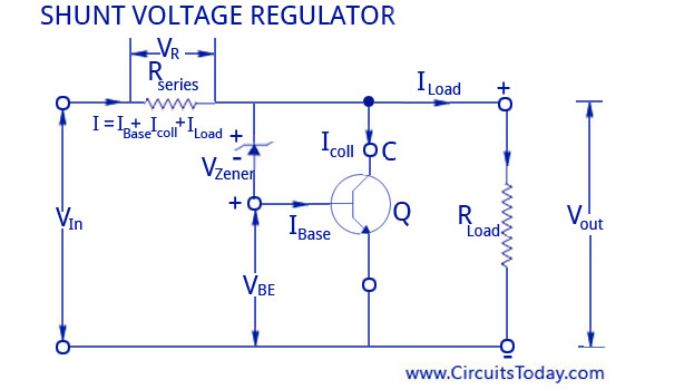

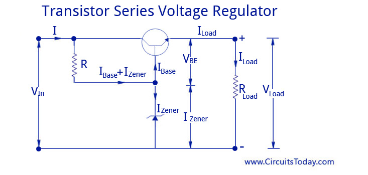

I miscalculated; this will not work: I would need a 50W zener and a 5 ohm resistor!
Apart from another transformer, what are the options?
To reduce the voltage in the PSU from +/-46Vdc (rectifier output) to about 36...39Vdc fixed voltage (IC and other components supply), with current varying between 200mA and 700mA: series or shunt regulator?
TIP41C or TIP120 darlington?

I have a good solution, but I didn't post it in case you wanted to investigate a solution yourself. But as you asked I will post my solution.
To reduce the voltage in the PSU from +/-46Vdc (rectifier output) to about 36...39Vdc fixed voltage (IC and other components supply), with current varying between 200mA and 700mA: series or shunt regulator? TIP41C or TIP120 Darlington?
Pretty clever approach- I had not thought of using a Darlington (by the way, we should be talking about a TIP42C and TIP127, both of which are PNP transistors rather than NPN).:)

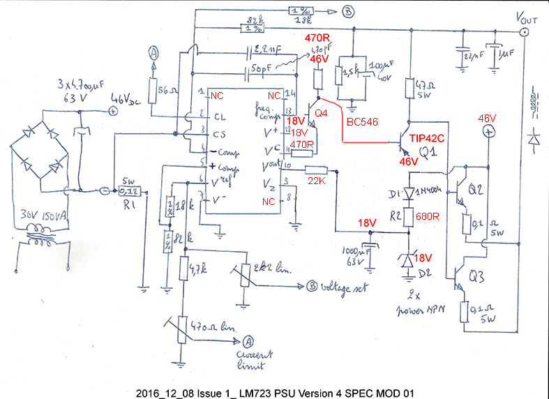

POST Issue 2 of 2016_12_08
Hi earckens,
The schematic below shows your schematic with the mods I suggest to:
(1) Cater for the 40V supply limit of the LM723 (the LM723 supply voltage has been reduced to 18V)
(2) Provide sufficient base drive current for the output power transistors
(3) Allow the PSU output voltage to only be limited by the 46V input voltage across the reservoir capacitors.
spec
Hi spec,
Shouldn't the left hand end of the 470R resistor on the emitter of the left hand Q2 (The added transistor.) go to pin 11 (VC) rather than pin 12 (V+) and V+ conected to +18 volts. (As you have said in the text of this post.) I like your idea of the common base stage. I had been thinking of effectively replacing the internal pass transistor with an external transistor with a higher voltage rating and its base drive would be via the base emitter juction of the internal pass transistor. I was thinking of just leaving the collector of the internal pass transistor disconnected as we would not need the extra current gain. Your solution saves having to have an external 6.2 volt zener. (That my idea would require.)
Les
Hi Les,
Thanks again Les- my excuse is incompetence.:eek: (but messing with a PDF in Photoshop is a bit demanding and I find it difficult analyzing the circuit when it does follow the layout rules- sorry earckens)
I like your idea of the common base stage. I had been thinking of effectively replacing the internal pass transistor with an external transistor with a higher voltage rating and its base drive would be via the base emitter junction of the internal pass transistor. I was thinking of just leaving the collector of the internal pass transistor disconnected as we would not need the extra current gain. Your solution saves having to have an external 6.2 volt Zener. (That my idea would require.)
Hmm, I suspect that your approach would be neater. I don't think you would need an extra external Zenner- just feed the base of the new NPN transistor from Vz.:)
spec
Hi Les,
Schematic of post #113 updated in line with your findings- could you give it a check to make sure I haven't made any more errors.:arghh:
spec
Hi spec and Les, I sure find it amazing to have such great companions in my stride! What a lot of thinking has been had here, I sure wish I could invite you to the local whisky bar here close by (real Scottish pub!).
To spec: very good idea to use the Q4 as emitter follower before the initial PNP drive stage. This way the supply goes all the way to 46V.
1. But does the supply also go all the way down to 0V?
(I think it does: Vbe Q1 must be 0V, only as Q4 is closed and Vc Q4 is 46V. But I am not sure?)
2. Where in the original design the PNP driving stage had its emitter on Vsupply (from the rectifier) and the transistor was driven at the base by Vc (pin 11) you now drive a NPN with its base at fixed 18V using the emitter at Vc (pin 11): Vc must go low to get an output voltage on the PSU, same in both scenarios: is this the correct interpretation?
3. You use a 680R for the 18V zener: only 40mA required for both zener and load at 18V?
4. Attached is my idea I had worked out earlier today for a series regulator instead of a zener driven supply voltage (before I saw your work of today here just a short while ago): would you give me your critical review please?

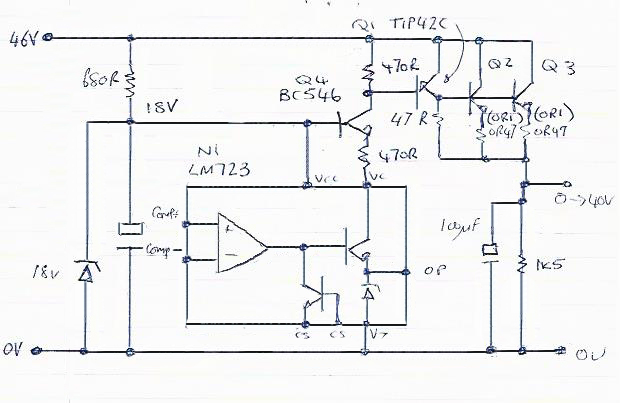

Edit, Hi Eric, I have just read your post #117. Q4 is not an emitter follower it is a common base amplifier. It works by keeping the base at fixed voltage an pulling the emitter more negative which causes the collecter current to increase.
Edit 2. I have just has a look at your new circuit. It will subject the collector of the internal pass
transistor to the full 46 volts. Also the 39 volts you are using to power the LM723 is closer to its maximum rating than I would like.
Les.
Below is a schematic showing the arrangements of the output transistor drive in a form that is a lot easier to follow (posted before posts #117 & #118 were visible).
spec.
Hi earckens,
That sounds like a great idea, but I would rather sample some of your national brews.
Yes, it does.:)
Absolutely correct
3. You use a 680R for the 18V Zener: only 40mA required for both zener and load at 18V?
I haven't worked out the current budget around that area, but yes, 40mA sounds about right.
PS 1: how do you manage to include a drawing in your post?
Only certain files types will display, mainly .jpg and .png. .pdf will only show a clickable icon.
Just upload the file that you wish to display. If you do not click FULL only a clickable icon will be displayed as for .pdf, but if you click FULL the image will be displayed.
