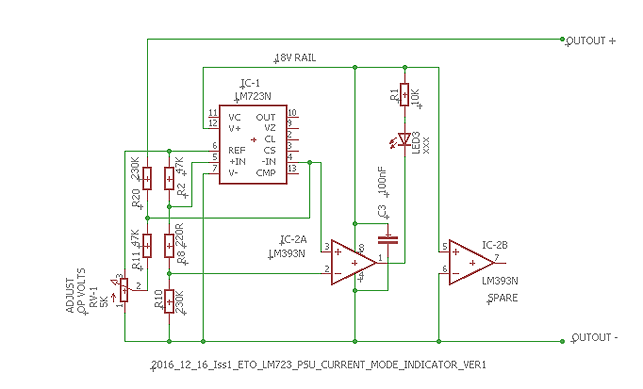

Hi earckens,
Below is the constant current mode circuit.
