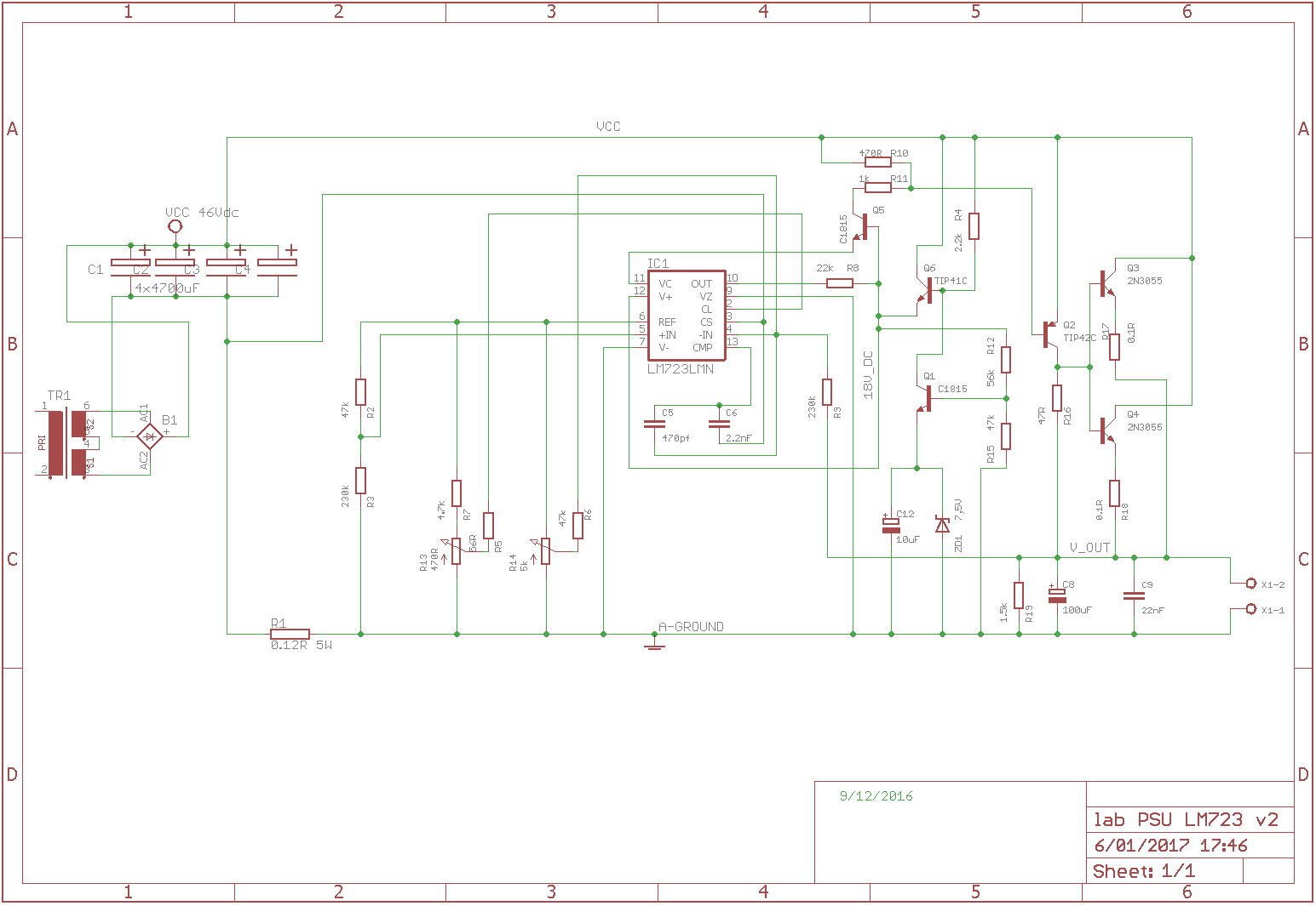

Hi earckens,
Below is my version of a power supply, current mode indicator (a touch of input offset voltage and hysteresis will be required for a practical implementation).

The C1815 should be OK but not advisable: the CEo is only 50V compared to 65V for the BC546.
The function of the BC546 is only voltage level shifting- no current gain is involved. The same current that is sunk from the emitter, essentially flows into the collector.
spec
ok spec, now I did this: I made a hybrid from your drawing 2016_12_08_LM723_POWER_SUPPLY_V4_MOD1.png and my idea of using a series voltage regulator with a Darlington TIP120. I also introduced your substitute values for the voltage and current feedback circuit (18k to 47k and 82k to 230k, twice).
The value for R1 seems unchanged but I still have to update this after your post this morning about SOA.
Would you mind having a critical look at it please?
Thks, Erik
PS: somehow this drawing now appears on top of this post??? ..big enough? o_O
Edit 13/12: corrected errors; replace 470R between Vc pin 11 and emitter 2SC1815 with a short, and add R11 (re. post 135)**broken link removed**

Hi earckens,
In terms of circuit function, your new circuit and your previous circuit are the same.
The LM723 only needs around 14mA so the Darlington transistor is just adding to complexity and reducing performance- sorry.
Your previous schematic was OK.:confused:

Yes, best to get the fundamental power supply working and then you can add on as many bells and whistles as you like.:cool:

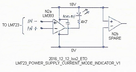

spec
**broken link removed**​
Hi spec, somehow I had missed this post. Where do IN- and IN+ come from? -comp and +comp form LM723? And is this with a LM393 (not very legible)?
Erik
Hi earckens,
Yes, that is correct.
Yes, an LM393 dual comparator. Sorry about the confusing sketch. I was not feeling too good yesterday- too much amber nectar the night before.:D
The principle of the constant current mode indicator relies on the fact that if ever the IN+ (+comp) input of the LM723 is more negative than the IN- (-comp) input, the power supply must be in constant current mode.
spec
PS: I have made the sketch a bit clearer- I hope:)

Hi earckens,
spec
DATASHEETS
https://www.ti.com/lit/ds/symlink/lm393-n.pdf
Great! I will implement this one. Simple, effective and more economical than a software solution (time needed for programming, testing, calibrating, wiring.. ).

Hi Eic,
The circuit is only an outline and, like I said, needs a bit of hysteresis, but that is no big deal.

PS: By the way you need a 100nF ceramic capacitor directly across the supply pins of the LM723 in your power supply schematic.
Hysteresis on LM393: R1 from output to +IN, R2 from +IN to GND?

Hi earckens,

Hi earckens,
Which previous schematic do you refer to spec?
The previous circuit (and best) is shown by the .png file attached to your post #135 as opposed to the later circuit of post #163.
I could use your straight Zener regulator but I need a bit more current for a MCU and LCD; I toyed with your idea of keeping it simple but I decided to go for the Darlington regulator because it still is a straightforward circuit and I would need it anyway.
The two VBEs of a Darlington will seriously degrade the regulation of the 18V Zener diode.
Not only that, but the extra current will be flowing through the current sense resistor and will mess up the current sense accuracy. Also, the processor and LCD, being digital, will introduce a whole load of hash into the precision voltage control and current control sensing.

So it would be much wiser to keep the core voltage regulation functions isolated and separate from the processor and LCD.
...o_O.. spec, can you please explain?
..I could also use a straight TIP41C..? ..or this (http://www.skillbank.co.uk/psu/vr2.htm)
Edit: example Vz1=7.5V, R1=2.2k, R2=56k, R3=47k, Vin=46V, Vout=about 18V, TR1=TIP41C
Ok; but now I am out of ideas: how would you then supply the extra 250mA max (10V to 20V or so: I use a LM4040-5.0V for the last stage)?

Hi earckens,
could you send me a copy of that one, i am afraid not to have it anymore?
I never did have a copy of that schematic; it is a schematic that you drew in EAGLE and attached to your post 123. It is still there- just click on the shortcut.
I would use a separate mains power module, like this: https://www.befr.ebay.be/itm/5V-600...808143?hash=item4ae58d144f:g:qAYAAOSw-0xYSCqw. There are many different types on Belgium EBay.
You can then connect the 0V output of the auxiliary mains power supply without worrying about current going through the current sense resistor.:)
