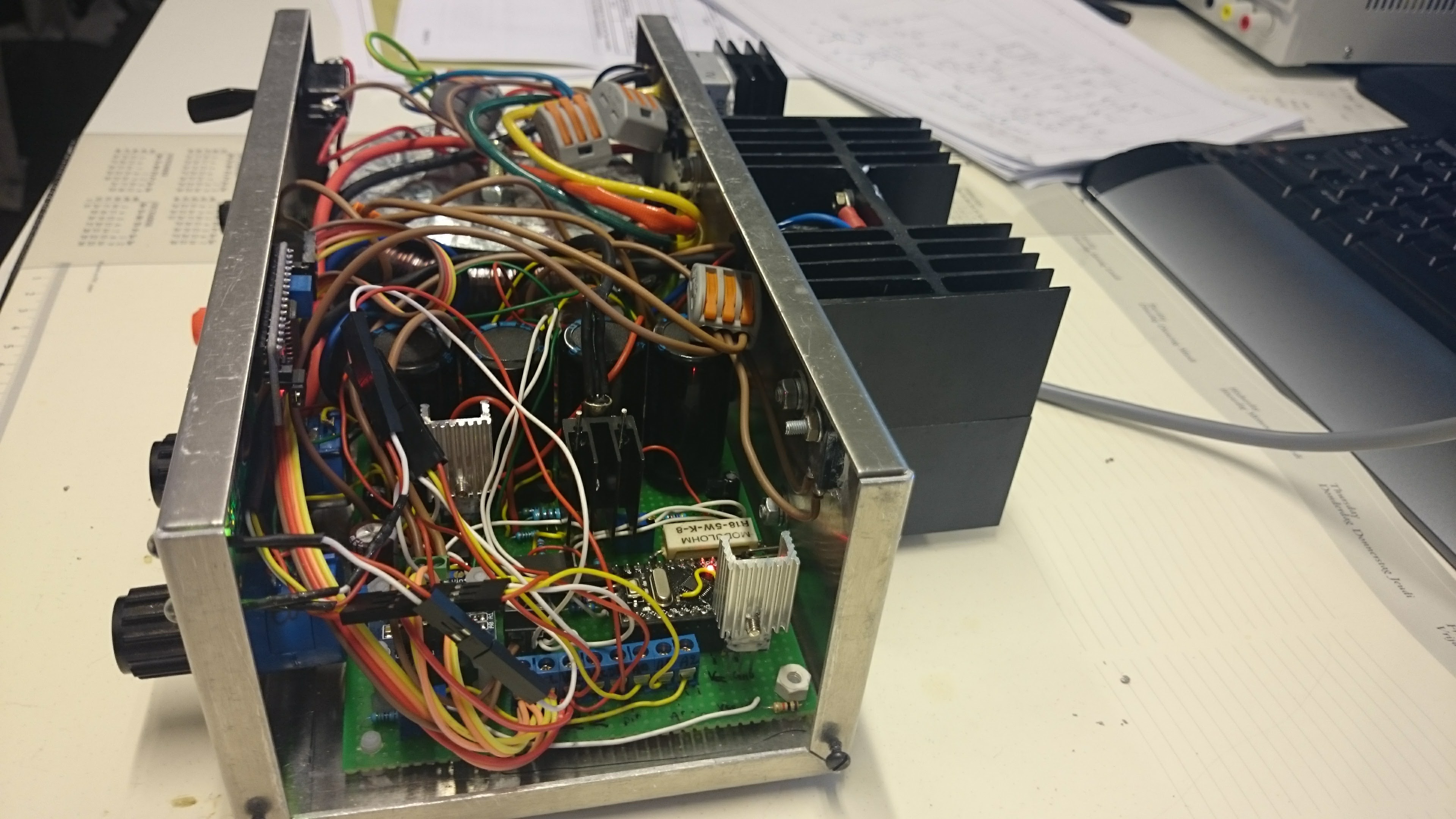

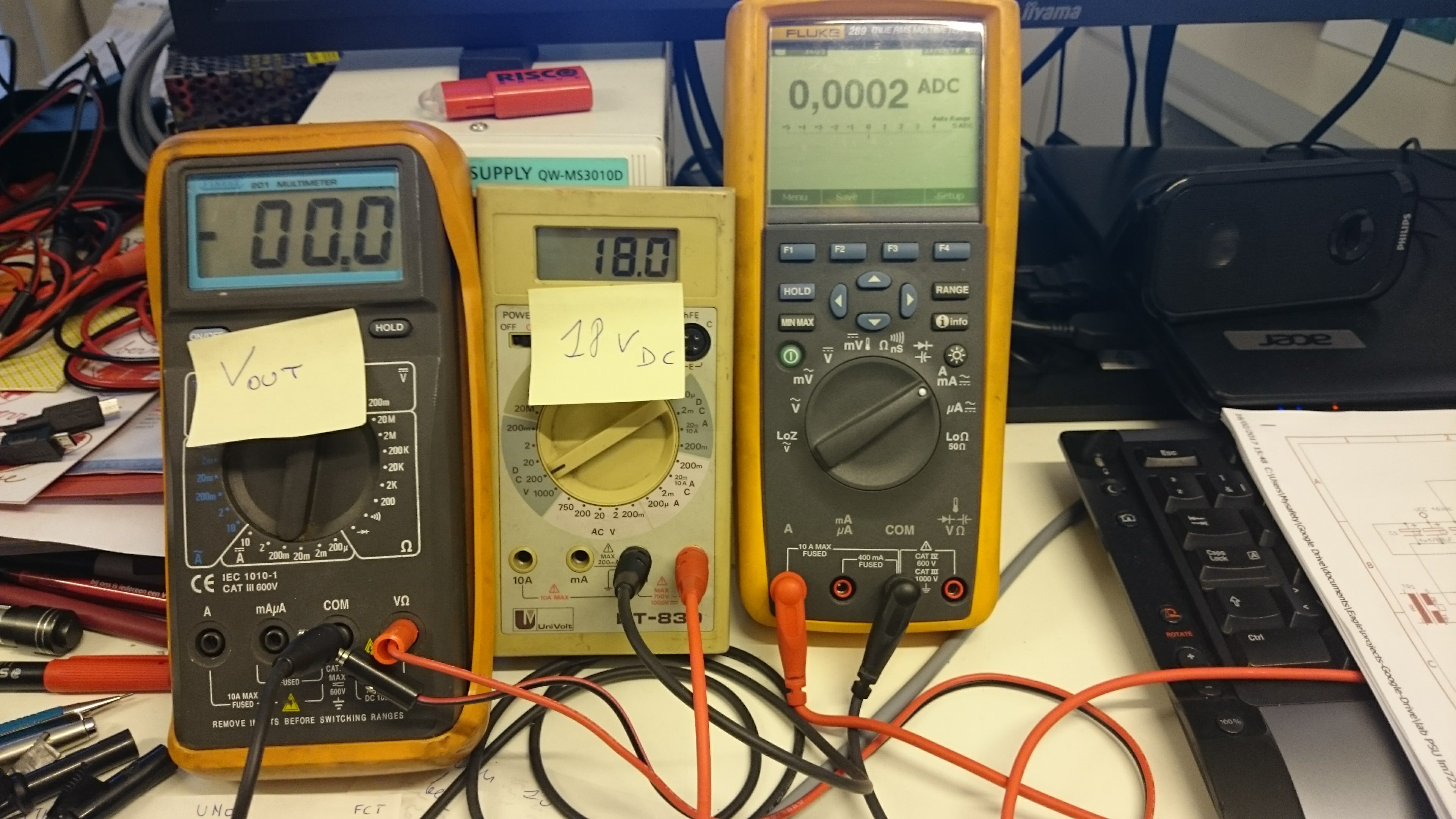

Last October I contacted this forum after having decided to reconstruct my functioning student-era LM723-based PSU. The most interesting part about this particular PSU was that it had a fairly ingenious (not invented by me :cool:) way to have a minimum voltage of 0,00V. For the rest it used adjustable current limiting up to 3A and max output of about 30V. The transformer was an oldfashioned rectangular iron core of about 90VA and two secondary 12V coils, at full current it's maximum voltage dropped.
New specs I set forward for a upgraded PSU:
0,00V minimum output
>40V max output
3A max current
I had recently bought a toroidal 150VA transformer (2x 15V 5A), all other parts had to be re-used.
On this forum I started a thread (https://www.electro-tech-online.com/threads/lm723-psu-with-0v-lowest-voltage.148899/) where, in order of appearance, I received help from Nigel Goodwin, spec, dr pepper, Les Jones and a few others. By far the most prolific contributor had been spec, to whom my warmest gratitudes, and of course to all others too.
Purpose was to re-use as much as possible from the original design ideas yet increase both current and voltage capabilities, as well as introduce a current limiting warning LED.
Another target was to introduce a microcontroller for display and warning purposes.

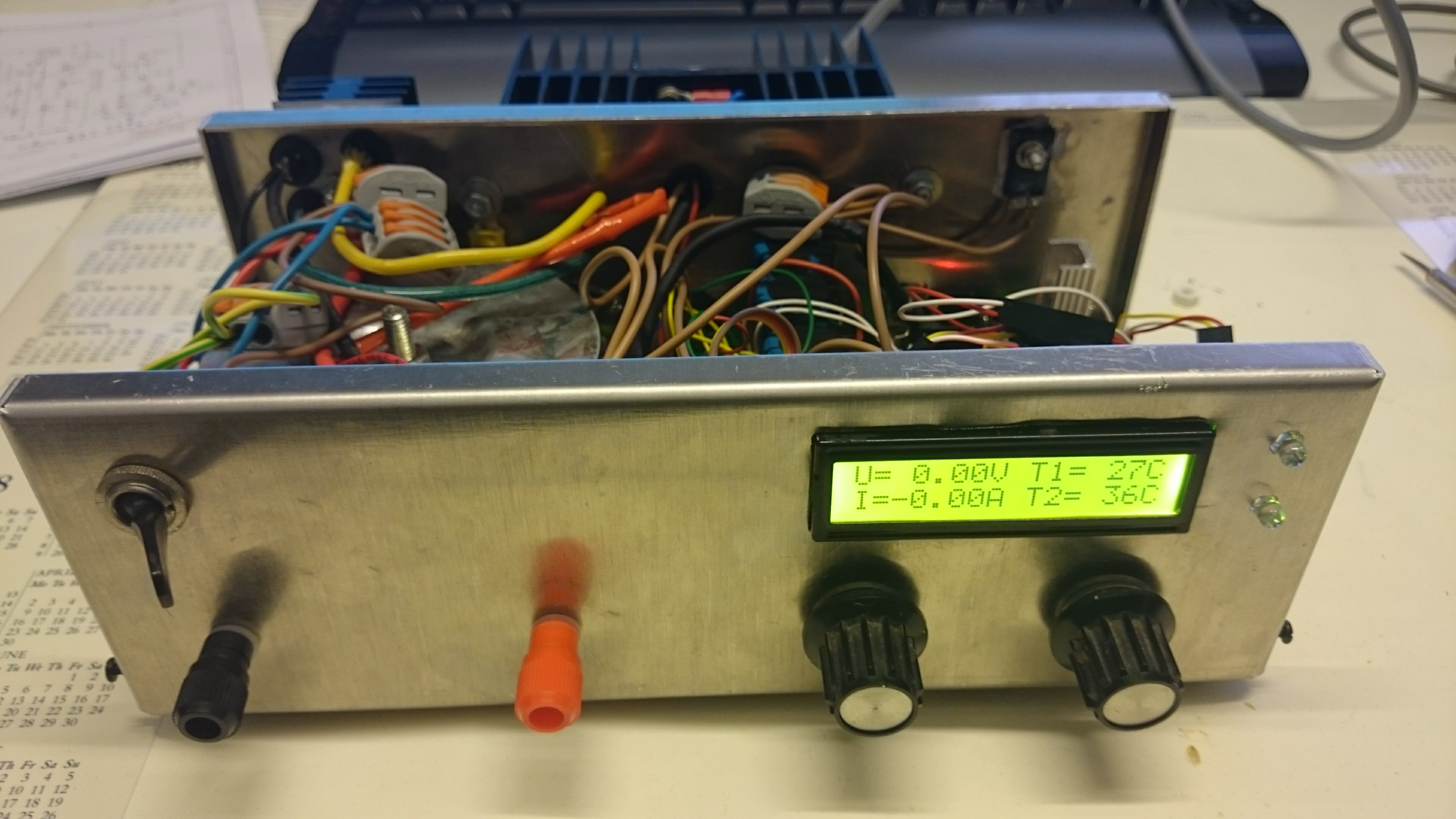

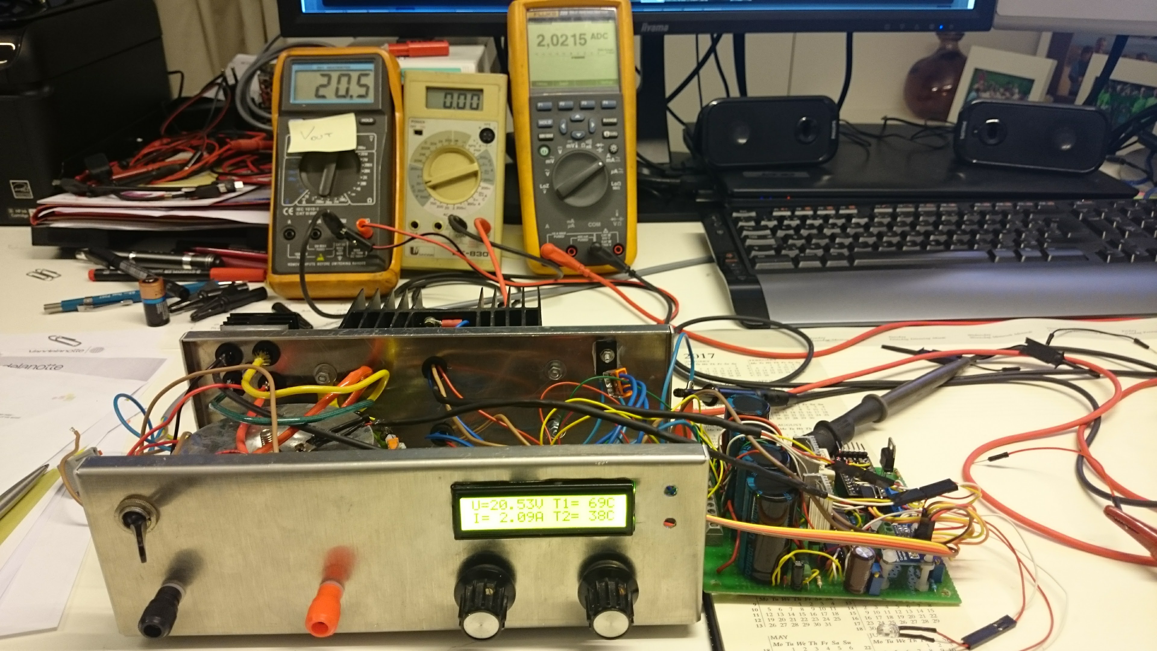

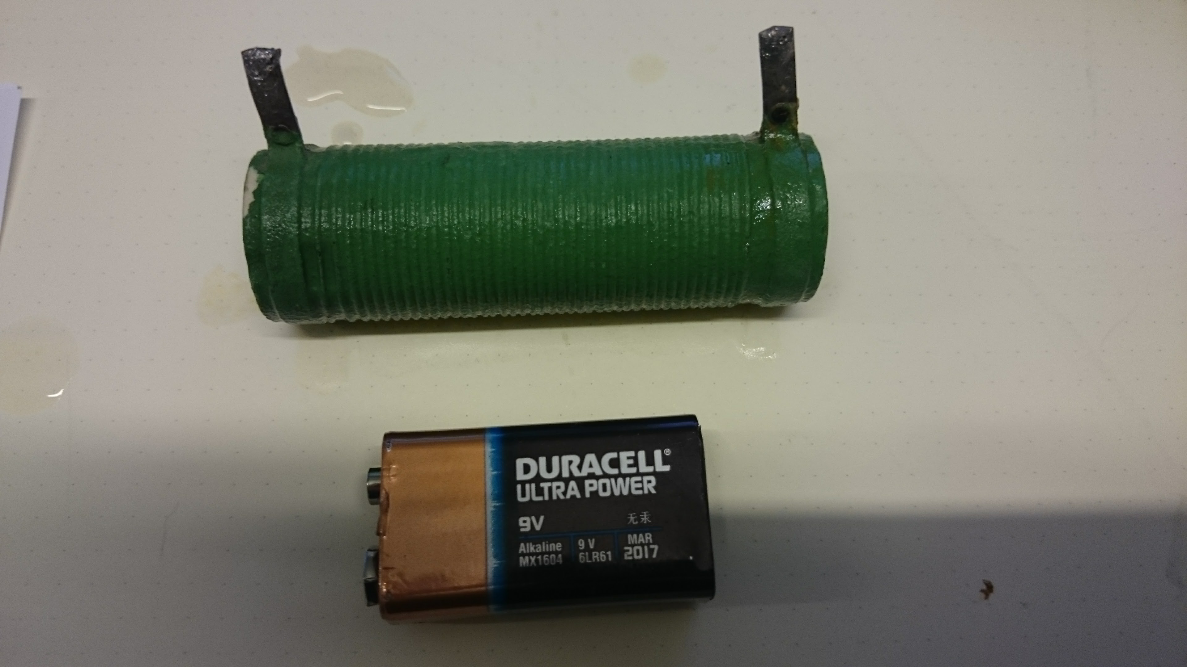

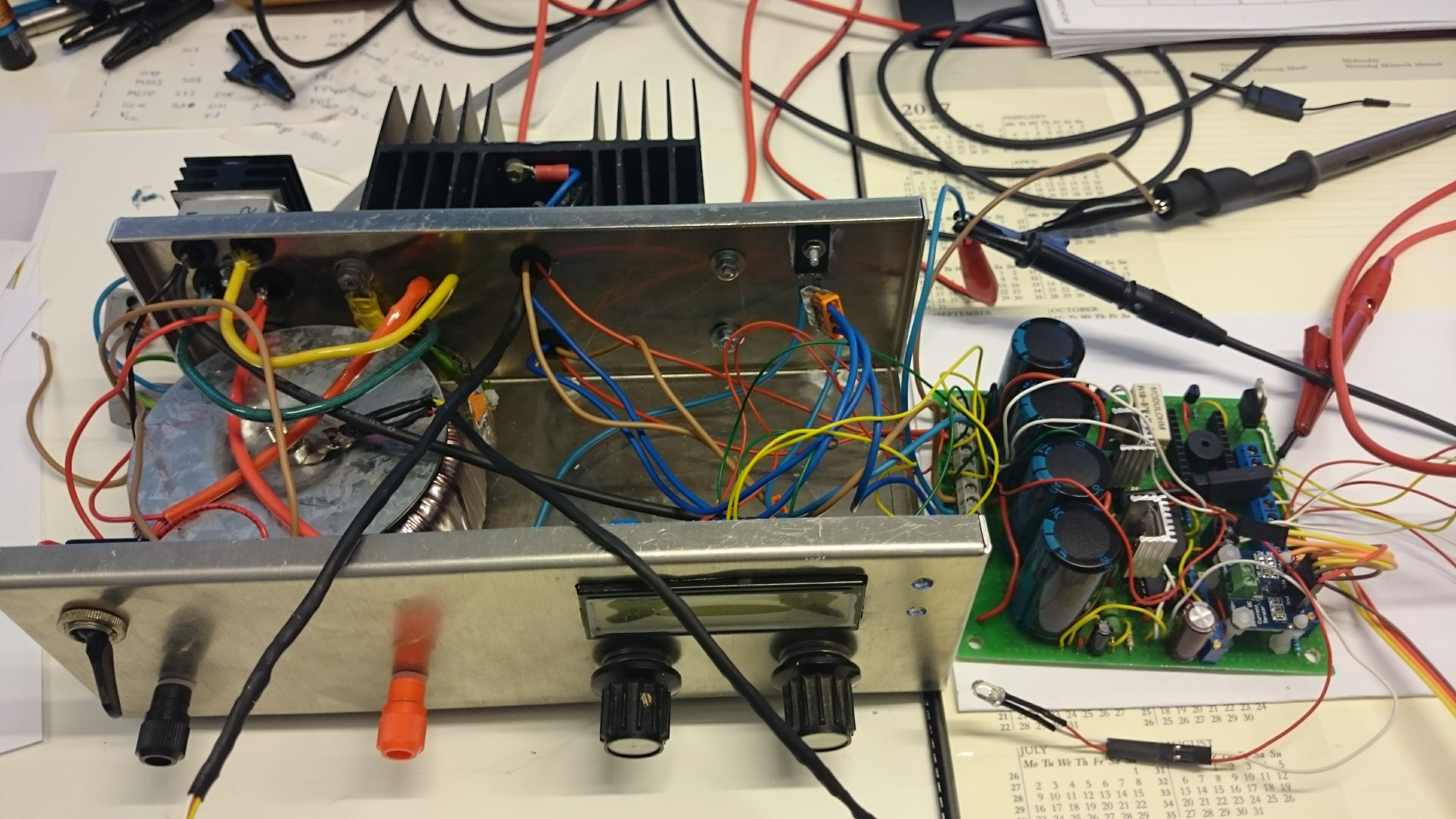

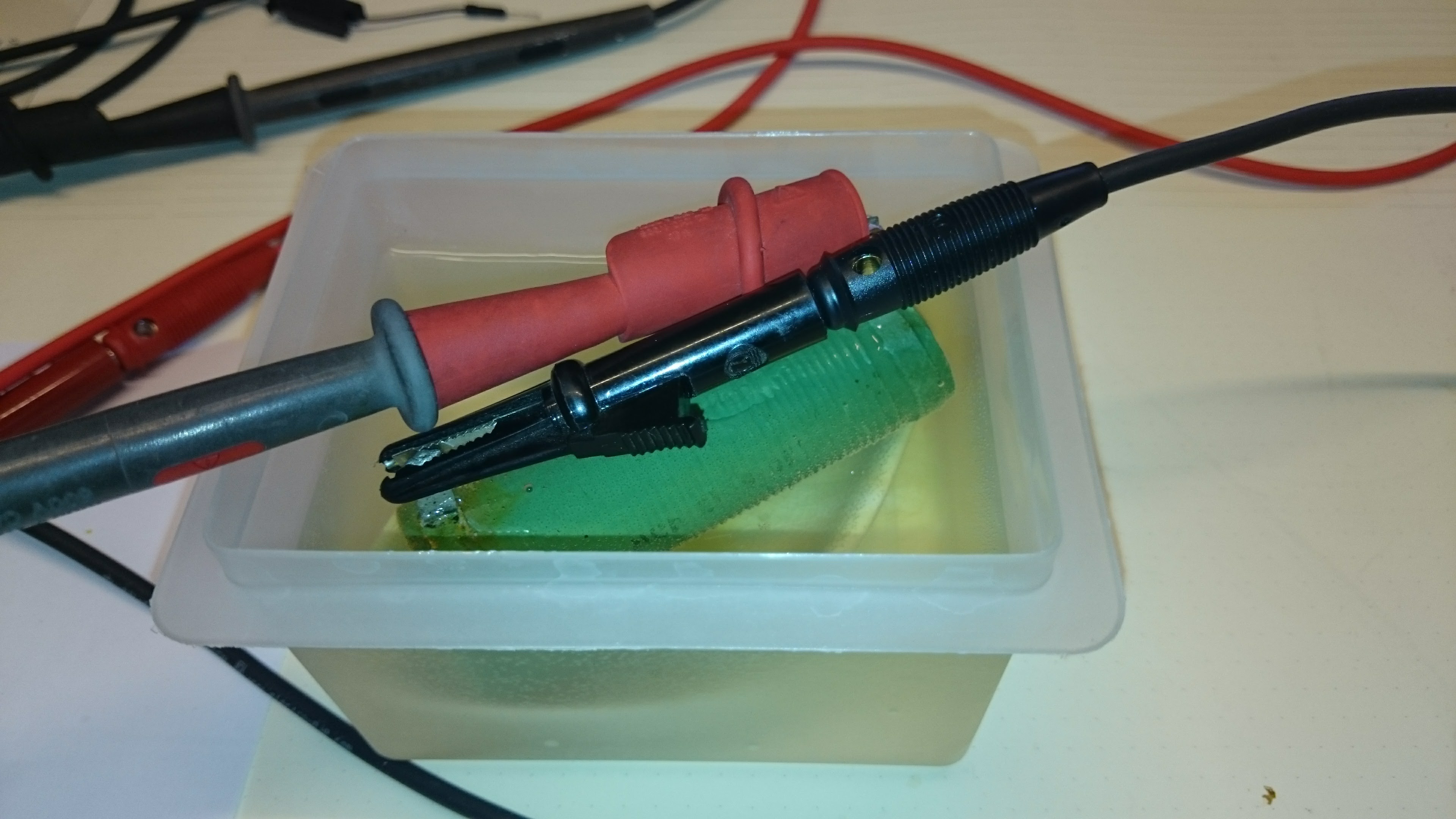

Today, after months of on and off time devoted to this project, I did final "burn-in" tests, you can see on the pictures what I used as a load (because of the dissipation of max +90W I used watercooling :D). Voltage stays perfectly stable, the transformer does not give a "crimp", current limiting goes perfect at work at 3.2A, and current limiting is adjustable too; no molten or burnt components during tests..

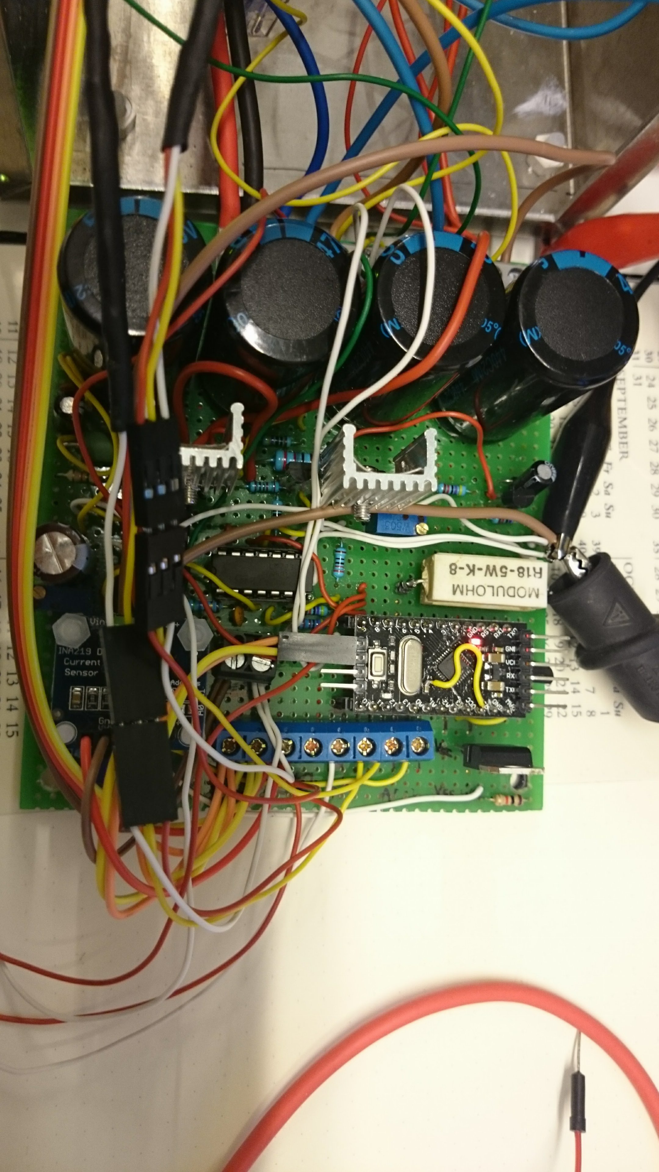

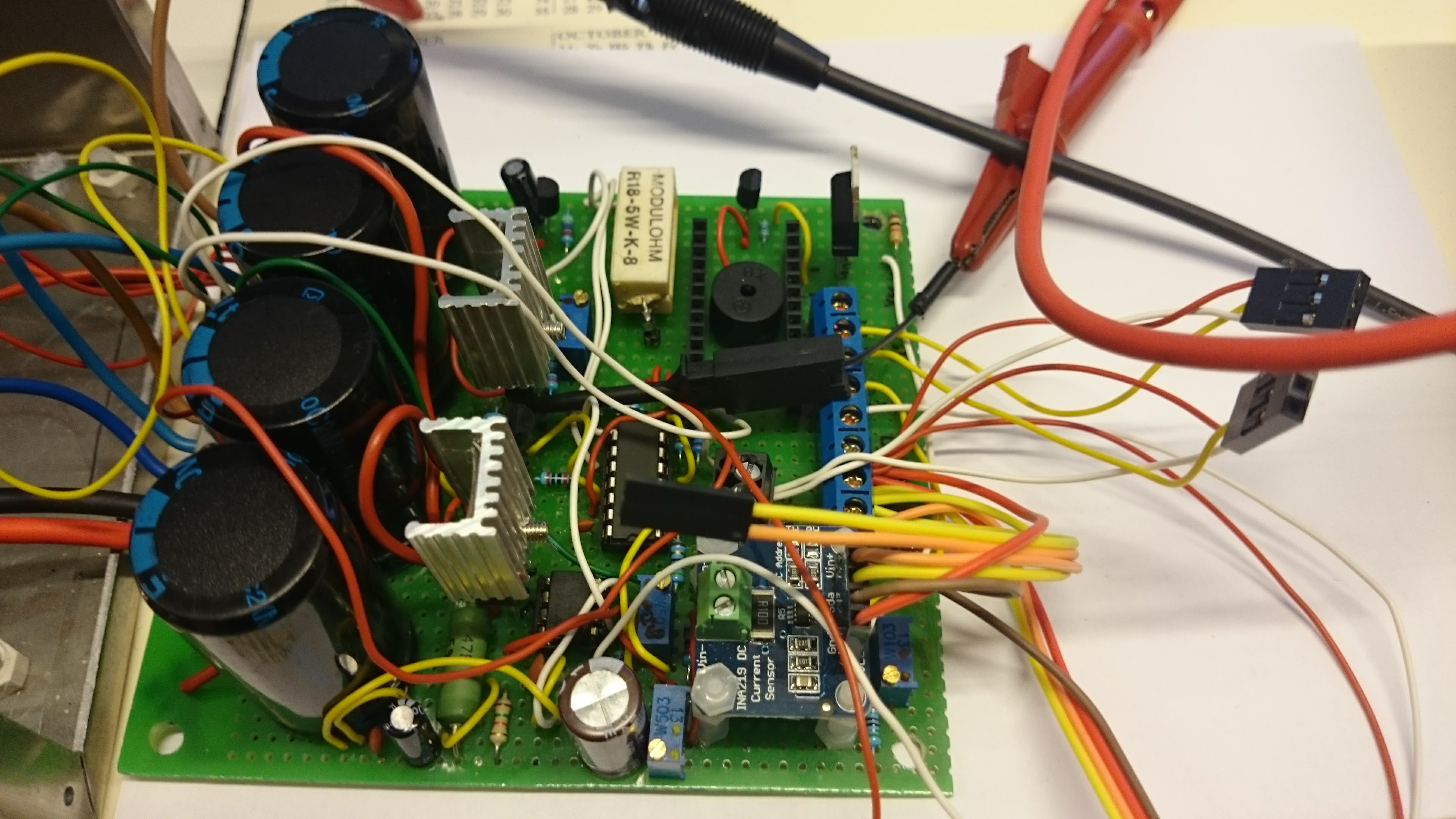

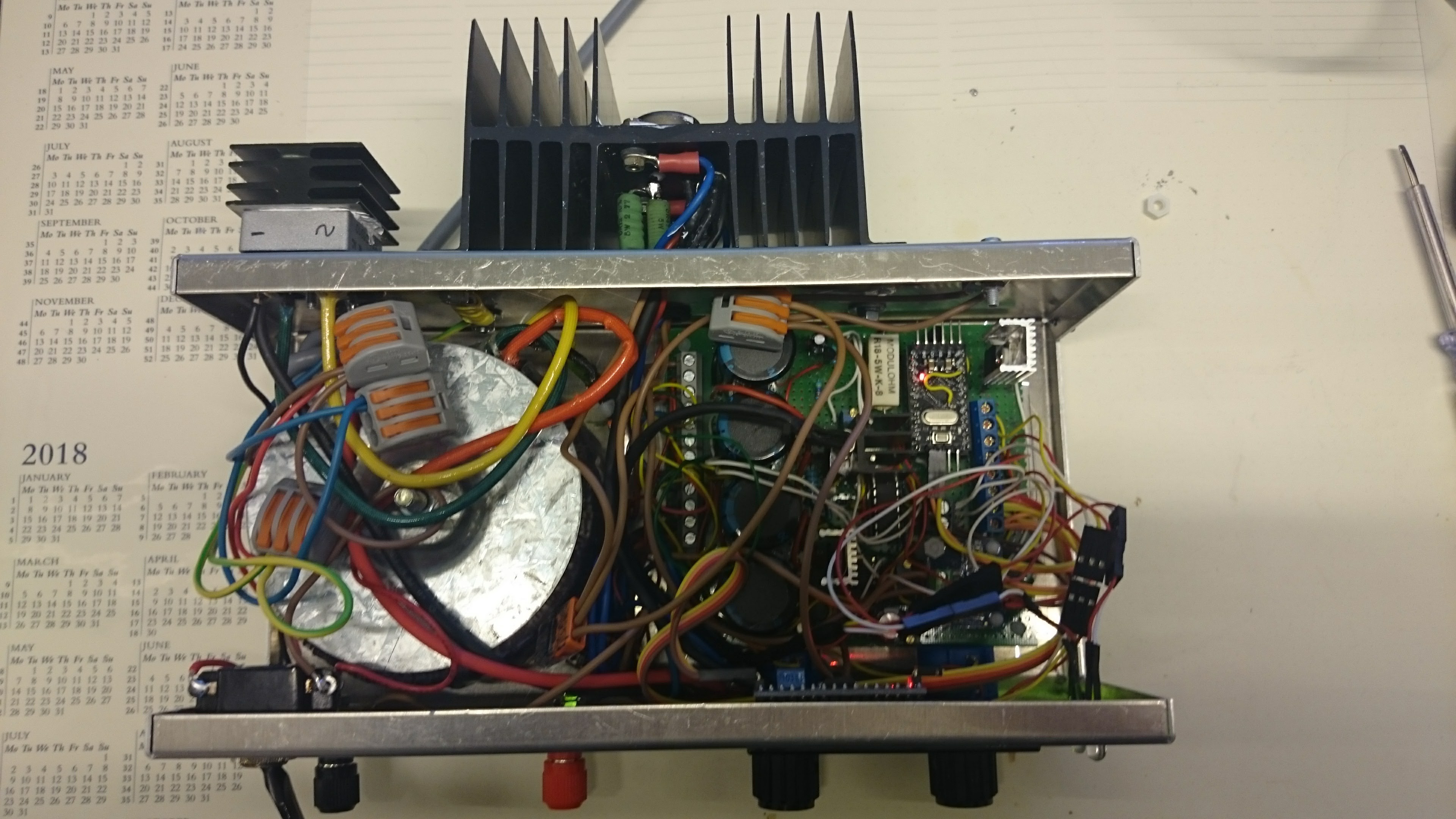

On the picture of the pcb (see below) to the right is a socket that is reserved for a Atmega168P controller: display of V and I (current measured with INA219 I2C module) and transformer and heatsink temperature sensors (LM35), as well as supervision of temperatures and generation of the necessary alarms. The controller (not yet installed at time of picturetaking) is meanwhile installed and all performs well, I just need to do voltage and temperature calibrations.

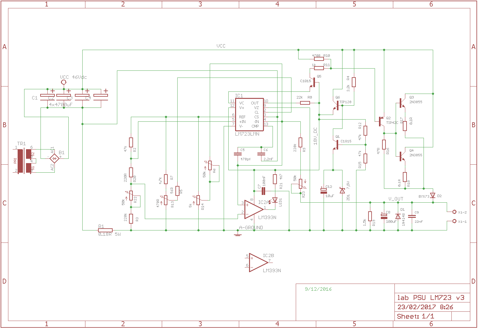

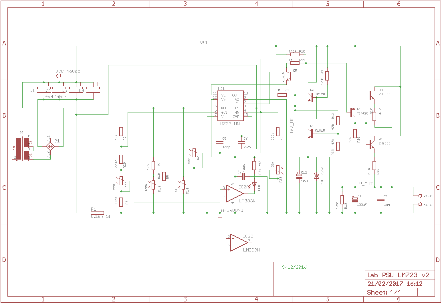

Included too is the final schematic drawing (thank you to spec who introduced me to CAD with Eagle).
C++ program files and microcontroller hardware layout available on demand. These are not included in this schematic for readability purposes.
Erik

Now running with controller installed (and calibrated): see pictures

Here is an upgrade to the schematic (thank you spec!!): added output protection diodes D1 and D2.

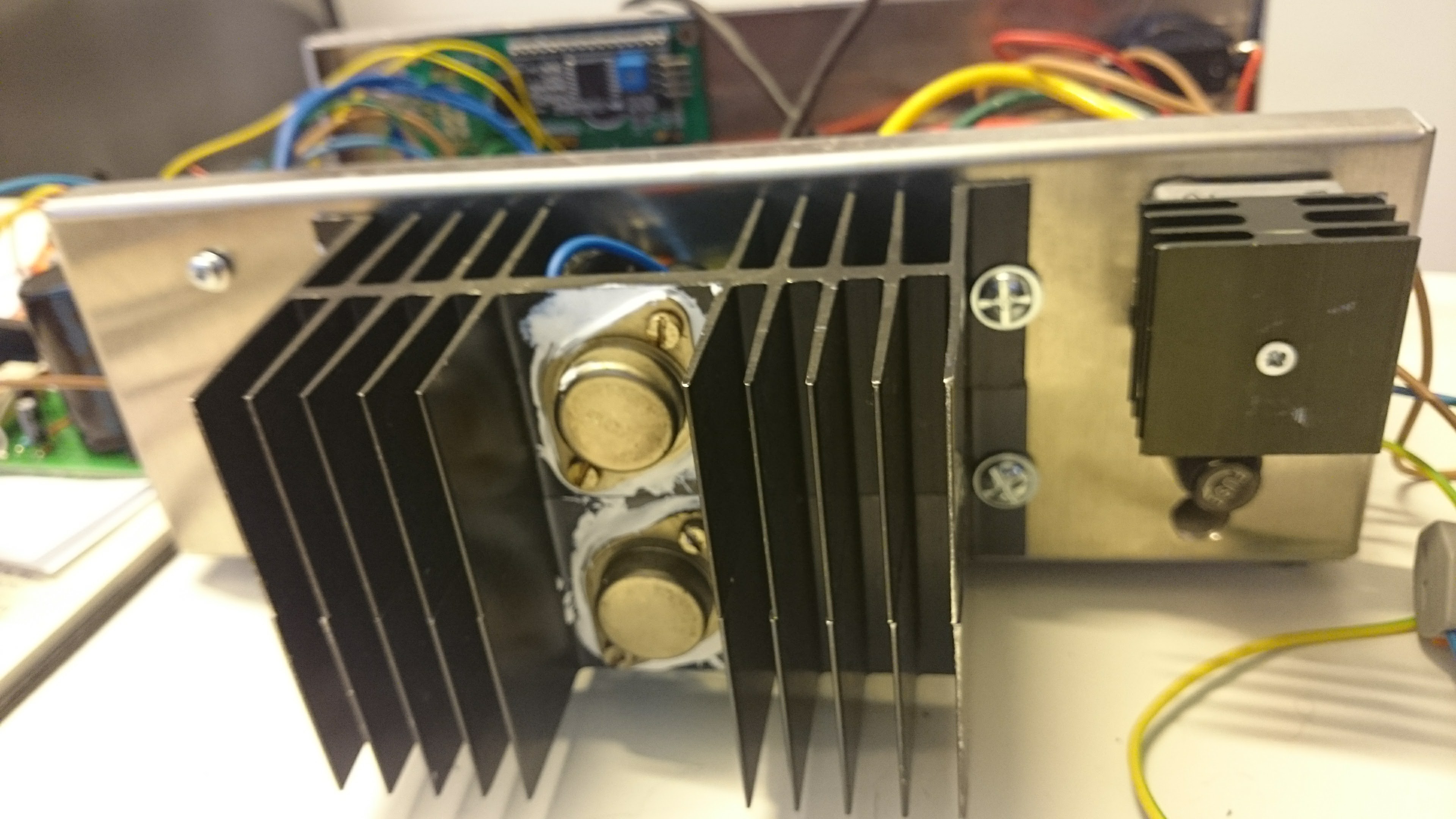

Also make sure the heatsink on Q6 is big enough, temperature can climb on that darlington (on the picture it is the one with the black heatsink inside the case now). Before the change it went to +95C, currently it stays at 62C without cover.
The LM393 is a current limit indicator, with thanks to spec!

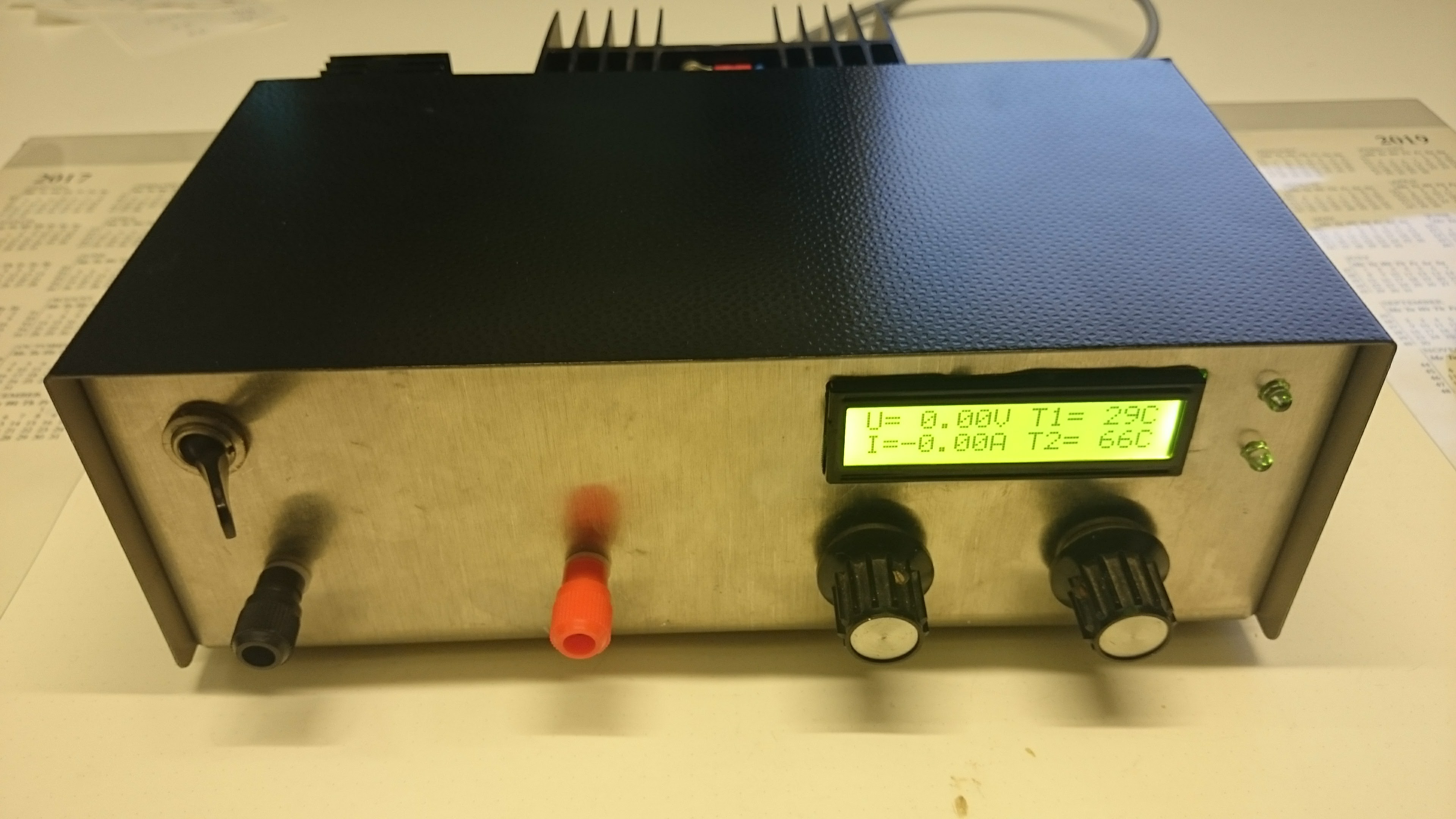

Cleaning up the wiring? I make sure they don't touch heatsinks but I leave the rest as is, it is already a major undertaking getting the pcb in and out without all wires strapped and bundled.

Looks ok.
Does the current limit led come on at the precise point of current limit?, I went a bit ott on my design, in the end I just put an led in series with the input to the current limit integrator which deliberately had a low i/p impedance so the led had to be on as current limit came in effect.
An alternative for D2 would be to put the diode anode to the + o/p terminal and cathode to the collectors of the o/p transistors (and put a link where the diode was) you'd still have some protection for the o/p devices, instead of opening the circuit to reverse voltages to the supply you'd charge up the resovoir caps to the backfed voltage, or in the case of a 'spike' short it into the caps, I've seen this on commercial stuff, but theres nowt wrong with how you have it, except maybe d1 might be better a uf4002 or something, if you had an inductive load pulling max current and you unclipped one of the leads you might frazzle a little '4148.
Looks ok.
Hi dr pepper,
the LM393 starts the LED low as soon as any current limit comes into play, and as soon as the full current limit works (voltage to zero) the LED is at full brightness. No lead or lag.
Looks ok.
Very usefull, thks!
However the reason for this instead of your proposal is because when I did the latter I could not get 0,00V at the output.

Hi Earcknes,
D1, 1N4148, cathode, should be connected to the junction R23/R29 rather than to the positive output line. The purpose of D1 is to protect the LM723 chip in the event of a reverse input voltage.
I have just realized that the electrolytic capacitor C8 is vulnerable to reverse voltage, so it would be better changed to a ceramic type- another three 22uF ceramic capacitors in parallel with the present 22uF ceramic capacitor (C9) should be adequate.
spec
Just to explain the operation of the LM393 comparator, which fully illuminates a LED when the constant current mode is entered.
A stabilized power supply has two feedback loops.
(1) voltage stabilization loop (normal)
(2) current limit loop.
In the voltage stabilization mode, the the constant current negative feedback loop is inoperative because it has not reached a threshold.
In the current limit mode the current limit negative feedback loop overrides the voltage feedback loop so the inputs to the difference amplifier in the LM723 are at different voltages.
The LM393 simply detects that difference.
spec
About zero volts.
It is the holy grail in lab power supplies to be able to adjust the output voltage down to 0V.
The current limit at 0V is the same as any other output voltage.
spec
Hi Earcknes,
spec
Hi spec, I can't find R29 even though I just had a Uigeadail (you know, the one from the north of you ;)).
And C9 is 22nF. Three in parallel still make only 66nF :D
Edit: you mean "diode in series with R23, cathode towards R19"?
