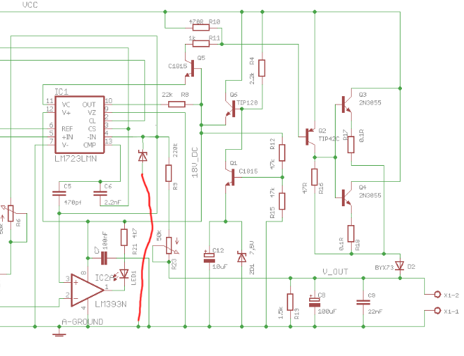

Cathode to pin 4- yes
Anode to the power supply negative output (another error by me). All other connections of the circuit in post #7 remain as shown.
The idea is that when the power supply is operating normally, the diode is reverse biased, so has no effect.

Hi spec, sorry I do not understand how this would protect the 723? If a reverse voltage is applied it goes straight through the diode to pin 4?

The diode is in series with a resistor (or two depending where the voltage output photometer is set) so the maximum negative voltage that the LM723 would see would be the forward drop of the diode. It would really be better to fit a small-signal Schottky diode, like a BAT43, which has a forward voltage of around 0.25V at the low current involved. But a 1N4148 will be adequate in practice.

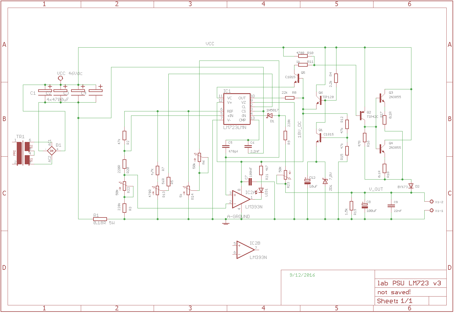

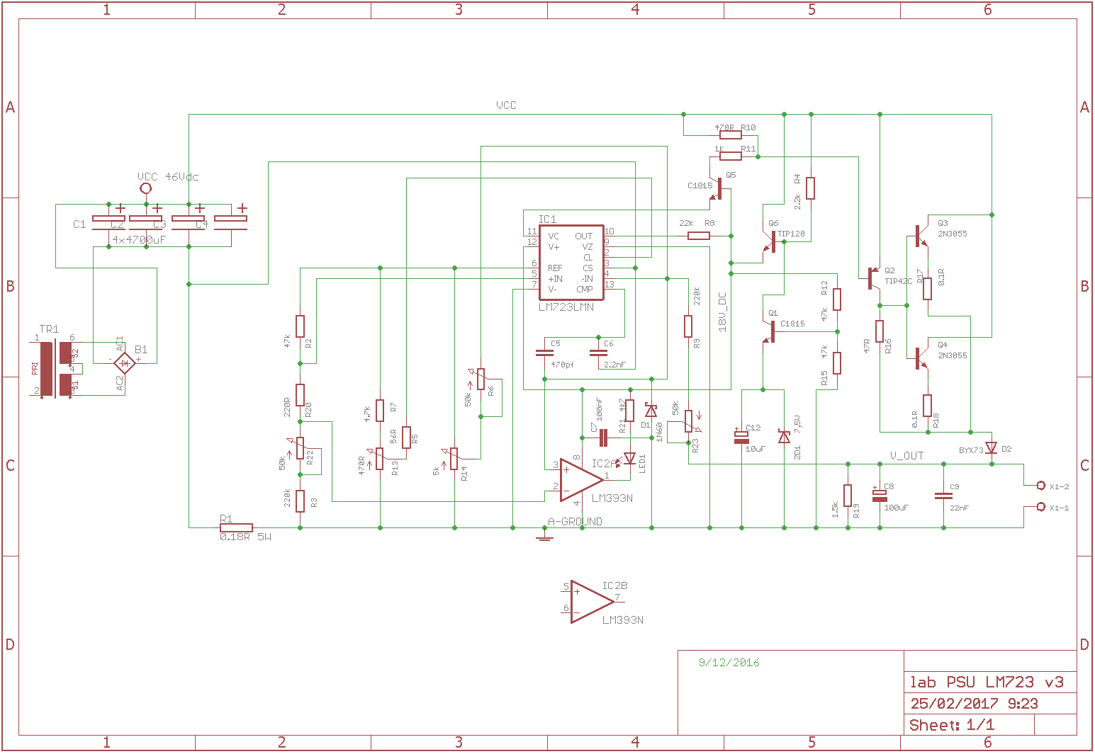

spec, below modified schematic: is the diode correctly placed? I use a 1N5817 because on hand (Vf=0.6V If=1A) but I might buy 1N60 (Vf=0.3, If=0.05A): acceptable?

Hi Earckens,
sorry to say, diode not in right position.
Goes to show how difficult it is to describe circuit modifications- I will post a sketch showing the correct position.:)
It is very important that the diode you use has a very low reverse leakage, or the power supply voltage stabilization will be compromised.
When the LM723 protection diode is fitted it will have no effect on the power supply at all. The diode would only conduct if a reverse voltage were applied to the power supply input.

Then I would opt for the 1N60: less then 0.1uA leakage **broken link removed**
0.1uA is quite high. That corresponds to an error of around 5mV at the LM723 difference amplifier inputs. I would go for a 1N4148, which has a maximum leakage current of 0.025uA.
