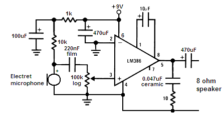

Hello Everyone,
I had a few doubts on an mini amplifier project I have going.
I'm new to electronics, I've been practicing soldering and I've been reaserching and learning about electrical engineering on the internet.
I came across a schematic (Click here) for a mini-amplifier project you could do.
I currently have most of my parts but right now, but I need the 100K Variable Resistor, the LM386 IC and the 0.1 uF capacitor. Where are these tipically found? I heard you can find the LM368 in answering machines and old modems. The only variable resistor I have right now isn't 100K, but 125K.
Also, what kinds of things ruin the sound quality on a project like this? I'm hoping to get good sound quality. What should I expect?
This is the first electrical project I've done, and I'm hoping to learn alot, so any advice would be apprciated.
Thanks Everyone,
-TheNewGuy
The circuits are missing one imporatnt resistor and two important capacitors that are shown on the datasheet of the LM386.
You do not want to have the electret mic anywhere near the speaker to avoid acoustical feedback howling.
A corrected circuit is here:

I forgot to mention, for both the imput and output I plan to put auxilary jacks. So you can connect your ipod to the imput, and your headphones to the output.
Would this work?

The OP of the 386 will certainly drive headphones but the volume might be too high. You may need to "divide down" the input signal some so your volume control is from no sound to loud sound, and not from no sound to blown eardrums. If the gain is set up for a microphone, the IPOD output is probably a little too high.

would it matter if I repaced the mic with an aux Jack like I said? (and the same with the speaker?)
If you replace the low level mic with a high level AUX input then the gain of the LM386 must be set to only 20 and a volume control must be used to reduce the input level. The resistor that powers the electret mic must be removed. a resistor attenuator must be used to feed headphones so that a loud signal does not deafen you.

Ok, so the schematic you posted earlier should work right?
What is a resistor attenuator?
What is the part that says "220 nF film"? Is it a capacitor? I haven't seen anything measured in "nF" yet, just "uF". Is this component vital?

"FILM" is a type of capacitor. It is most commonly polyester film or polypropolene film. These type of caps have very low series resistance and inductance which makes them ideal for high frequency applications.
They are overkill for audio. Ceramics would work fine and are a lot cheaper and smaller.
Ceramic capacitors are terrible for coupling audio. they cause distortion and are microphonic. Film capacitors cost pennies and are perfect.
