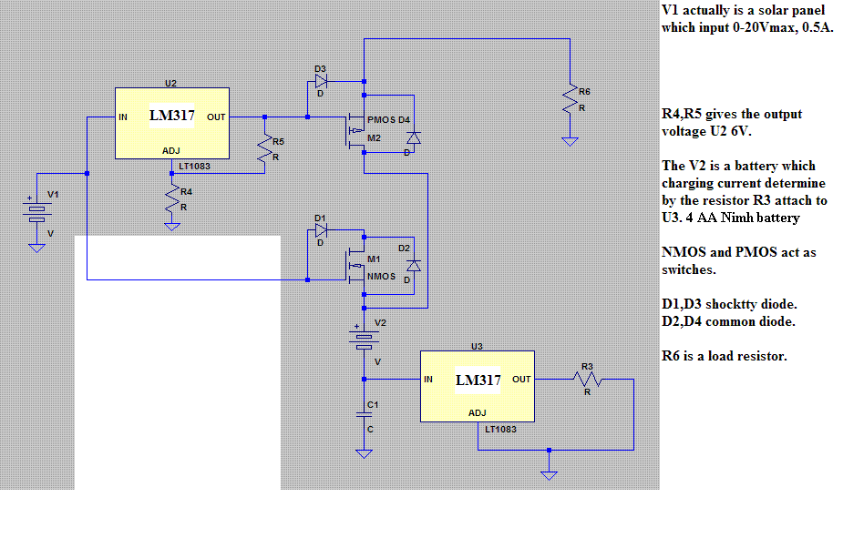

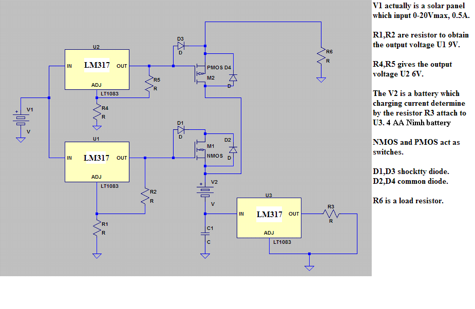

i have using the LM317ic and not very sure the circuit design can run properly o not.
Here below is my circuit. The battery is design to overnight charge.
any1 can gives me suggestion and comment to my circuit whether is wrong o needed to improve.
Thx alot.

Hummm...
that's not going to work.
what are the fets doing anyway? i see no way to turn then on or off, since the gate of both are being turned on by the output of the two regulators. And while i did not look up the specs for the fets you're using, the 6 volt output is not enough to turn on the fet anyway (unless it's a logic level fet)
and the negative side of your battery pack is connected to the input of the third regulator. It's not going to be happy with a neg input voltage.
and what's the load resistor for?

The actual MOSFET spec i haven't decide yet, but the only things is Vg(M1)-Vs(M1)<=0V will turn off while the Vg(M2)-Vs(M2)>0V will turn on. The Vin is changing in between 0-20V. The output voltage regulator will be starting to drop when the Vin-Vout(U2)<3V (actually i have measured about around 2.3V below the Vout(U2) it starting to drop).
When the U2 turn off the output load (load resistor) will be directly supply by Vout(U2) through forward bias schottky diode of D3.
And about the negative side of battery pack, I had found out there will be current flow from Vout(U3) to Vin(U3) after u mention, thx. Any solution or method to prevent this occur?

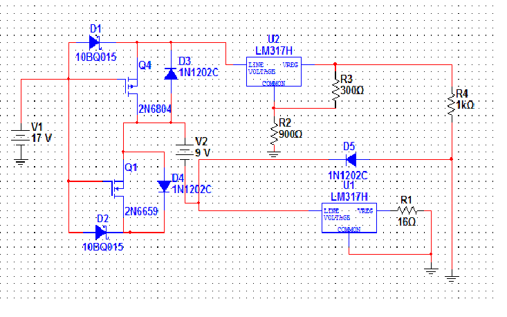

Below circuit was modified again, isn't any overall improvement can be add?
(The spec i haven't go through yet, so can be ignore 1st)
Thx again ur reply

why do you want to complicate such a simple process?
your battery will NOT charge when the negative side is connected to the + side of a regulator.
the regulator you have with the negative side connected to the regulator + input simply won't work!!!!
THere no way you can turn the fets on or off.
"Vinput starting drop below to voltage battery"
the only thing I see here is you're going to cook the fet as you have it in an not linear region instead of either fully off or fully on.
you need a clean sheet of paper.
Get rid of the fets unless you have some logic to turn them off and on as the battery requires. Depending on solar panel voltage to switch fets is not going to work.
There's no need for a load resistor either.
have you actually sat down and built any of this?

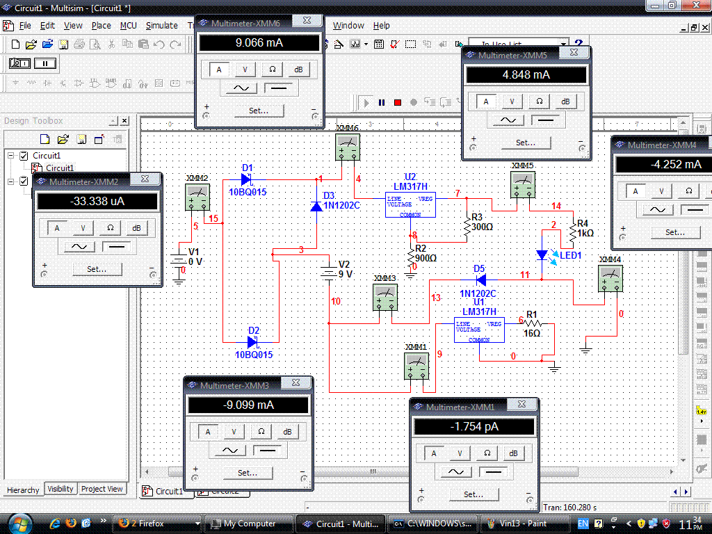

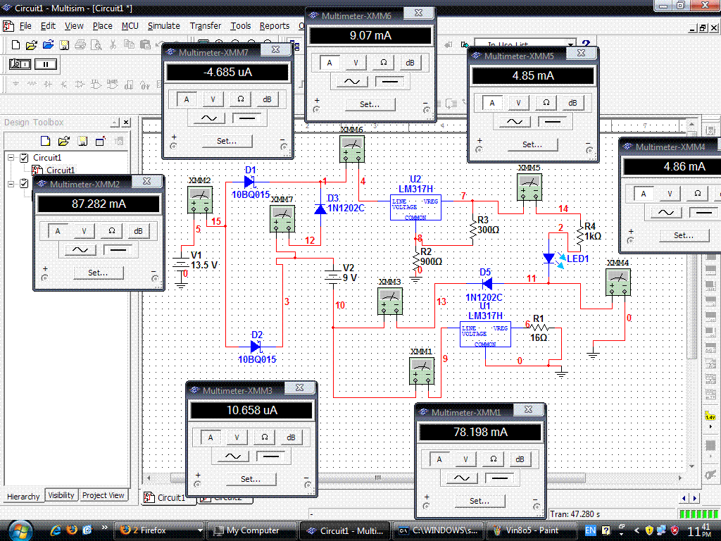

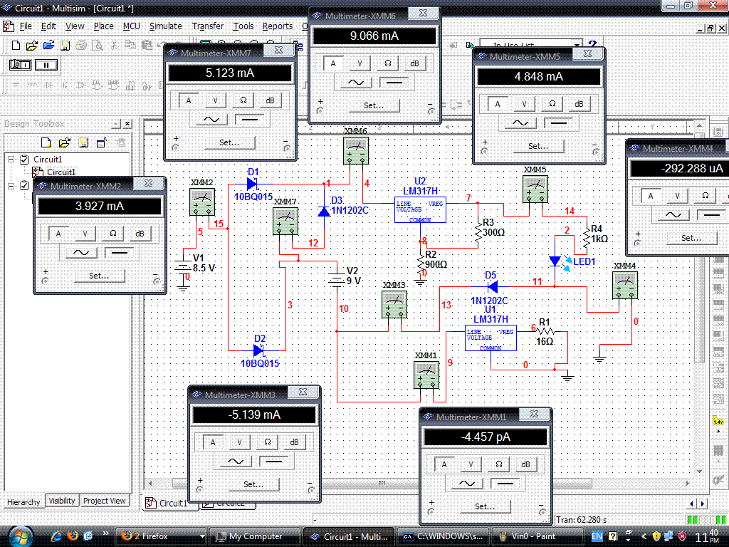

The -side of battery connected with U1 can be charging work by adjust the value of R1 to control the charging current which u want. Since the Vout(U1)-Vadj(U1)=1.25V at condition when Vin(U1)-Vout(U1)>3V. The path of current go in U1 will be equal to current go out U1. The Iadj(U1) is small and can be ignore.
i had build and test the circuit as below with input power supply and it can be work exactly almost same as the result of multisim.
Here below are the result of 3 condition the multisim show out.
The problem is the 0.5Amax solar panel tat i need to deal with, since it act as constant volt source.

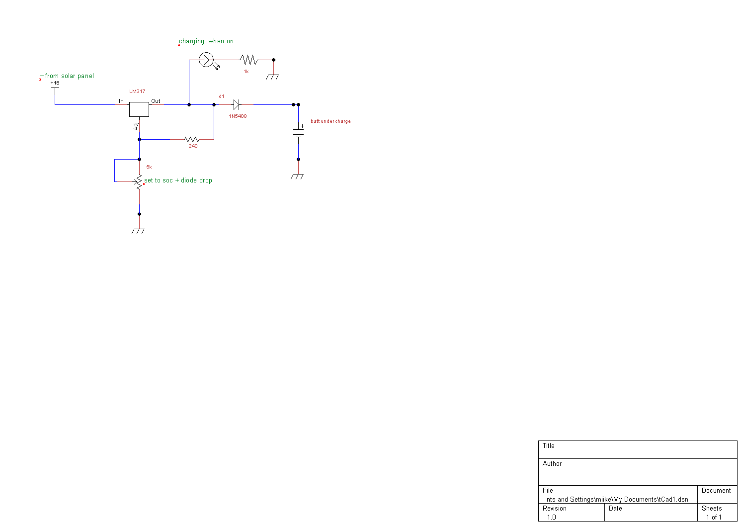

How's this for simple?
input from the solar panel is sent to the lm317. Its output is set to the final fully charged battery voltage with the pot. The diode between the battery and reg prevents the battery from discharging at night.
when the battery is fully charged, current flow is drop to a very low level.
if you panel has enough grunt, the led will light when the solar panel is producing power.
if the solar panel has more power than you need, or higher input voltage than your battery, you may need to heatsink the lm317.
the 1n5408 diode is over kill times three. a 1n4000 series will work too
it really simple, always works and is cheap and easy to build.

what i trying to design the circuit is something like behave as Uninterupt power supply. my output will drive to MCU to coordinate the 125 LED. when the solar power is low, the battery should be provide power to my LED. if the solar power is high enough thn should be direct provide to my output and also store the power(by charging battery).
the circuit I posted will do exactly what you want it to do.
run your loads from the battery
if the solar panel is producing power, then the power required by the loads will be powered by the panel. The battery floats.
when the panel is not producing, then the battery supplies the power. there's no switching, no diodes no nothing.
this is known in the ups field as a floating power system. Large cell phone towers and most communications systems use this exact method, only on a larger scale.

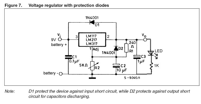

Wrong.
The 240 ohm resistor is for the more expensive LM117. The LM317 uses a 120 ohm resistor then the value of the other resistor must be halved.
Well not according to this data sheet from national. as you can see the device shown as LM117, LM217 and the LM317.
National never made an LM217. Just the expensive LM117 that can use a 240 ohm resistor and the LM317 that needs a 120 ohm resistor.
ST Micro copied the LM117 and made the LM217. They "no speeky zee English" (I think they are Italian) so their datasheet is very confusing.
