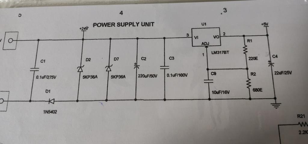

Hi, We have a voltage regulator circuit having 24 volts DC input and 5 volts ,0.5 Amperes output and facing failure of the 10mfd/16 volts chip capacitor attached to the adjustment pin of the LM317. Can anybody explain the root cause of this failure please. The circuit is attached.

I have looked at this already, but did not answer as I cannot see any practical reason for such a failure.
It has to be a guess, that either the cap was faulty or fitted backwards.
Please do not post in multiple categories as it just confuses things - and keep normal questions to the public forum, so other people can benefit from any solutions..
There's no polarity shown on the capacitor, and there should be, unless it's not an electrolytic.
  • Like
Reactions: DND
10uf/16v is usually an electrolytic. polarity? or are the chip caps tantalums, in which case OP should go with a voltage rating of 30 or 50V.
  • Like
Reactions: DND
BTW) You can get chip capacitors that cover that voltage and capacitance rating that are non polar.
EDIT:
There must be something else ... as mentioned perhaps it IS a capacitor with polarity and it is the wrong way.... That circuit should regulate to about 5.11 Volts with a slow rise when power is applied due to the cap in question. If you remove the cap all together the voltage will be at 5.11 Volts as soon as the input supply is provided. Otherwise there is only about 6mA of current the capacitor would ever see. Hardly enough to cause it to fail. Even if it were reversed. I think there may be something wrong with the PCB layout, because the schematic looks to be correct. I would also check the pinout of the regulator itself .... I have been burned in the past assuming it was always one way. Some manufacturers and package styles like to swap the pins around.
  • Like
Reactions: DND

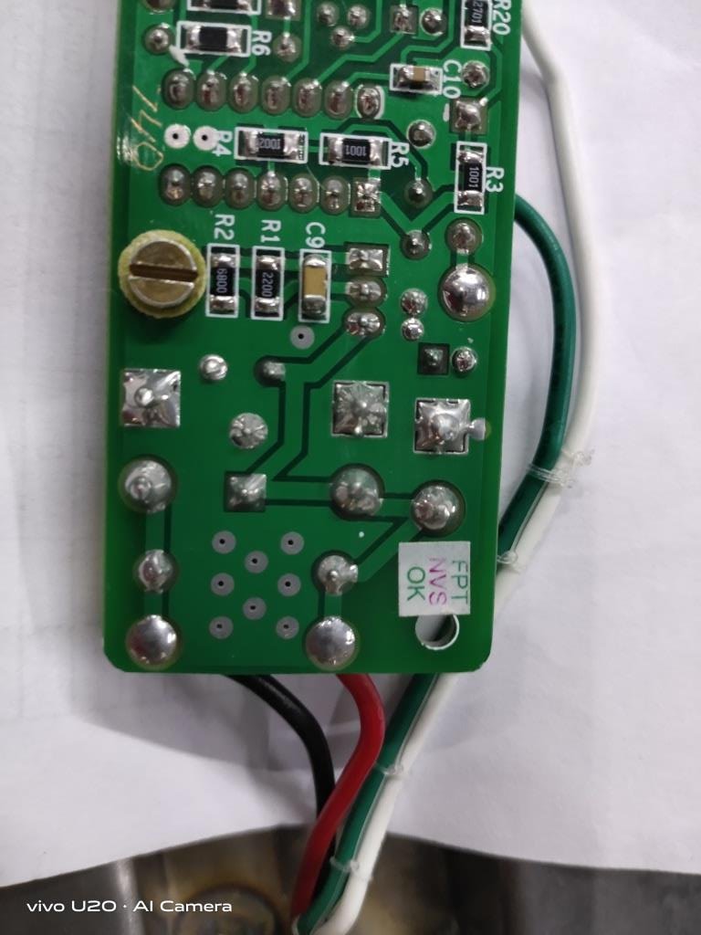

Thank you all for your replies. The capacitor used is automotive chip multi layer ceramic capacitor part number GCM31CR71C106KA49 of Murata make. We have produced around 450 numbers of the same circuit and out of that 14 numbers failed during internal testing and now 1 number failure reported from customer end. I have to do a defect investigation and was seeking your help. Any suggestions on this regard is welcome.

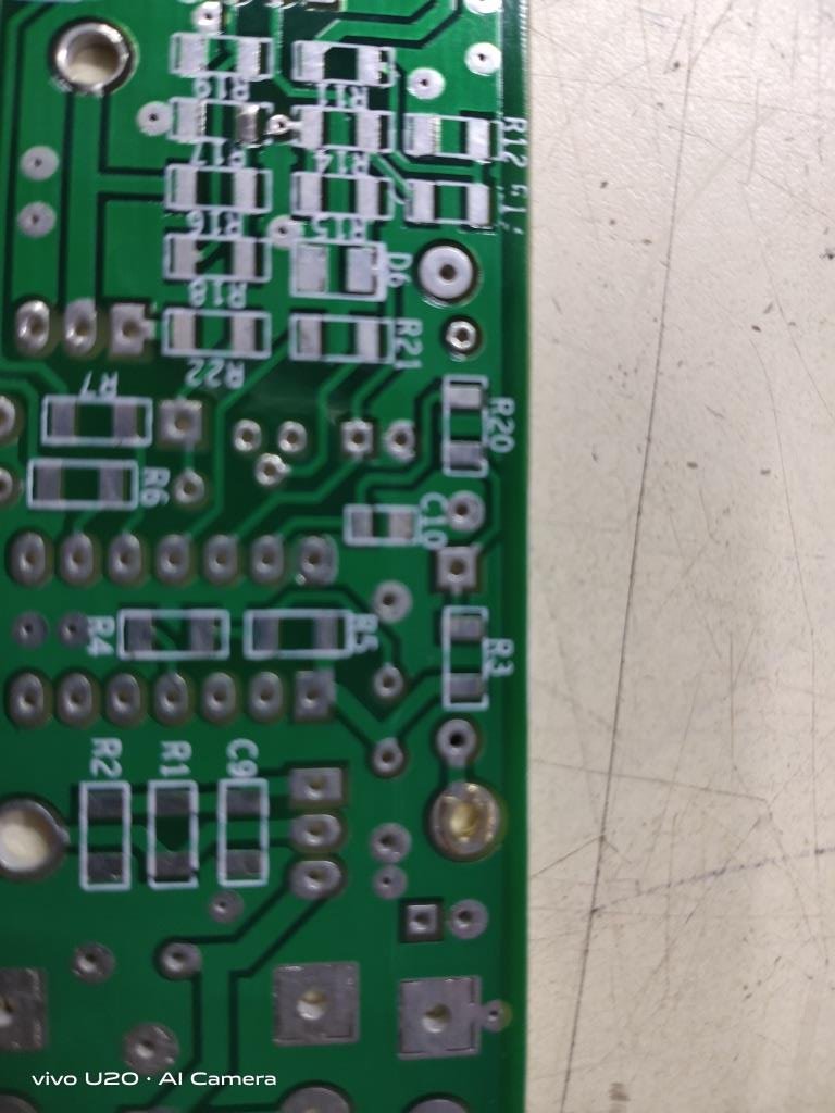

Can you provide a picture of the PCB with and/or without components populated? There could be a spot where a potential solder bridge could occur during manufacturing. i.e. if a via is too close to a solder pad ... I have seen this sort of thing before where the "same" board works without a problem, and then you have a batch that have all the same issue. Another question, have you changed board houses where you are having the PCB's made... even the same board house for that matter. If there is a potential for a "close" tolerance, then any kind of misalignment could cause some boards to fail while others are fine.
  • Like
Reactions: DND
Thank you for the reply. The bare PCB and populated PCB photos are attached. The capacitance reference is C9. We are getting the PCBs done from the same source in batches of 100 numbers. Soldering of components are done inhouse. The failure is not from the same batches of manufacturing.

Could it be mechanical stress, if they are being hand soldered to a cold PCB?
The cap will be expanding from soldering heat but without the PCB also being at a similar temperature, there would be more differential expansion and contraction. As it cools it will shrink slightly and try to pull itself apart.
Just a theory...
  • Like
Reactions: DND

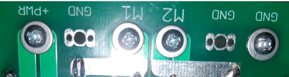

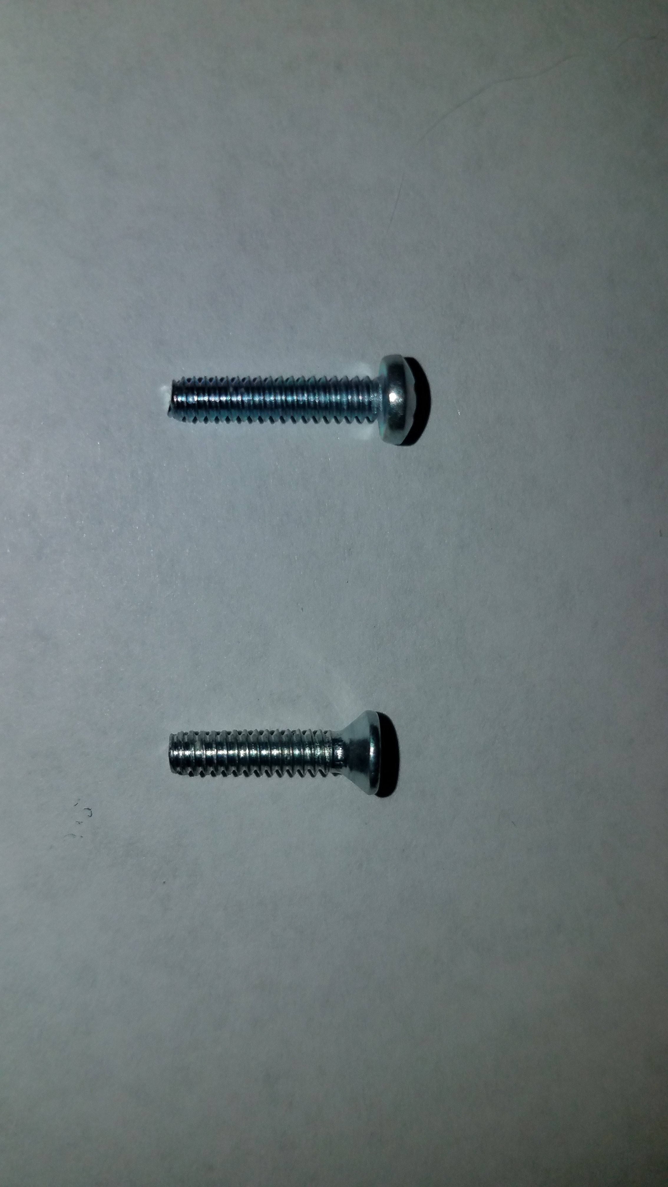

I do this sort of thing all the time and thermal effects from hand soldering shouldn't be a problem unless you are just spending a ridiculously long time soldering the components and I don't see any evidence of scorching on the populated board. Not that it is a problem, but things I would look out for are the vias near R15/D6 and R19 for possible unwanted solder bridging. I'm concerned about the screw terminal near R2 I assume this is your 5V output? Is there a possibility that screw could be over tightened and crush the PCB? That screw looks like it has a beveled head (great for crushing under tension), a better option might be one with a flat head. In the images below the screw head to watch out for is the beveled one on the bottom. The other image just shows them in my application.
