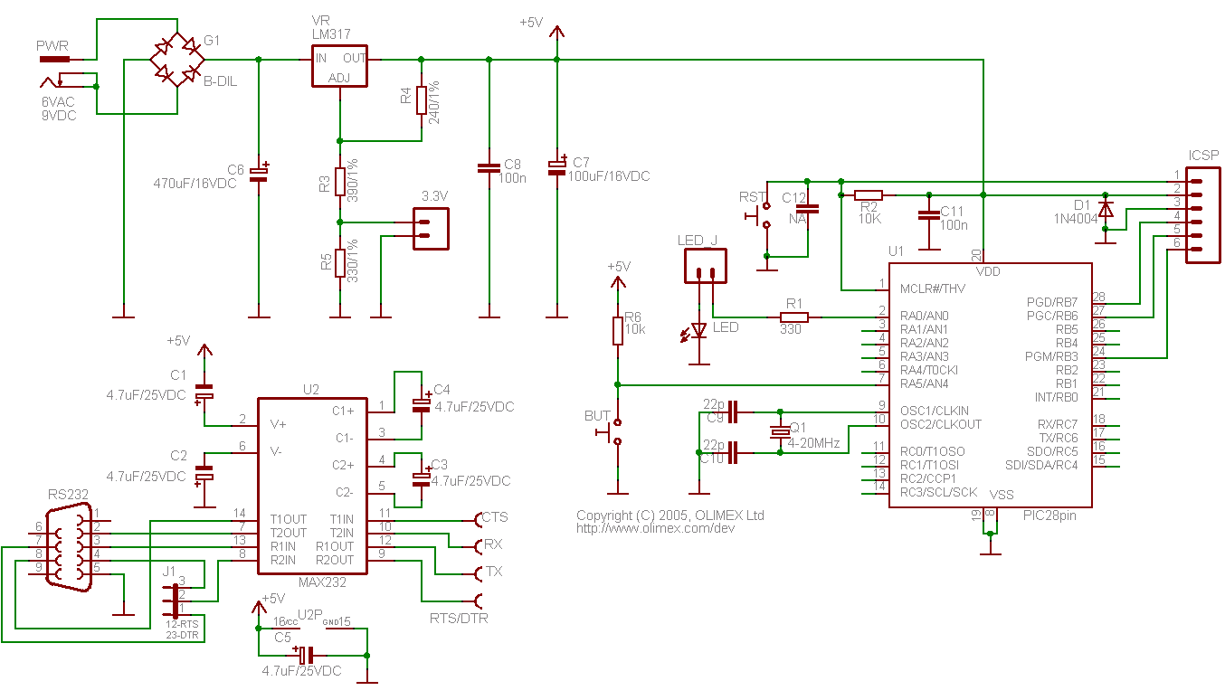

I saw this PIC development board, which has the feature of getting two outputs from the LM317. Interesting, I though. But in the LM317 datasheet the adjustment pin current is a maximum of 100uA, which wouldn't be enough to power anything. So is this design legitimate? I suppose the 3.3V output could be taking current from the actual 5V output? But wouldn't any change in current draw from the 3.3V output change the voltage drop across R4? Also, unless my math is wrong, the voltage at the adjustment pin has to be 7.2V in order for the R5/(R3+R5) voltage divider to output 3.3V.
It is certainly odd.
Using the resistors R3 R4 and R5 with the values shown, gives a nice 5.0v on the outout of the LM317.
But the so called 3.3v point according to my calcs has about 1.72v.
My first thought is that the 3.3v connection is a really bad idea.
My second thought is that who ever drew the schematic was having a bad day and his brain was away with the fairies.
My third though is that it is a deliberate trap to catch out plagiarists, and the real equipment was not actually built like that.
It's not a second supply output - it's for setting the regulator to 3.3V instead of 5V - by shorting out the bottom resistor.
Far too obvious, and easy when you know!

I did a search of the Olimex website and found the development board in question.
There I found an isolated copy of the schematic, and a reasonably comprehensive user manual which incorporates a copy of the schematic.
In the user manual, the 5v/3.3v jumper is quite adequately explained. Good documentation Olimex.
So, what lesson can we learn from this...
just RTFM!
