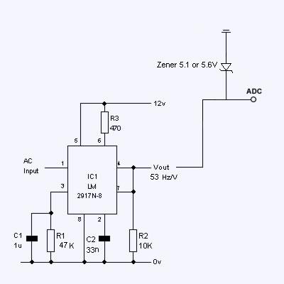

lm2917 frequency voltage converter, non linear output?
Lets do this design... for your case.... lets assume Fmax = 300Hz based on (4000 RPM * 4 (four cut flywheel?))/60sec = 264 Rounded up to 300.
Your Vcc is your supply! Not the internal zener regulated voltage. Remember the collector emitter of your output transistor is driven by the supply.

Thankjs bud your help is appreciated.
Can't do much today as I'm running low on components, but i'l try the values you suggested, and i've also placed an order for tonnes of shielding so i'l go over everything again with that.
Also trying to get hold of a scope so we can rule out noise.
Finally - i know we don't know much about the specific sensor, but is it possible to detect the ac directly with an analogue pin (perhaps through a diode)?
Just wondering if nothing seems to work, if that'd be a 'worst case scenario' solution - but i expect the ac voltage would be too low at low frequencies to be able to be picked up...

What's the zener for?
Dakta, you may be picking up noise from your transducer due to flywheel surface irregularities, the radiator fan (it probably isn't running when you start the engine, though), or some other source. I would try a lowpass filter at the input to the LM2917. I was going to say that you could use a cutoff frequency of 500 Hz, but that assumes a 50% duty cycle signal. With pulse outputs from the sensor, a higher cutoff frequency is probably in order, like 10kHz, or possibly even higher. You could try a 10k resistor in series with the input pin, and a 1nF cap from the input pin to ground. This would give you a 16 kHz cutoff frequency, which would attenuate short pulses. I don't know how wide your legitimate pulses are, though, and they will get shorter as the RPMs increase, so 16kHz might also attenuate them too much. You could experiment with the values.

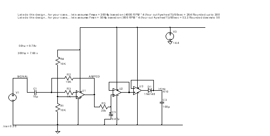

the lm2917 is unnecessary, look at this .asc. At 50 hz the out is 7.66 v, at 300 hz the out is 9.78. Use a voltage adder and add a -7 to it and multiply by 5 and you end up with an output of about 3 to 13 and that can be adjusted with the selection of the correct resistors.
Kinarfi
Ran the numbers, still not linear though, started with 300 hz and dropped by 50 hz steps
Hz-----V-----Diff
300 7.66
250 7.75 -0.09
200 7.89 -0.14
150 8.12 -0.23
100 8.56 -0.44
50 9.78 -1.22
Maybe some one else knows how to make it linear.

So i think i'm almost definitely dealing with interference/noise - by putting all cables away from the pcb and hiding it in a drawer I was able to go from (8 bit reading) 50 (out of 255) which was jumping beteeen about 40 and 60 right down to 17 in the drawer which would on;y jump between 15 and 19.
That 17 then, kept as far from interference sources as possible, must be the noise footprint of my circuit.
So seems I need to look into working with noise.

Hopefully 0-5v for a range of up to 4000rpm (though 5000 would be nice but would be an extreme value).
4 pulses per revolution, so the stock circuit that's been thrown about here should be quite close one would think!
