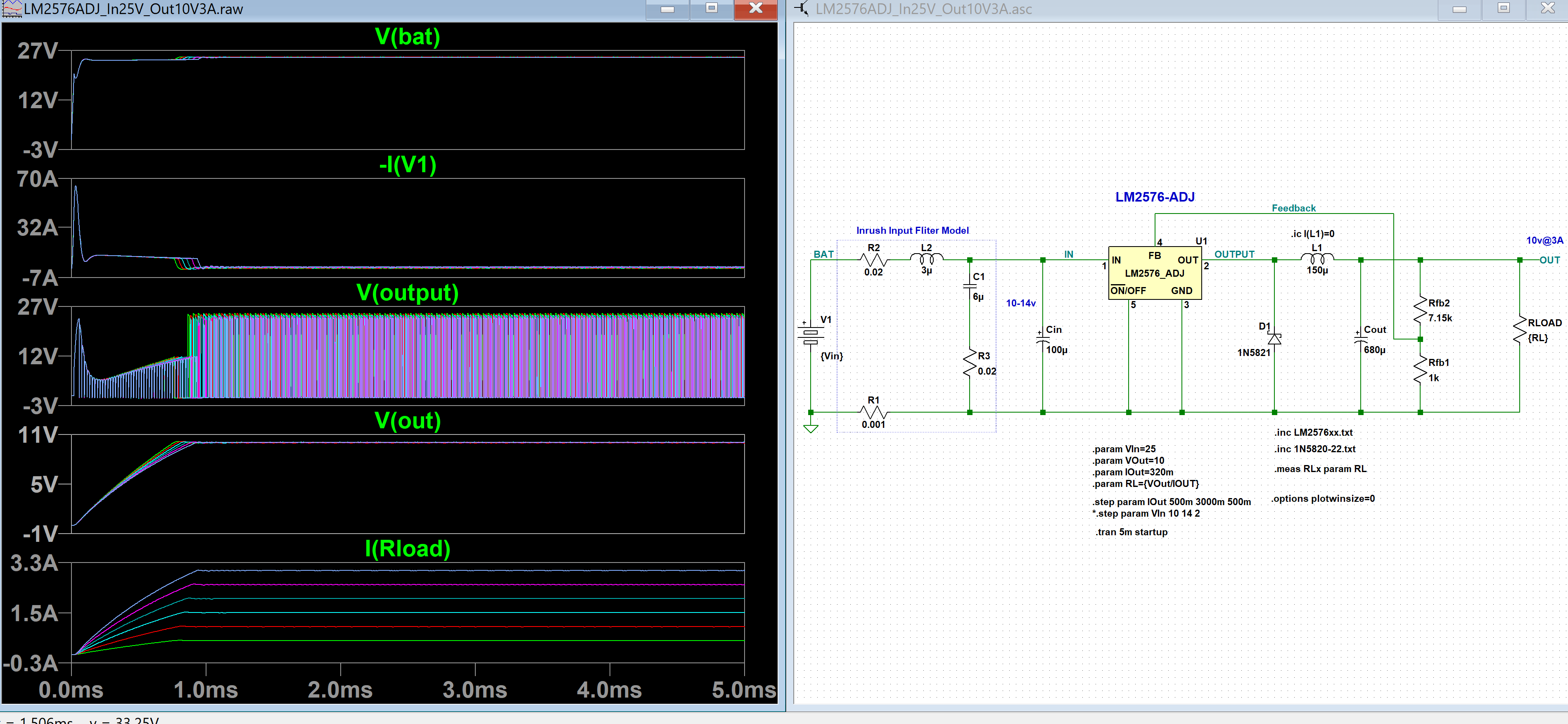

Per the request of a user, I'm posting a spice model and test circuit for the LM2576 Voltage regulators.
