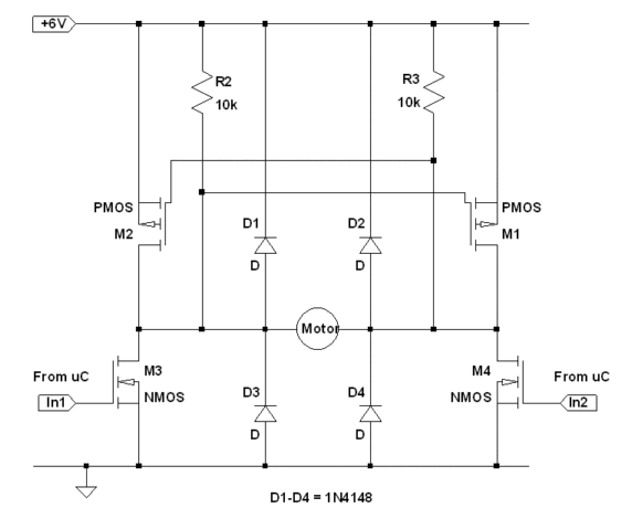

In the first, the lower nmos fet will merely short out the motor. Your fets are only half of an H-bridge. Google for an explanation.

If you want to use discrete components in a d-i-y H-bridge, it would look something like the attached. D1-D4 would not strictly be necessary if the fets have built-in protection diodes.
Explanation:
The bridge gets 2 control signals In1 and In2 from the micro. If In1 is high (4.8V) M3 switches on, pulling the gate of M1 low (~0V) via R2 and turning M1 on also. So the motor runs one way. Similarly if In1 is low and In2 is high then M4 and M2 switch on and the motor runs the other way. If both In1 and In2 are low the motor is off. It is essential that In1 and In2 are never both high at the same time, or smoke will rise!

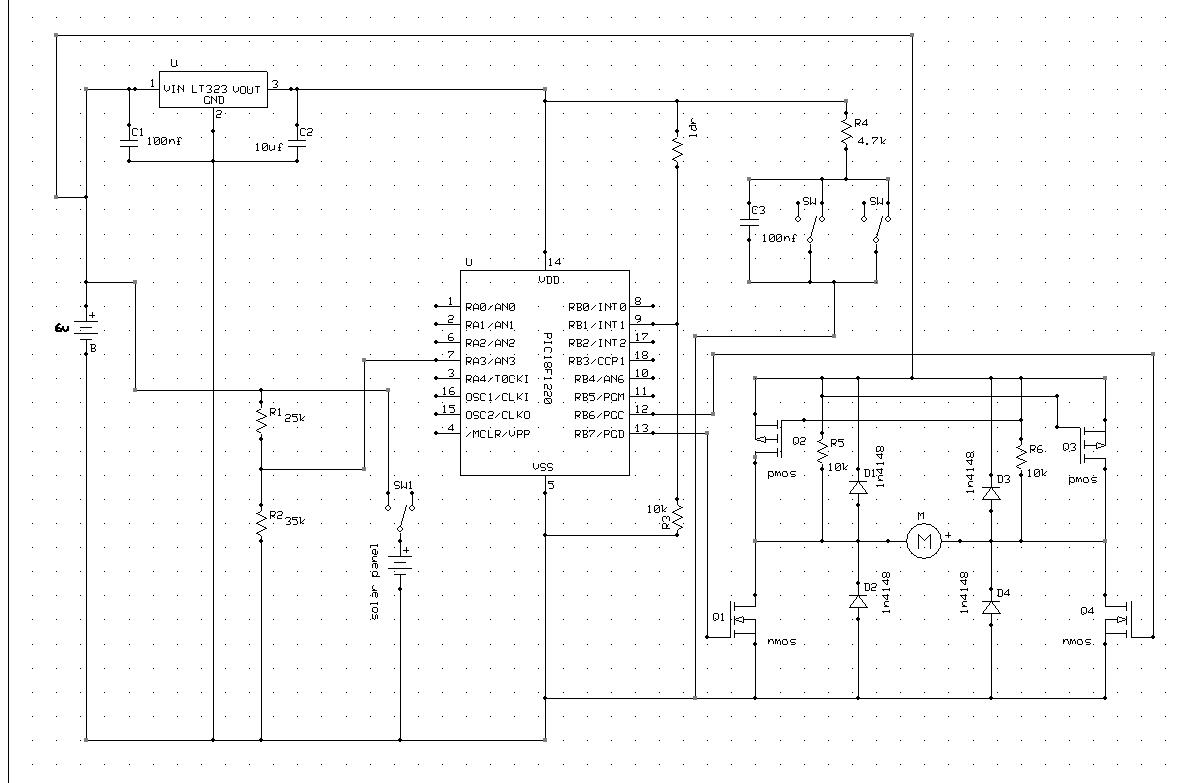

Right I think my schematics are done On paper I just have to transfer it to a computer I am going to use express sch to draw it up is there any better ones with a simulator that I can get?

Well, the solar panel is one of the problems ;-)
1) Nothing to automatically connect the solar panel (the Chrisatronics circuit uses a latching relay),
2) No light sensor,
3) What are R3 and R?? connected to pin 9 of the micro for? Do you really want/need to check the output voltage of the regulator?
4) The micro isn't connected (at the bottom of R4) to the limit switches.
5) The gates of Q2 and Q3 aren't connected as per my schematic.
Edit: The LT323 is not a low-dropout regulator so is unsuitable here. A much lower current-rating regulator would be perfectly adequate as only a few mA are needed at 5V.
1)i dont understand how in his schematics it works because its not connected to the micro so there is nothing to tell the solar panel to charge the battery.(how should that be wired on my schematics.)
the light sensor is there on the right hand corner of the pic express sch didnt have an ldr symbol, your question 3 is the awnser to your question 2.
5) its wired the same as your drawing
other than this is everything else ok?

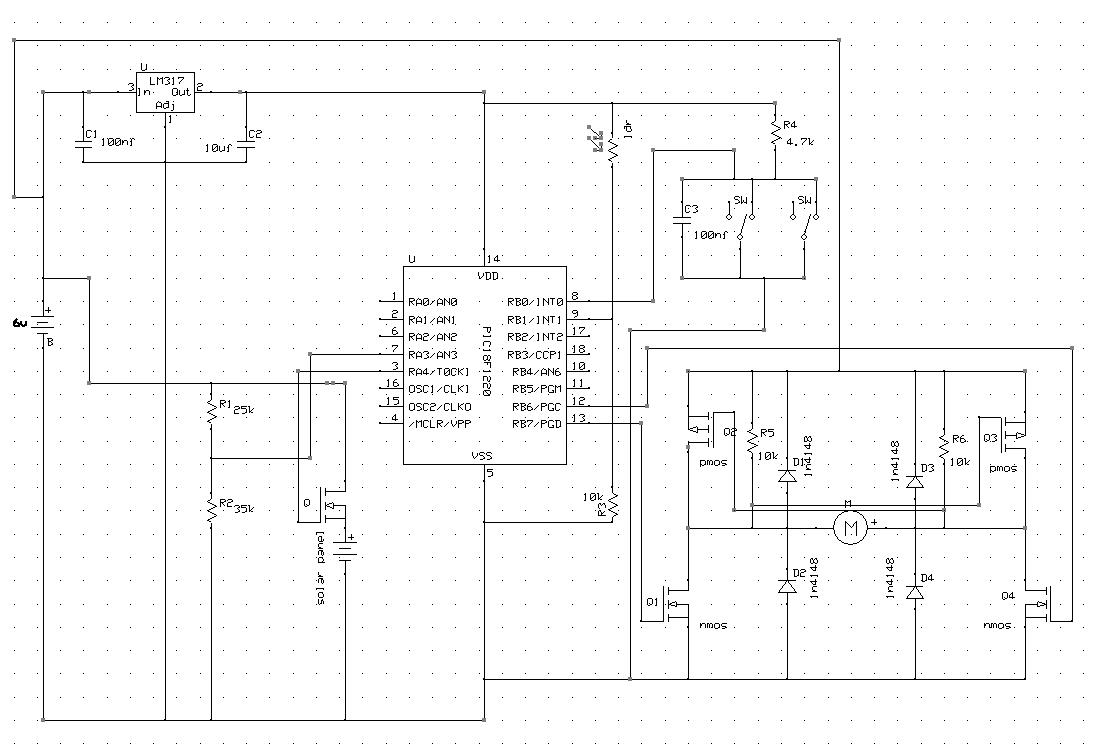

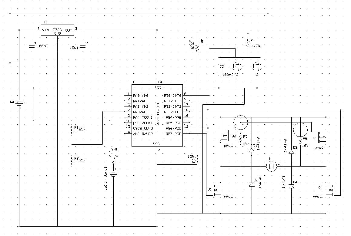

i have revised it to your spec and i have also circled the connections from Q2 to the resistor and Q3 to the resistor

Where you have circled the connections is not as per my circuit. You have both gates connected to the tops of the resistors, i.e. to +6V. The gates should connect to the bottoms of the resistors, i.e. Q2 gate>>R6, Q3 gate>>R5.
Edit: The voltage regulator is still shown as unsuitable LM323.
o ok i understand the resistors now and will change it, it only shows as lm323 because it doesnt have a symbol for the lm317T which is the regulator ill be using so would that be the best way for me to recharge the battery to copy that one? and on the pinout of the picaxe 18m2 i have 1,7,8,9,10,11,12,13,17 and 18 all programmable to in/out/adc some also do touch,pwm and i2c. but i will make sure it goes into an analogue port

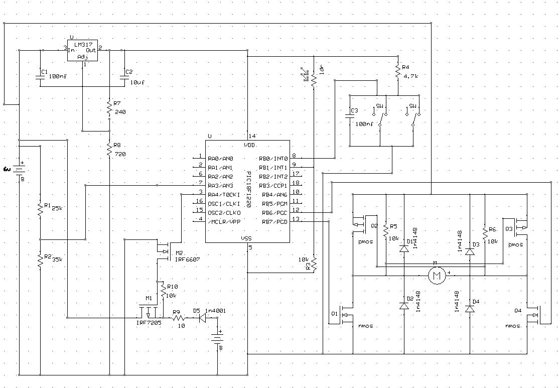

ok i have done a little modification i managed to find an lm317t, so thats been replaced. ive moved the Q3 and Q4 to the correct side of the resistor.
i have also changed out the switch from the solar panel with a mosfet im not sure this will work but it so i could read the voltage across the battery and program the mosfet to come on when the battery is going low and go off when its not needed.
would this work or should i just change the mosfet for a relay?
The nmos fet for switching the solar panel won't work as shown, because its gate pin needs to be driven several volts above its source pin to turn it on. There are problems with using a fet where the polarity of the drain-source voltage is subject to reversal, because most fets have a protection diode which effectively could provide a conduction path even with the fet 'off'. As a switch you could use an NPN bipolar junction transistor with its collector grounded and its emitter connected to the negative terminal of the solar panel; but that might need an additional negative voltage source to switch the transistor off fully. So that leaves a latching relay as the preferred option for switching the panel, as per the Chrisatronics circuit.
The LM317t needs two resistors to set its output voltage and must have a minimum load current. Check the thread about the LM317 in this forum.
Here's another option for switching the solar panel, which does not need a latching relay and needs only one control signal from the picaxe. Not knowing the characteristics of your solar panel I've included a diode to prevent any reverse current flow through pmos fet M1 and the panel in the event that its voltage is less than the 6V battery voltage. Both fets need to be able to be turned on with less than 5V between their gate and source. M1 must be able to handle the maximum charging current. R1 is a current limiter but may be unnecessary.

Can't see any obvious probs. Make sure there is plenty of decoupling of the power rails, by fat capacitors, as with only 6V there isn't much margin for the picaxe. A drop in its supply could cause nuisance resets.
Some component values might need changing if your motor is drastically different from the one you described. Good luck with the build!
thank you and when you say fat capacitors and decoupling, can you put that in laymans terms for me sorry. will 6v make it a problem? should i use 12v?
In your schematic C1 and C2 are 'decoupling' capacitors. Their effect is to 'short out' (decouple) any high frequency voltage spikes appearing at the input and output of the regulator. I would add another 10uF electrolytic cap from the regulator pin 1 to ground, and at least a 100uF electrolytic cap and a 100nF metallised polyester cap in parallel with it directly across the battery. The picaxe should have a 100nF decoupling cap wired between its Vdd and Vss pins, as close to the chip as possible.
Providing you have a suitable solar panel I would advise using a 9V or 12V battery (as per Chrisatronics). The regulator drop-out and decoupling would then become less critical.
