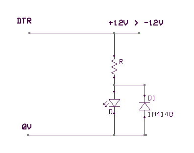

You can read/write to the 4 RS232 control pins on the serial port.
This means a MAX232 [ or equiv] for level shifting.

Not the TXD and RXD pins, you cannot set them high/low.
But the two outputs DTR/RTS you can set/high low with your program.
The output from the PC is +/-12Vish, so you could use a transistor to step down to 0 and +5V.

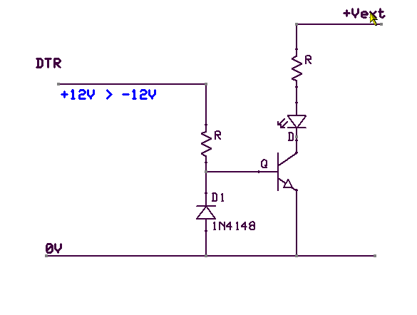

No problem.
Look at this image:

No problem.
Look at this image:
This circuit looks quite simple to implement and a bit hard to believe that it is that easy to generate output of my circuit! I will try to implment this thing and get back to you of the outcome.
Also, the value of the resistor. should i choose a small value for it??
To calculate the resistor I would need to know the LED voltage and current rating, also the actual voltage levels on YOUR RS232, they do vary.

OK,
The current drawn from the RS232 pins should not be greater than 12mA.
If you require a brighter LED, we will have to add a transistor and 3 resistors.
EDIT: something like this.

OK,

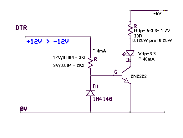

Hi Again,
I checked with my supervisor, and the serial port that i am using is D9 connector and the white LED i am using is attached here.
So what values will you suggest for the coponents in the circuit you gave me???
thanks

Look at my EDIT.:)

Look at this circuit.
NOTE: the 39R is based on a +5Vs supply to the LED via the resistor.
For any higher value of Vs, then R= [Vs-3.3]/0.04
