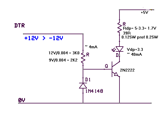

The unused pins on the DB9 should not be connected.
BUT.... pin #5 is the 0V/Common pin, which is connected to the 0V of the circuit diagram.

If you need to transmit RS232 serial data from the PC to a remote UART, use the TXD pin and 0V.
For the varying brightness LED, you will need to drive the DTR with a PWM signal, thats a signal where the mark/space ratio is varied.
For full brightness the DTR would be set 100% of the time and for say [rough] brightness, 50% on/off ratio.
Do you follow that.?
yes i followed the concept...so in our case, we are using the second method right???
so how do we vary the mark/space ratio???
You have to switch the DTR line high/low at a fast rate.
The brighter you require the led the longer the high/on time compared to the low/off time.
You have to set the mark/ontime proportional to the LDR signal.
