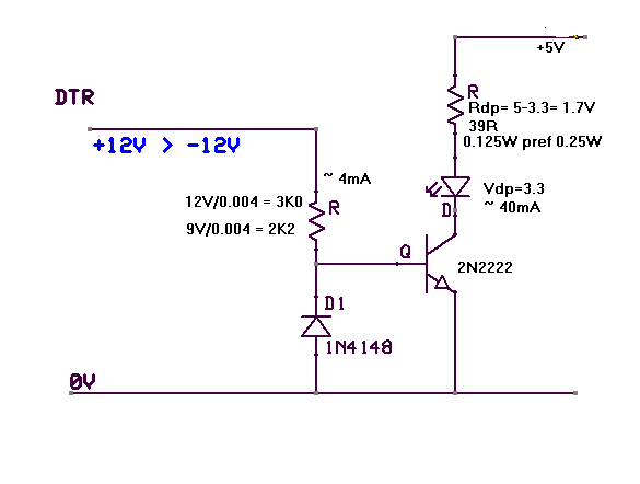

Not really.!
You are sending pulses to the DTR line which drives the LED drive transistor.
Not data.
The pulses are in a PWM format, pulse width modulation.
example: set DTR high, led is lit, set DTR low, led is off.
If you send an On and Off pulse at a fast rate and the On and Off periods are of the same duration, the led will appear at roughly half brightness.
If you make the On period say 75% and the Off period 25% then the led will appear at roughly 75% brightness.
As you know the required brightness of the LED after calculating from the LDR input from the PC paraport, you can pulse the DTR at the required mark/space ratio.

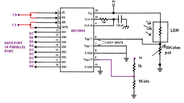

ldr1 is my input circuit and the other circuit is the one you have given me...he says, replace the DTR pin with Txd and set the RTS pin low or high and make it working...
my input is ready, getting all the voltages properly and storing them in a variable. now point is the output...
he expects to set the RTS pin high and low using the code and while doing this write the data on serial port.....but whats the use of writing like should i write the voltage value on the TxD line will will be given to the driver circuit??? but i dnt thnk this works...
what are ur views on this???
Has the teacher seen the LED drive circuit.?
You can use either the DTR or RTS signal to drive the transistor.
If you send a 'voltage' value on the TXD line it will be in RS232 format and will not be suitable for controlling the brightness of the LED.
It will only be useful if you have a remote PC or UART that can receive the RS232 data.
I think there is a misunderstanding between you and the teacher of what is required.
Ask him why does he want you to switch the RTS line and whats the purpose of putting the LDR voltage on the TXD line.???
Hi there,
i tried to toggle the DTR line finaaly using a code....but if i connect just a LED and resisitor it is working but it is not able to drive the circuit that you suggested me
Hi there,
hey one more question..
does DTR go to level high automaticaaly???
like when i set the DTR pin i get voltage -11V and when i clear it i get +10.6V. And once, the code stops, the output at DTR is again -11V. So is everything going ok according to your kowledge?

The voltage levels look OK.
I will make up that transistor/led circuit and prove for you that it works.
Will post result within 24 hr. OK
EDIT:
Tried the circuit, works OK, also it has been used often in the past.
You must be doing something wrong at your end.
Post a circuit showing how its connected to the serial output and the +5V..

well, i did test the circuit the way you posted to me...but if u are still saying then i will check it again and get back to you later.
is that ok?
is that ok?
Thats OK, but a simple sketch would also be helpful.:)
