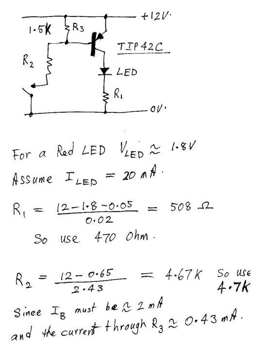

Okay, buickskill
That transistor is alright, but you will, as everyone has said, need to reverse the polarity for my diagram.... put V+ (positive) to the emitter, and the collector and base to negative. I still think you need around 5 to 9 volts, however, if no other reason than to understand and comply with most of the circuits floating around.
You can use the PNP transistor, ie. the TIP42C with a positive supply.
I'll post a circuit later.

The 1k in the base is an over kill.
For Red LED I estimate the collector current will be about 13.6 mA. So you need about 1.36 mA of base current.
Thus for a 5V supply, a 3k3 resistor would suffice.

It is hard to read the circuit as it is out of focus. Does your camera have macro function?
As far as I can see, the transistor appears to be a TIP42C. If so, then you're using it the wrong way around.
I'll post a circuit shortly.
Here it is with a 12V supply for a Red LED.

G'day AllVol,
I could not make much out of the picture, so I drew my own.
I used 12 V as he wants to eventually run it on 12.
cheers,
