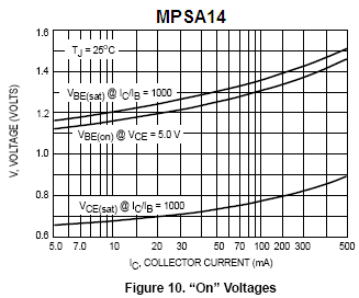

let's see if i'm getting this right.
The MPSA14 is a darlington with a typical current gain of 60,000.
Motorola invented it and their datasheet shows a saturation voltage chart with Ic/Ib= 1000.

i got a question where did the 1000 come from?
i was looking at the pulsed current gain(K) chart. and it said just over 100. but just wondering so i know for next time!! Thanks
Well done!
The 1000 comes from the Vce sat conditions.
I have the Fairchild data sheet and it gives Vce sat for Ic = 100 mA and Ib = 0.1 mA.
Therefore, hFE = 100/0.1 = 1000.
Also note that Vce sat = 1.5 Volt max under these conditions.
The pulsed current gain for Ic between 1 mA and 100 mA is about 100k, ie. 100 000.
The minimum is specified as 10k at Ic = 10 mA & Vce = 5V and 20k at Ic = 100 mA & Vce = 5V.
