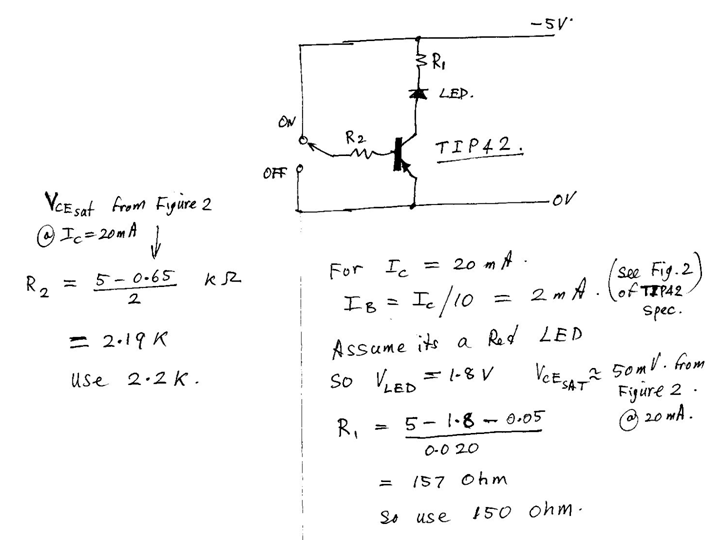

would i have to change something minor about the circuit (Drawing) to make it possible to make it work? and work right. or am i WAYYYYY off? i don't know why this is so hard lol.
You and RadioShack are WAYYYYY off!
Look at the datasheet for a little MPSA14:
1) NPN darlington transistor.
2) Minimum current gain at 100ma= 20,000.
3) Absolute maximum Ic= 300mA.
4) Max power dissipation if the ambient is not hot= 625mW.
Len showed you how to wire the circuit with an ordinary transistor, an ordinary LED and a 5V supply.
Why did you change everything around and use 12V?
You will need to use a small power transistor like a TIP31 (don't get it at RadioShack) and use Len's wiring.

See the attachment and Figure 2 from the TIP42 data sheet.
Edit, I just noticed from Audio's post that you're using a 12 Volt supply.
So it will be a good exercise for you to alter what I did below for a 12V supply.
i will post a pic on the morning of my current "CIRCUIT" and will try to alter as shown. yup 12v. i'm stuck with it i shorted out the PSU i was using. and can't seem to get it to work again. so i'm stuck with a broken wall wart that i broke the sliding voltage selector on. one question. in the pic i see a -5V on the pos side. Wheres that comming from?
To put it simply. . .
That's because PNP's are opposite to NPN's. I think that's what's confusing you. If you look at the tip42 datasheet, all of the voltages and currents are NEGATIVE.
It's probably best to get used to how NPN's work before you go onto PNP's, that will be less confusing.
If you really want to try this circuit, don't worry about -5v and 0v if you don't have a negative supply, just use +5v instead of 0v and 0v instead of -5v (ie. reverse the polarity)
It is not on the "positive" side.
It is a negative voltage since the collector and base of a PNP need to be negative with respect to the emitter.
The photo you posted does not help me to see what you have done.
A circuit diagram would be much better.
Do you have a scanner?
If not a photo of a hand drawn sketch would suffice - assuming that you don't have a drawing package such as PowerPoint.
