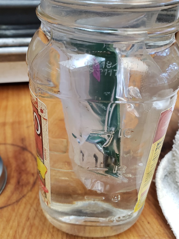

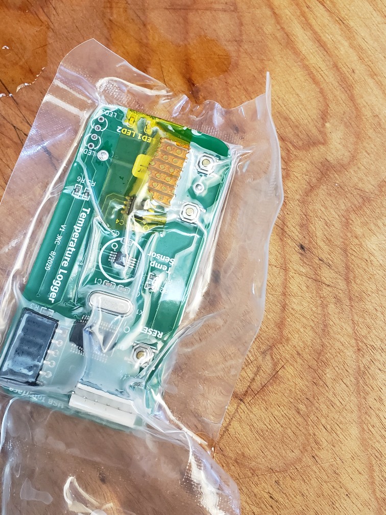

A couple more pictures.
The data logger is vacuum-sealed for the test. There's a small piece of perf board taped by the switches so the vacuumed bag doesn't press them.
Then put in a quart jar of water. If we get a workable temperature range, it will eventually be put in the center of a jar of whatever is being canned.
