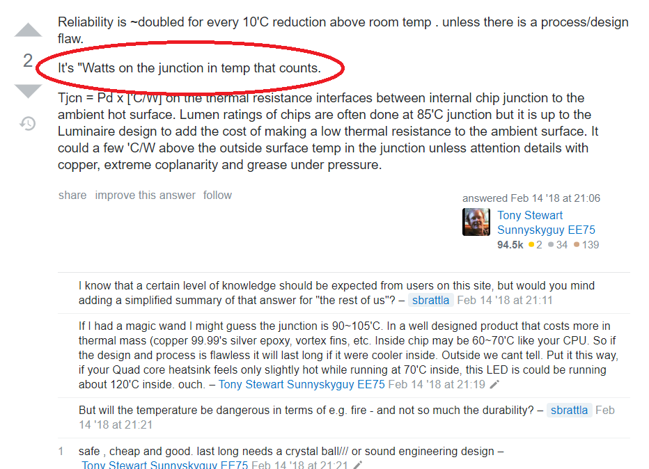

Found this on Stack Exchange, by ETO member Tony Stewart :
From here:
As you know, I'm not an EE, just a hobbyist, so if what follows is a steaming pile........you know what to do.

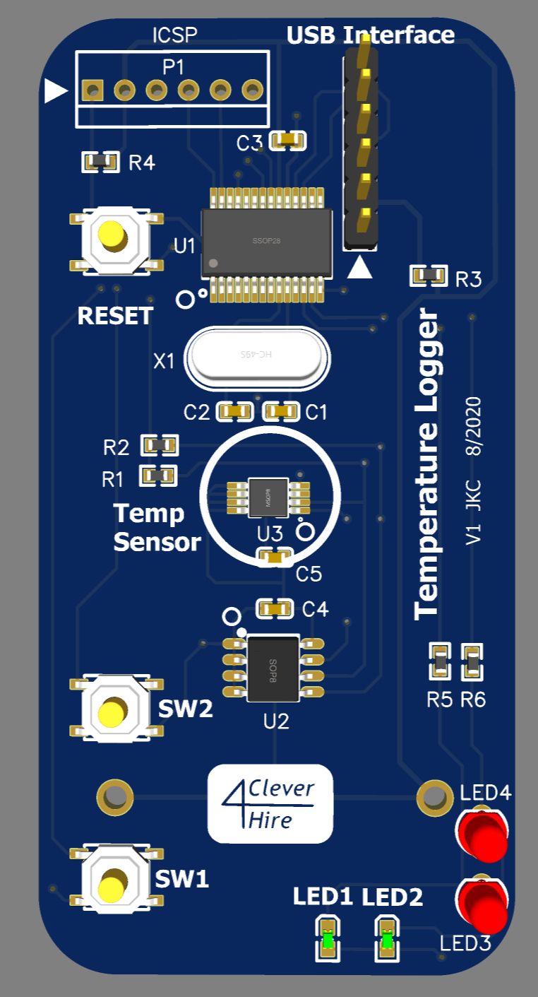

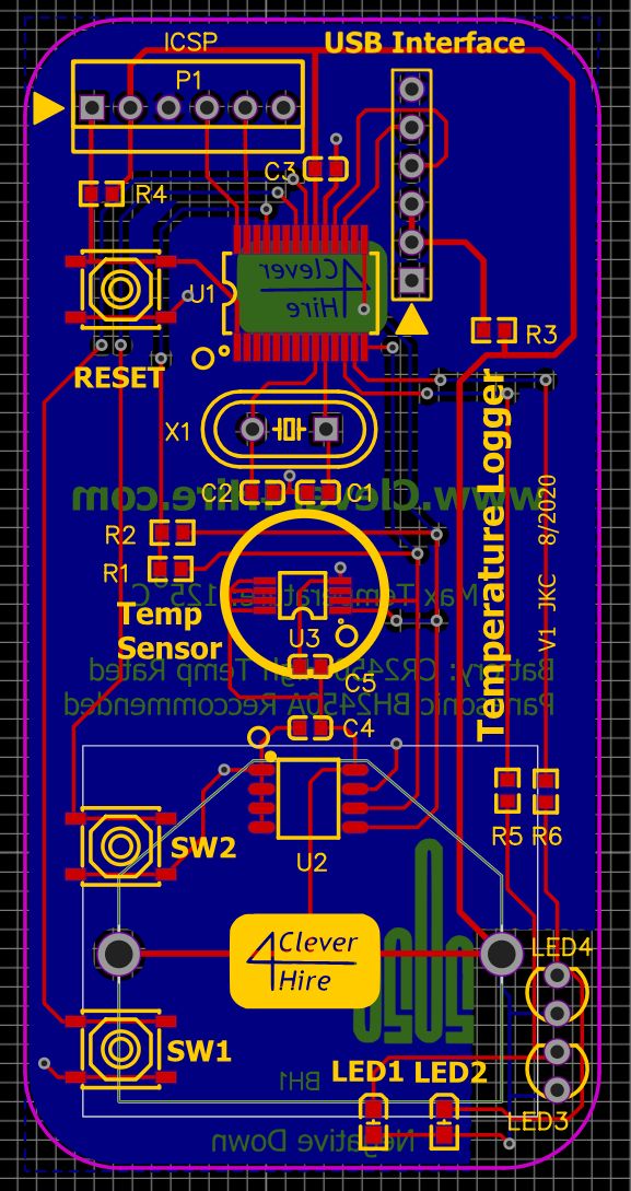

Here's a picture of the finished board, which is 1.5" × 3". The size is such that it will position the temperature sensor in the center of a pint canning jar. The connector at upper right will actually be a female right-angle header. A CH340 UART-USB module will plug in directly to unload stored data.
The MCP9808 is located at the center of the board. LEDs 3 and 4 are for through-hole replacements if the SMT LEDs don't survive. They are positioned so a 4 position right-angle female header can be installed to make the LEDs easily replaceable.
The battery holder for the temperature-rated CR2450 is on the back of the board.
In-use, the board will be vacuum-sealed in a plastic bag that can withstand the temperature.
I haven't yet defined the purpose of the two switches and LEDs. I will need some kind of easy-to-use user interface, since these boards may be used by others.

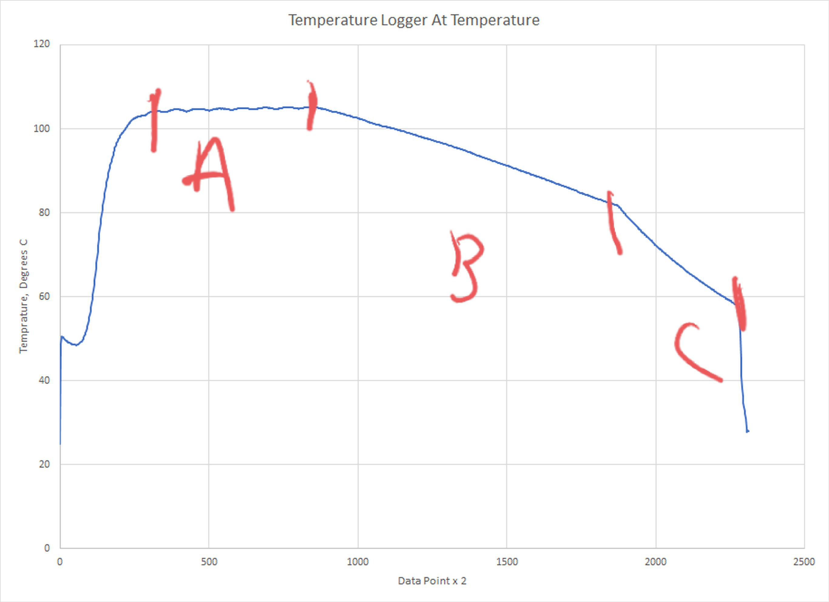

The test results are in. The test was a success!
1156 measurements were made at 16 second intervals – a period of over 5 hours. The data logger was still functioning (i.e., battery not dead) when I removed it from the jar after it had cooled down.
The LEDs do not appear to be diminished at all.

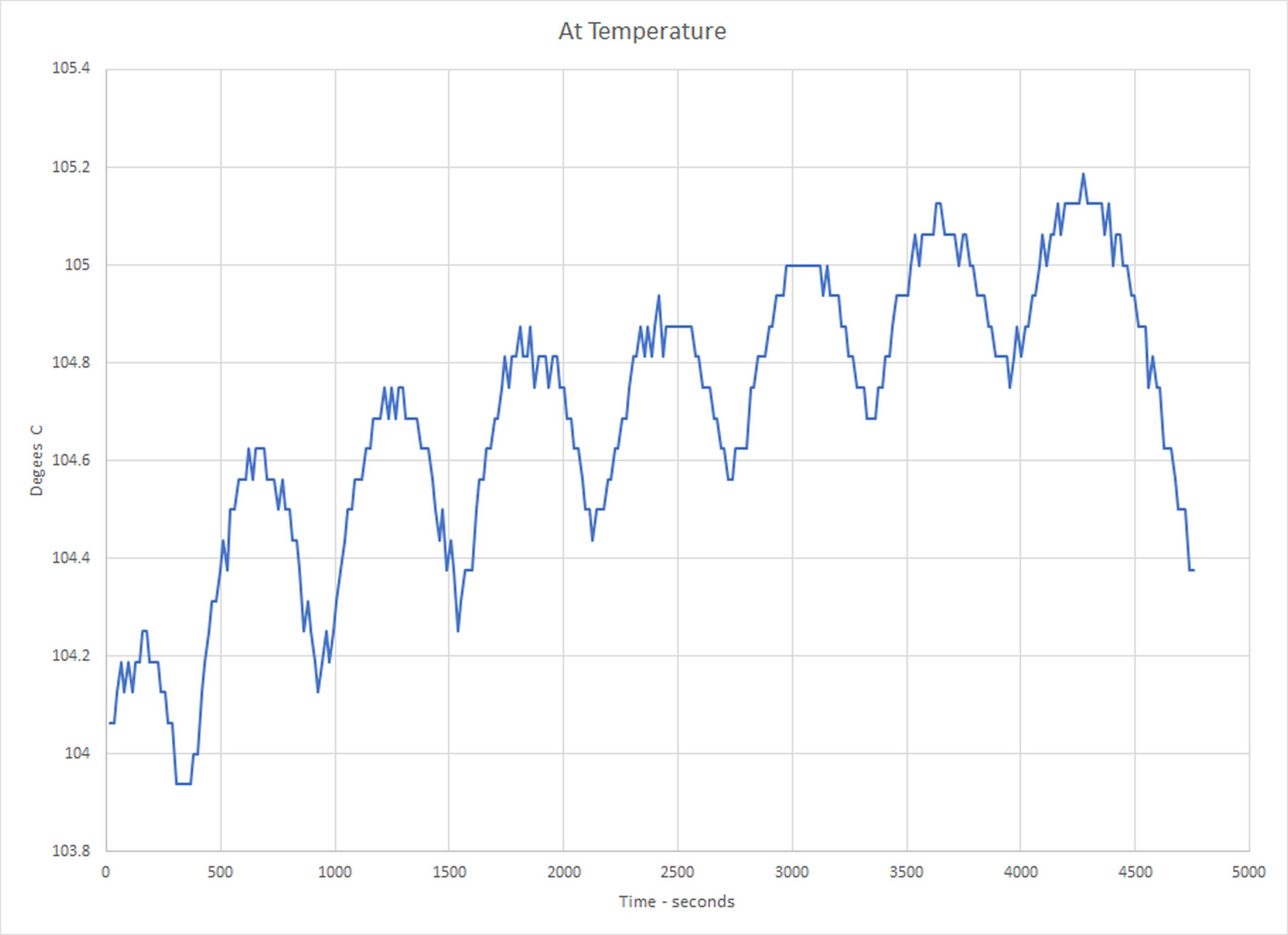

The first graph shows the entire sampling period, starting with hot water in the sealed jar. Section A is the 85 minute period the pot was at pressure and temperature. Section B shows the jar cooling inside the sealed Instant Pot. Section C is the cooling period with the jar removed from the Instant Pot.
This second plot shows an expanded plot of the temperature while at pressure. Note that the span of the measurements of the vertical scale is only about 1.1°C. It looks pretty horrendous but it's actually fairly tight temperature control.
Temperature was measured with a Microchip MCP9808, which has a temperature accuracy of +/– 1°C between 100°C – 125°C.
The temperature monitor has been proven a success.
The results the first test provided, based on one off-brand Instant Pot, aren't what we had hoped for. The maximum temperature of ~ 105°C corresponds to about 1.2 atmosphere.
We had expected about 1.5 atmosphere to reach a temperature of 111°C, which is the minimum safe temperature to can fish.
But this is just the start of the project to document whether any Instant Pot is up to the challenge.
