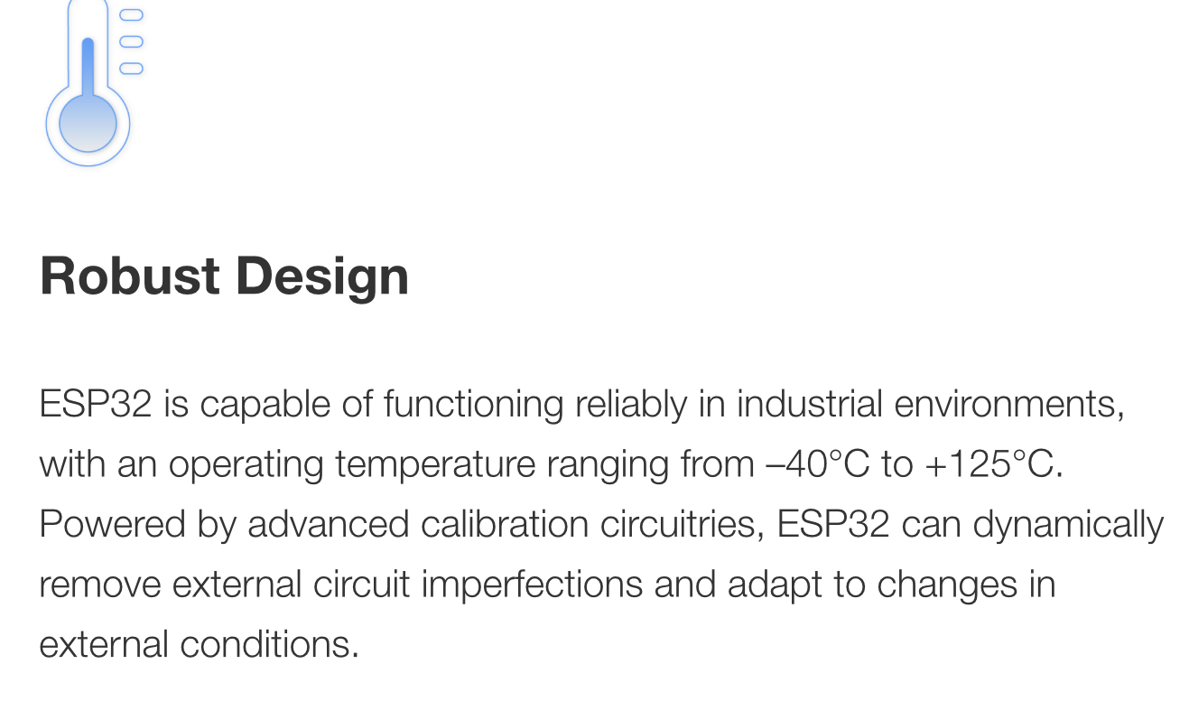

Use an ESP32 or ESP8266 and you can send WiFi or Bluetooth signals instead of flash an LED.
Easiest if you make the ESP a web server in Station/Access Point mode and each time you ping it with your phone/tablet or laptop, it sends current temp/pressure. It won't transmit through the steel installation well but, hey, same problem with LEDs. It would be interesting to hear if the ESP survives the 122°c for a few minutes.

Use an ESP32 or ESP8266 and you can send WiFi or Bluetooth signals instead.....
I don't know that RF would get out of the pressure vessel. There is a silicon gasket, so it's not a total metal-metal seal, but the lid overlaps the gasket.
I suspect the temperature rating of an ESP32 doesn't approach 125°C. Have to look that up.
