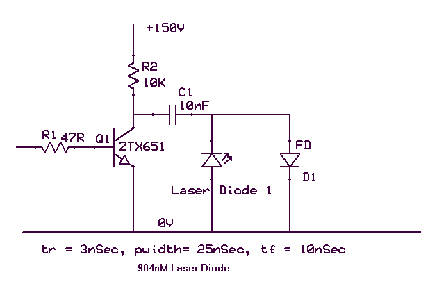

This is the circuit I have used, 30Watt LD1, Range 5000mtr, off three prisms.

How do you control the laser current? I have never played with solid-state lasers, but I thought that the current had to be carefully controlled.

As you may know the transistor can be driven into a avalanche conduction state by applying a Vce greater than the transistor rating and driving the transistor base with a heavy current. This discharges the 10nF, which is charged to 150V via the 10K.
The collector effectively grounds the +Vside of the cap putting -150V across the LD1. The value of +V and the Cap are chosen so as to keep within the operating envelope of the laser diode.
The clamp diode is to protect the LD1 from reverse voltages.
We pulsed at 250 or 400 pps
