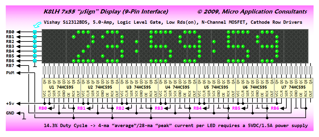

I'm working on the code for the larger 7x55 version (below) for an 18F2520 host mcu. I will post code when available...

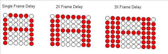

Mike I have a doubt which is bugging me last couple of years & that is regarding the scroll speed.
Mike lets assume you have a 7 rows & 56 column display area. Let say you need a letter to scroll from right to left.
To make the shift delay you are counting frames.In other words to make a shift you are waiting until an entire frame ends.
Ex: Refresh rate of 50Hz will have 20mS time.So to make a shift you are waiting 20mS time.
My question is have you ever used more than 1 frame for the delay for the scroll speed? ex: to make a shift you are waiting 5 frames that is 20mS X 5 = 100mS.
My experiments shows when using more than 1 frames for the delay you will notice visual artifacts.Something like mirroring.So while scrolling its not smooth you will see a trail of each LED.Have you ever seen this?

I do use multiple "frame" delays but I'm not sure I've ever seen the visual effects you're describing.
On the larger 7x55 and 8x56 MacMux displays I load 56 bits of row data into the shift registers during a short blanking interval (from PWM signal). It only takes 26 instruction cycles to load the shift registers with 56 bits of row data but the display may be off longer then that depending on the PWM brightness control setting.

I cannot use multiple frame delays.If I use then the LEDs will move with a trail.
