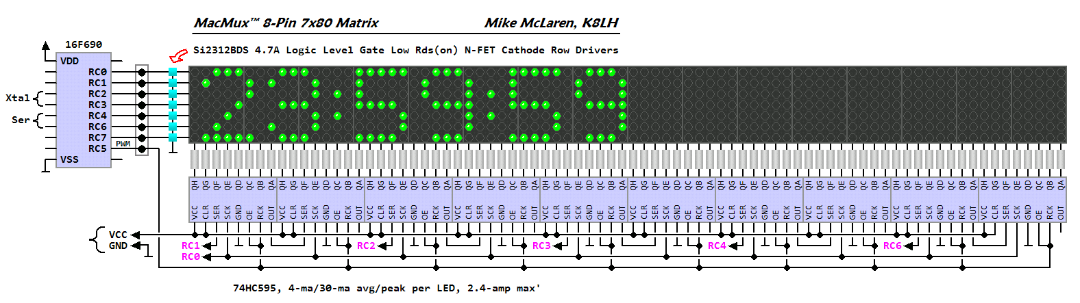

Did you ever order any of these 0.7-inch 5x7 displays for 69 cents each? They might be a nice candidate for a 7x40 or 7x80 display using my MacMux™ architecture and relatively inexpensive 74HC595 column driver ICs.

hey nice job. Thats exactly how i would do it. Those LEDs are from BGMicro right?
he 595s are perfect because of the latch feature. My choice of MCU would be:
PIC18F2455
Mainly because its cheap and as fast as 48Mhz/12MIPs. which is about 12Mhz really in the pic world. since the max fcy the HC595 can do is 100mhz i say this 12Mhz is really fast and can switch these puppies nice!

Almost any 28 pin 18F' would be fine. I only put the 16F690 in that design because the serial port pins aren't on PORTC and I could use all of PORTC for the 8-pin bus.
You don't need a lot of horsepower with this design. A 4-MHz clock will work fine. Both 40 and 80 column displays run at a 1/7th or 14% duty cycle which provides decent brightness (4-ma "average" current per LED) with 74HC595 sourcing drivers and keeps "peak" power supply requirements managable.
One thing! how slow can one go before the leds look bad? Like how fast does one need to switch for the whole thing to appear lit?
A static display should be refreshed at 60-Hz or more to avoid flicker which works out to about 2.4-msecs or faster per row update. If you're going to animate the display (scrolling, etc.) then a higher refresh rate is desirable to avoid the 'slanting' you sometimes see when scrolling horizontally at a fast rate. Also, animation should be synchronized to the refresh cycle or "frame rate" and so higher refresh rates allow more frequent animation updates.

You may be thinking of designs similar to Gayan's original design where adding additional modules will reduce the display duty cycle. That's not the case with these MacMux™ design examples. Both the 40 and 80 column designs run at a 1/7th or 14% duty cycle. The 80 column design just uses a little bit more ISR 'overhead'.

Hi Mike I'm studying your last design 7X40 using 74HC595.
Can you tell when an timer interrupt occurs I must feed the first row datas.The data is in the 40 column registers.So I must bit mask the column registers & feed the data to the first row one by one.
After feeding finished the first row, I'must give latch to the latch pin & come out from interrupt
Likewise in next interrupt I'must feed the 2nd row like above.
Is this correct?
Hi Suraj,
There are some special driver considerations with the MacMux designs. They use the PIC PWM output to modulate the OE (output enable) lines on the driver ICs which allows us to retask the row driver lines temporarily for use as <CLK> and <DAT> lines to load all of the shift registers in parallel during a short blanking interval at the beginning of each row scan interrupt. This method allows us to load 40 bits of column data into the five shift registers by simply writing 8 bytes and clock pulses onto the row driver buss at the beginning of each row scan interrupt;

This code loads the shift registers with 40 bits of data in something like 25 instruction cycles. The PIC PWM output turns off the display allowing us to use the buss to load the shift registers and then latches the shift register data onto the driver outputs and turns on the display.
You need additional "data bender" code in the ISR to build those eight special shift register bytes from your display[] array before each new row scan interrupt.
I'll throw an example program together and post it for you as soon as possible.
Take care. Regards, Mike

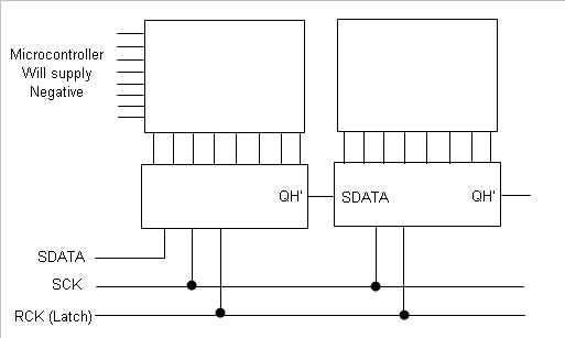

Hi mike thanks for the great help.
Actually the “MAC Mux” is a bit hard. I’ll try to do it later.
For the time being I’m doing a standard multiplex but I need to do a row scan.
I have attached my drawing; the positive to the LEDs will supply via the shift registers. & the negative supply to the LEDs will supply via the microcontroller.
You may notice I have cascaded the shift registers via the QH’ to SDATA.
This is the method I’m going to use.
In row scan I need 40 column registers if I have 40 columns.
When a timer interrupt occurs I must first serve the first row. This is done by sending all lower bits of column registers to the shift registers. After feeding all 40 columns in the first row I must make a “latch” to show in the display. After latching I must return from interrupt.
Likewise in next interrupt I’ must feed the 2nd row like above.
Is this correct?

Hi mike ........ Is this correct?
Hi Suraj,
It seems you have the correct procedure. You need to keep track of the row number and select the correct five bytes (40 bits) of data from your display array during each interrupt. You'll clock out those 40 bits into the daisy-chained shift registers, blank the display, latch the shift register data onto the outputs, then select the new row to turn the display back on. You do this procedure each interrupt to display a new row.
