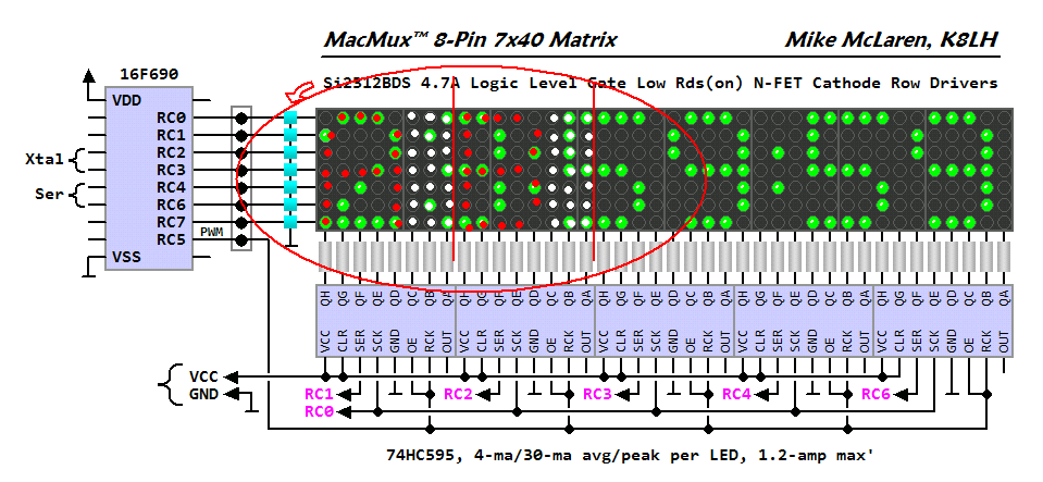

Ahhhh here now comes the problem..........
In your method it can load a particular byte of a character to the shift register directly.But consider when showing the 2nd character theres a three column gap.How do you overcome this problem mike?
But I see your clock is displaying within the shift register columns nicely.

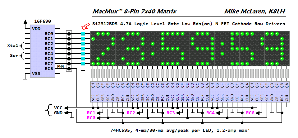

Gayan,
The following text refers to my 7x55 design.
I use a "character generator" subroutine to place the character pixel bits into the display[] array. This sub' will shift and mask the character pattern as necessary according to an 'htab' value of 0..55. The display[] array maps directly to the display hardware, that is, the display[0..6] bytes are row 0 with bit 7 in the display[0] byte mapping to the left most row 0 pixel and bit 0 in the display[6] byte mapping to the right most row 0 pixel. The ISR automatically loads the shift registers from the display[] array, using bytes in display[0..6] for a row 0 update, or bytes in display[7..13] for a row 1 update, etc..
Regards, Mike
Gayan,
Regards, Mike

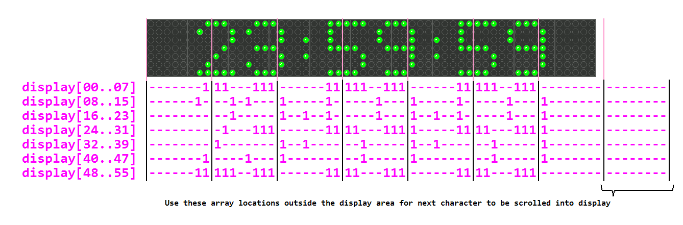

May I ask if you're using an array of bytes as a video buffer in your designs? In other words, do you have an ISR which takes data directly from this buffer (array) to "paint" the display hardware and does your 'main' program simply manipulates bits in the video buffer (array)?
Mike
<added>
This may give you an idea of what you need to do with the rom character pattern for the number "2" to place it into the display array (straddling an 8-bit shift register boundary). Seems daunting, doesn't it?

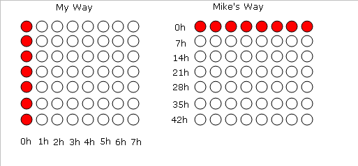

Hi Mike thanks for your ideas & time.Now I see what you doing.
My ISR takes data directly from the column registers.The advantage of this method is character placing is very easy even though it takes more RAMs.
Mike couple of questions.
If you need to display a letter let say from 12th column, first you loading 12 & calling your character generator?
What about displaying a word like "MIKE" do you have to send the starting columns of each letter to the character generator?
While traveling I thinked your method its hard mike you have to deal with 14 registers every time when you have to place a letter.

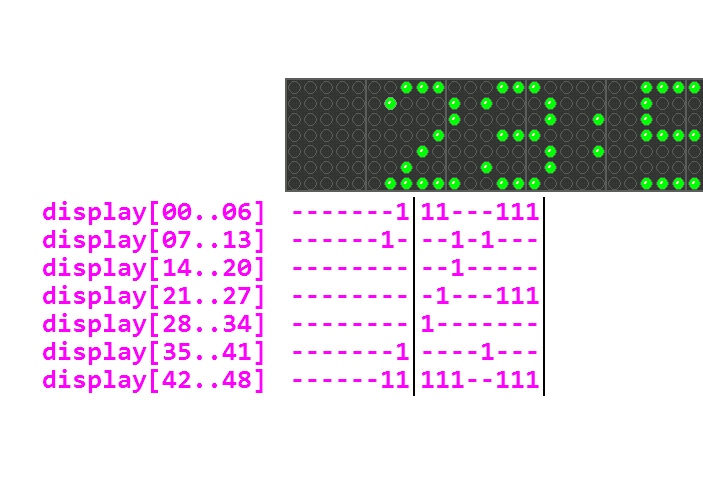

Gayan,
I just use "htab = 12" to set or change the htab. The character generator automatically advances "htab" by 6 after writing each character to the display buffer so no need to change "htab" for each letter.
Yes, the character generator is a bit more involved when you multiplex rows and it updates 14 bytes in the display buffer for each character but the advantage is that adding columns to this type of multiplexed display does not reduce the LED duty cycle (and brightness).
Mike
Mike i'm doing a row scan for larger designs like my last youtube signboard.if i have 64 columns i'm taking 64 registers.in ur method you are taking 56 registers.in isr routine i track the row position & bit mask the appropriate bit & fill the entire row bit by bit .but you are filling entire row byte by byte.thats the different between us.
Hi Gayan,
If I was simply doing a scrolling signboard then I would probably increase the size of the display array (see drawing below) so that one complete character can be built outside of the display area and scrolled into the display one column at a time. Copy the character pattern from rom (table) into those right-most row bytes (no byte boundary problems), scroll one new column at a time into the viewable portion of the display buffer, then do it again for the next character.
The scroll_left routine is simple (and fast);

Pulling a new character pattern from the rom character array (table) and placing it in ram is relatively easy too;

Hi mike thanks for those wonderful comments.
I just checked your way of doing.Scrolling all 4 ways easy but the problem with character aligning.

But I still wondering do I need a character generator.To do a basic scrolling you don't need a Character generator.
I'm doing a research these days what is the speediest way of doing a multiplex routine.
Let me tell it again.
Mike I'm doing a row scan.If I want to do a 56 column display I'm taking 56 column registers.But in your case you are taking 49 registers.
The method I'm following doesn't need a character generator & its really easy to place charactors.I'll post a picture for better understanding.
That's what I was trying to say -- if all you're doing is scrolling text then you don't need a character generator function. Just stuff your character pattern into the display buffer outside of the viewable area (see diagram in my previous post). There's no alignment problems. You simply copy the seven byte character pattern into the display array.

k8lh-7x55-%C2%B5sign-concept-png.34823

Mike I'm using 74HC595 registers for larger displays.Here are the register placing between us.I'm placing registers vertically.In ISR routine I track the row position & bit mask the appropriate bit & fill the entire row bit by bit.

Ok now I see why you're using 56 bytes for the display buffer.
Your Character Generator routine for my display buffer method is excellent. Of course you don't need it if you're only scrolling messages but you really did "nail it".
Here's a version of your routine that I just threw together with pseudo C code comments for anyone that's interested in a different perspective, comments, etc.
Basically the character generator shifts a 16 bit mask and a 16 bit character pattern which is necessary in order to write a character into the display buffer with 1 pixel horizontal resolution (with my particular display architecture);

;    MaskR = 0b11111111;        //
;    Count = htab % 8;          // 0..7
;    while(Count)               //
;    { asm                      //
;      { setc                   //
;        rrf    MaskL,F         //
;        rrf    MaskR,F         //
;      Count--;                 //
;    fsr = 0x20 + htab / 8;     // fsr = &display[0..6]
;    row = 0;                   //
;    do                         //
;    { CharL = GetChar(charval,row);
;      CharR = 0;               //
;      while(Count)             //
;      { asm                    //
;        { clrc                 //
;          rrf     CharL,F      //
;          rrf     CharR,F      //
;        Count--;               //
;      indf &= MaskL;           //
;      indf |= CharL;           //
;      fsr++;                   //
;      indf &= MaskR;           //
;      indf |= CharR;           //
;      fsr += 6;                // bump index for next row
;      row++;                   //
;    } while(row < 7);          //
CharGen
        movlw   b'00000011'     ; display bit mask
        movwf   Mask_L          ; 00000011 11111111
        movlw   b'11111111'     ;
        movwf   Mask_R          ;
        movf    Htab,W          ; 0..50 max
        andlw   7               ; W = Htab % 8 --> 0..7
        goto    RTest           ;
RMask   setc                    ;
        rrf     Mask_L,F        ; rotate 16 bit mask
        rrf     Mask_R,F        ;
RTest   addlw   -1              ; done rotating?
        bnz     RMask           ; no, branch, else
        andlw   b'11111000'     ; toss b2..b0 fraction bits
        movwf   FSR             ; 0, 8, 16, 24, 32, 40, 48
        swapf   FSR,F           ; pseudo divide-by-16
        rlf     FSR,W           ; preserve Carry and multiply by 2
        rlf     FSR,F           ; FSR = htab / 8
        movlw   Display         ; W = &display[0]
        addwf   FSR,F           ; FSR = &display[0..6]
        clrf    Row             ; Row = 0
DoRow   call    GetChar         ; W = getchar(charval,row)
        movwf   Char_L          ;
        clrf    Char_R          ;
        movf    Htab,W          ; 0..50
        goto    Check           ;
Shift   clrc                    ; shift 16 bit pattern
        rrf     Char_L,F        ;
        rrf     Char_R,F        ;
Check   addlw   -1              ; done shifting?
        bnz     Shift           ; no, branch, else
        movf    INDF,W          ; display[rowindex+htab/8]
        andwf   Mask_L,W        ;
        iorwf   Char_L,W        ;
        movwf   INDF            ;
        incf    FSR,F           ;
        movf    INDF,W          ; display{rowindex+htab/8+1]
        andwf   Mask_R,W        ;
        iorwf   Char_R,W        ;
        movwf   INDF            ;
        movlw   6               ;
        addwf   FSR,F           ; bump index for next row
        incf    Row,F           ;
        movf    Row,W           ;
        xorlw   7               ; all 7 rows done?
        bnz     DoRow           ; no, branch, else
        return                  ;
I'm placing registers vertically. In ISR routine I track the row position & bit mask the appropriate bit & fill the entire row bit by bit.
Ok, I see what you're doing. That seems like a good method. I had thought you were still using '164 drivers and were concerned about how long you had to blank the display while loading the shift registers with 56 bits of column data during each row update. With the '595 drivers you should only have to blank the display for a few cycles when you latch the shift register data onto the outputs and select the new row and so it shouldn't matter how long you take to actually load the shift registers with 56 bits of data during each interrupt, unless you're trying for some extremely fast refresh rates.
How may cycles do you use in your ISR to update a 56 bit row? My 7x55 or 7x56 MacMux design uses 160 cycles (18F') up to about 190 cycles (16F'). If I were to use three seperate pins to load 56 bits into daisy-chained 74HC595 drivers, instead of using the MacMux interface, it would probably take about 350 cycles.
Regards, Mike
Brilliant.
Thanks for your time & effort Mike.

How may cycles do you use in your ISR to update a 56 bit row? My 7x55 or 7x56 MacMux design uses 160 cycles (18F') up to about 190 cycles (16F'). If I were to use three seperate pins to load 56 bits into daisy-chained 74HC595 drivers, instead of using the MacMux interface, I can do it in about 250 cycles, maybe faster if I tried.
I'll let you know this.Your MacMux method saves a lot cycles.I've got used to daisy-chained 74HC595 drivers mike.If Its pretty hard to change my hardware to mac mux structure.Because I have to change my all pcb's & driver boards.
Anyway nice to hear new name called MacMux.
