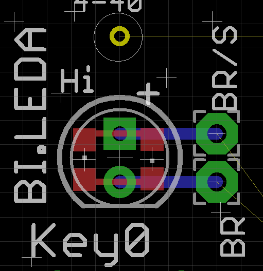

Hi all...the 2 SMT 0805 LEDs on the red layer are in parallel but opposing polarities. They have a common 2.5V but are driven by a Low or Hi digital 5V signal to select which one lights. The thru hole LED placement is a DNP item which I have as a bicolor LED option. Now the PCBA manufacturer installed both SMT LEDs in parallel , same polarity so I cannot select which one lights independently. I note the tplace layer shows 2 square dots close to the centre point with orientation info.
So Idk which file in my gerbers to look at so as to locate what went wrong. Can anyone advise?

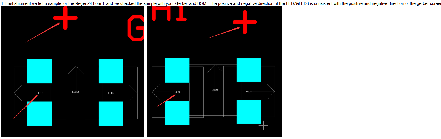

THis is the PCBA manufacturers response to me:
BTW the red '+' is just the silk screen left over from the bipolar thru hole LED option.
I agree that it's confusing with the plus sign from the through-hole LED adjacent to the "backwards" LED.

Something is curious though..based on the arrows for LED6 and 7 ..it appears that they SHOULD have been mounted with opposite polarities, not so?
The polarity of the surface mount LED is indicated by the small square dot, but it's ambiguous because of the much larger plus sign adjacent to it. Even with the proper pattern on the board, a human programs how the parts are placed in the pick&place machine.

Actually, the PCBA manufacturer...has admitted their mistake. They noted the silk screen instead of the actual part orientation when setting up the pick and place. run. They will reimburse for the re-work.
