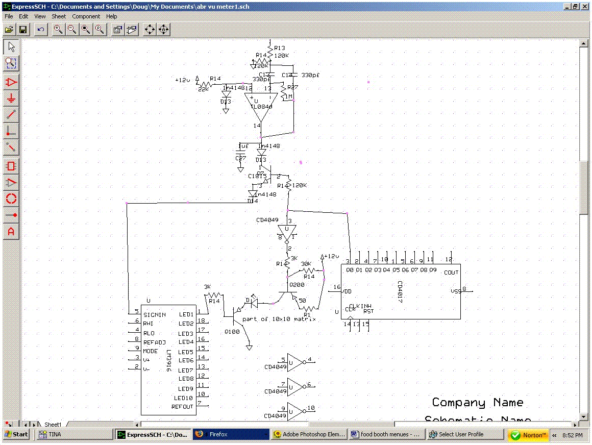

been getting some input from audioguru about multiplexing a 10 x 10 led matrix.
The issue of leds being to dim was discussed at length.
After finding this circuit I wonder if dim leds is an issue??
the planned circuit is attached (only one led of planned display is attached.

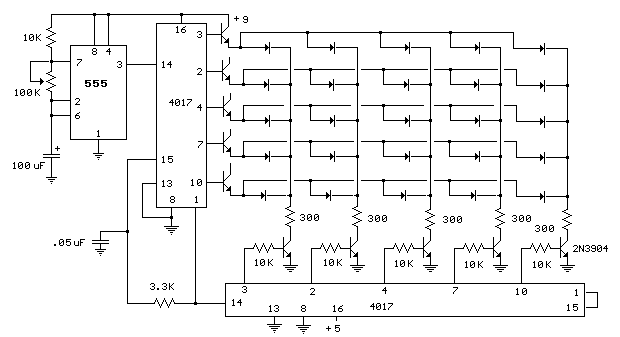

found another circuit that uses 2n3904 at both ends of the leds with one end having a 10K resistor connected to the base and a 300 ohm resistor connected to the collector.
Will try and locate circuit
Any advice??
https://www.best-microcontroller-projects.com/led-dot-matrix-display.html

Not sure I understand how a pair of 4017 Johnson counters display anything useful. The original circut uses a PIC with a parallel output. The 4017 works fine as a column driver I use a Johnson counter CD4022 in my Dragonfly schematic to drive seven segment LEDs.
The schematic on the left each LED get 23mA which is fine, should be nice and bright.
Since you're building a spectrum analyzer why not just use ten LM3916's no muxing nessary.
The link has a PIC with a 0.2V voltage loss when its output currents are a few mA.
The ULN2003 darlington driver has a loss of about 0.7V.
Red LEDs have a loss of 1.8V.
So the total losses are 2.7V and the 470 ohm current-limiting resistors create a current of 4.9mA which is not bright.
I can't see why your circuit is wired so oddly.
The display is multiplexed among 8 columns so each lighted LED has an average current of 4.9mA/8= 0.6mA which is very dim.
Maybe your LEDs look OK when they are very dim.
Bill Bowden's circuit on the left has pulses of 21mA in its LEDs. The 21mA is divided into 5 columns so each lighted LED has an average current of 4mA which is not bright and is not dim.
I havn't fine tuned the schematic
I kinda tried some other pc board prgs but big learning curve.
This may sound dumb but why are we dividing the current by number of rows?
I thought each row comes on seperatly? The lm3916 controls the colums and the 4017 controls the rows or vice versa.
I am kinda lost or ??
AFTER LOOKING at the multi plexed display using a pic I see no difference between a pic and an lm3916 as far as sinking current?? Of coarse putting a transistor at both ends.
Lost in Salmon, Idaho
An LED that has continuous 20mA current looks bright.
Multiplexing turns on one column at a time. So if there are 10 columns then an LED in one column is turned on for only 1/10th of the total time.
Your vision is slow and sees only the average amount of current which is 1/10th the continuous amount so the LED looks very dim.

Why do the ExpressSCH schematics look terrible? Is there no snap function?
hi Bill,
It looks like he has the Snap ON, he just isn't taking care in placing the end of the wires.. that why its looks a mess.
MrDEB,
Try to arrange the circuit drawing layout so that it 'flows' from left to right across the paper, it makes it a lot easier to read, so you will get better forum feedback...:)
Also switch the 'grid' OFF, using the Options menu before you screen capture.
I know these points might sound picky, but a better presentation will get a better response..:)
If you build the 2 * 4017 [x,y] LED scanner, how do you plan to change the 'pattern' being displayed.?
The PDF you posted looks pretty good, why not just build it exactly as in the PDF? Why bother trying to redesign it?
If you want to get better with any bit o software, practice, practice, practice. Try drawing something simple. Make it look like other schematics on the site. Try to draw something simple.

Hi MrDEB,
I notice a 1uF capacitor to ground at the output of the filter opamp. Then the opamp won't work, it will oscillate instead.
The capacitor is probably part of a peak detector circuit at the output of each filter opamp. The 1uF capacitor should be at the collector of the switching transistor.
Oups!!!!
Took another look at the oriental circuit--boy are you sharp.
I put the cap on wrong sife of diode.
