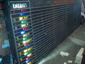

I have a project circuit I want to build. This comes from an old (1950's) horse derby game I want to build for home.
Like a pinball machine, the ball is shot up and falls into one of 3 lanes each has roll over switches. One lane has one switch, one has two switches and one has three rollover switches.
Every time the ball rolls over the switch, a wallboard with a horse advances one, two or the lights/spaces. This continues until the lights reach the end and a winner is declared.
How do I make LED lights advance across the wallboard? I can't find any info about circuits to explain how to turn the lights on and leave them on until the game ends. After two years of searching, I'm asking for help. Thanks in advance. Mike

As above, your question is missing a lot of detail. Please post a basic sketch of what you think the wall board will look like.
ak

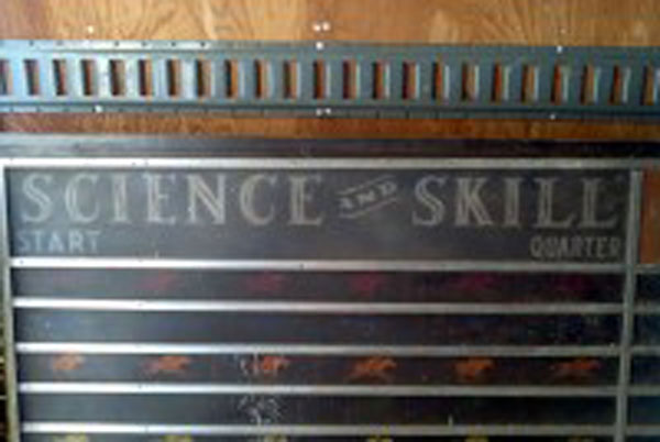

30 LEDs. The first six are on all the time. The game board has 24 lights. Here's a picture of what I want to build. This game is no longer made and the last one in existence (shown below) was parted out. The second picture is a close-up view of one of the four panels.
How many lights?
24 that light as the horse moves across the board

Here are some pictures of the very last original arcade game. Four panels with six lights behind the horse.
24 that light as the horse moves across the board.
Is the 6 LEDs for each of 4 horses, or 4 LEDs for each of 6 horses?
Also, as the lights move across the board for each horse, do the trailing lights stay on (bar graph display) or go out (moving dot display)?

Each panel has 6 horses so it would need six lights per panel. There are four panels equaling 24 lights.

It is a string of LEDs that light up as the rollover switch is activated. I need the switch to light a single light each time it is activated. The lights stay on until all 24 are lit. As for the number of players, this has 18 players so each player would have their own circuit. I imagine that it would have 18 separate circuits - each identical to the one prior. Not sure if it would be easier using regular light bulbs but LEDs seem the right way to go with this. Did this help?
