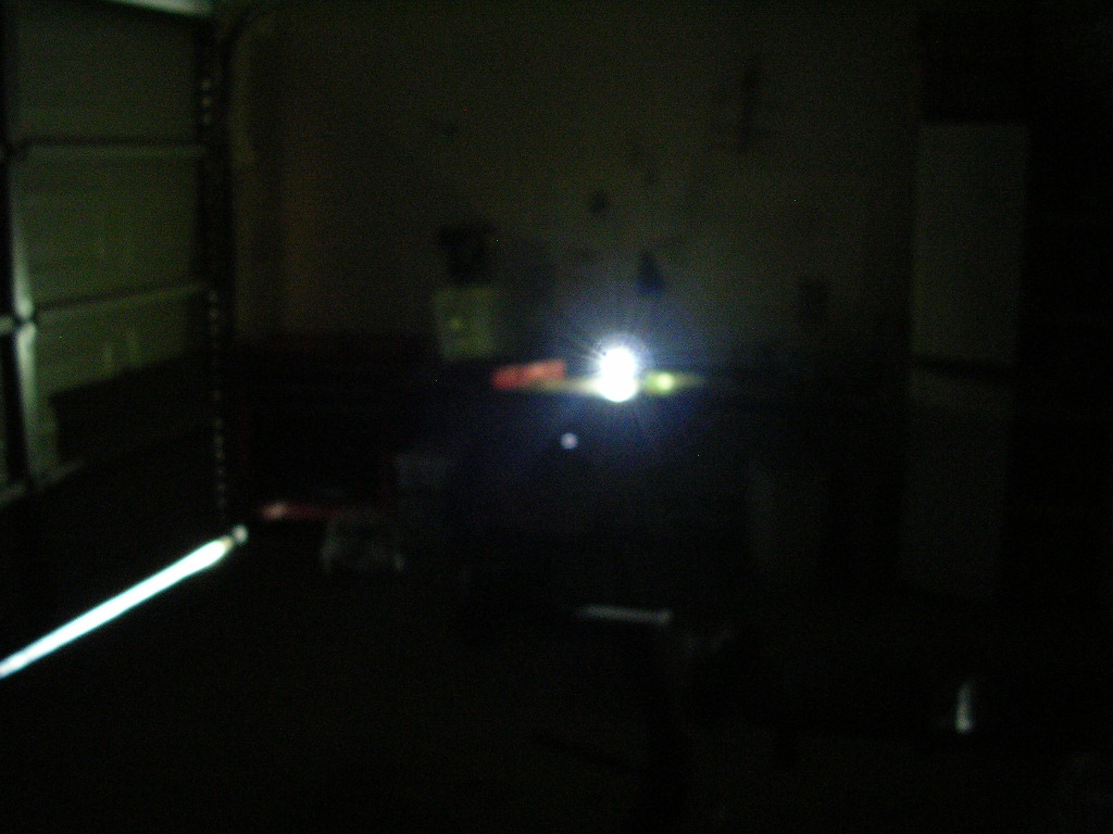

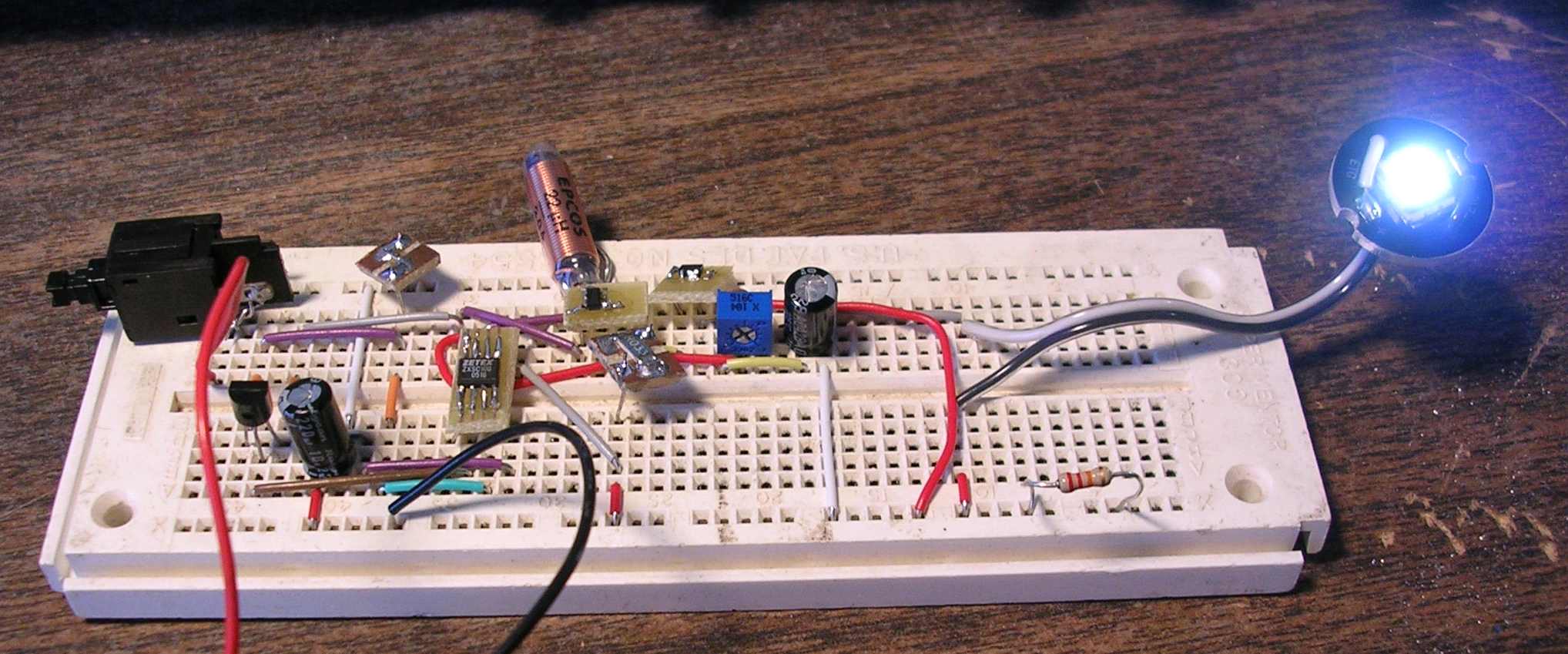

I GOT IT WORKING!!!!!!!!!!!!!!!!!!!!!!!!!!!!!!!!!! AFTER A MONTH OF TINKERING WITH THIS STUPID CIRCUIT I GOT IT WORKING!!!!!!!!!!!!!!!!!!! :lol:
I breadboarded it and fiddled around with it and somehow got it working, even though it is exactly the same as on the PCB. How or why it is working now is totally beyond me! Now I just have to make a PCB for it. I just got a digital camera so I thought i'd take some pics :lol:
The first pic is taken from across the garage.
Its only consuming 270mA!

Its DC to DC converter works by its oscillator driving a power transistor to conduct a high current in an inductor. Then it quickly stops the inductor's current and it develops an inductive voltage spike as its magnetic field collapses. The voltage spike charges the circuit's output capacitor to a voltage higher than the supply voltage. The IC senses the output voltage and regulates it as the battery voltage drops over its life. :lol:

R1 would likely cause problems the way you have it mounted on the board. 33mOhm is pretty low and the contact resistance of the board is probably higher than that, inconsistent too.
I agree. The wire from pin 5, should go directly to the top of R1, not via the board contacts. Also keep it as short as possible.
