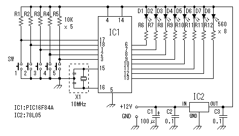

LED FLASHER.....
nenayd
i found this tutorial @ **broken link removed**
i tried it and it works, what if the switches are set to logic 0? what are modification needed in its code?
I'm presuming you mean the keys to +ve, and the resistors to gnd?.
All you need to do is replace the BTFSS lines with BTFSC in the 'Key Scan Process' routine.
