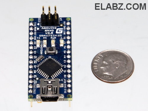

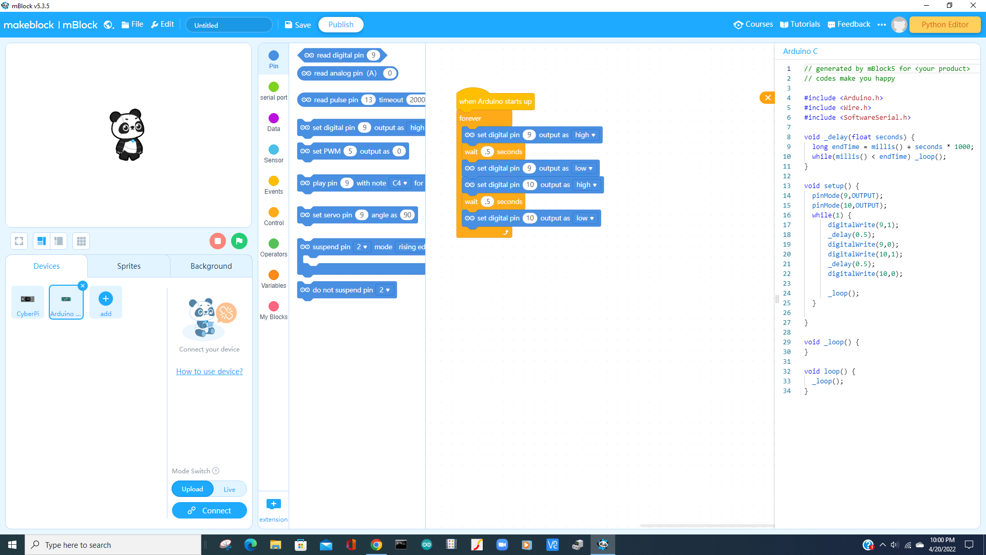

You will not need 50 uF caps, just a Nano or UNO board and free download
of mBlock.
mBlock takes your block config and generates Arduino code from it. Quick and dirty
for something simple like this. mBlock is free.
Here the two L:EDS alternately flash at a 2 Hz rate. You can set any rate you want.
You can trigger it with a button, or V level or pulse width rate or......
Nano board -

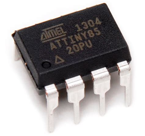

Of use ATTINY85 (program it with a Nano or UNO board )
