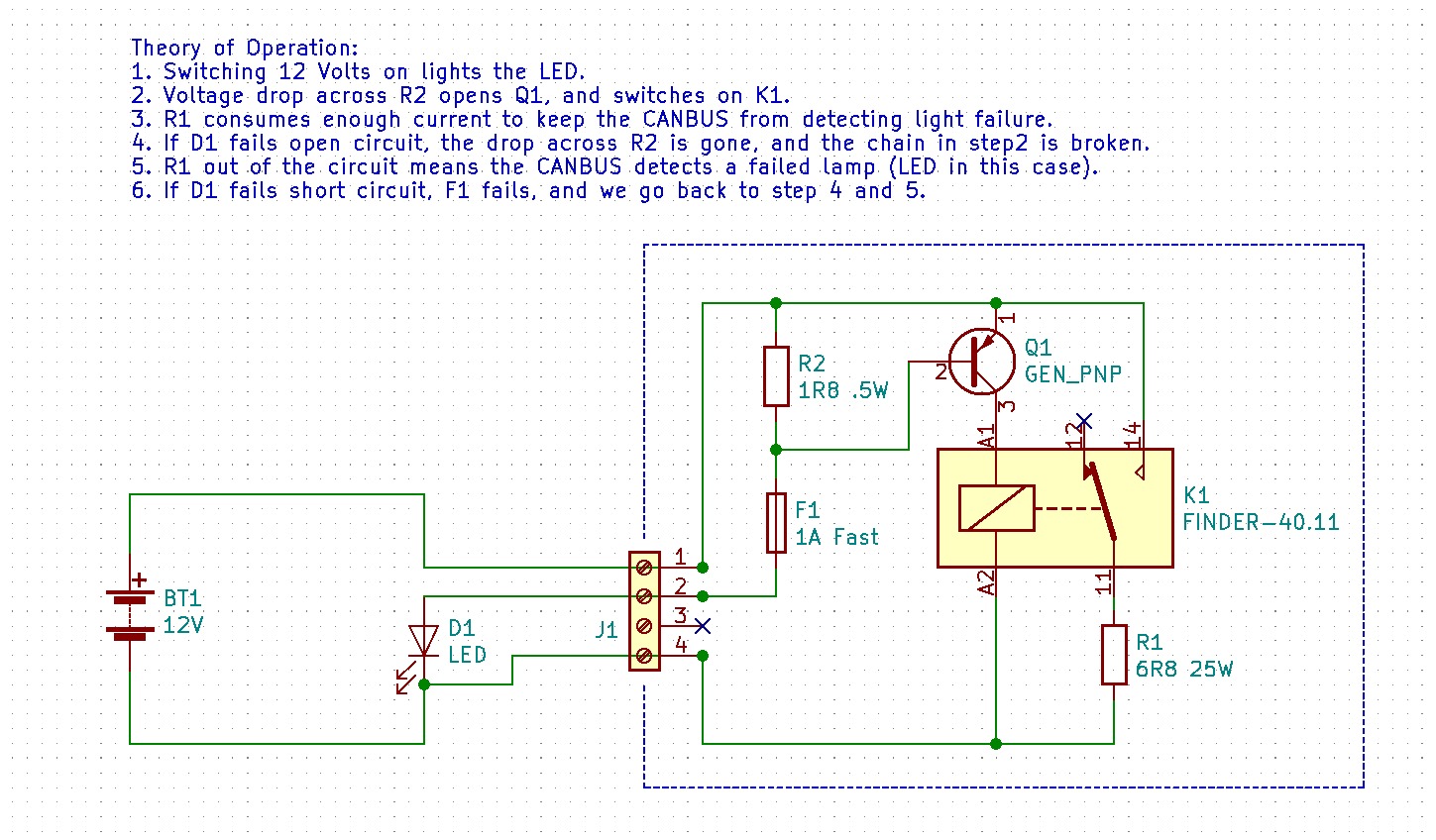

I own a Fiat Punto 12+. This car can not be fooled with canbus LED lights, other than using a resistor. But then the car will never detect a defect bulb anymore, untill the resistor will be defect to. So I am planning to build a box with some components to fool the canbus, but also with a faulty LED "detector" in it. So the plan is as following:
Form the light switch of the car, the cable will run in to the box. It will run thru a relay (the switchable side), then a resistor is placed and then it is grounded to the chassis.
That way, when the relay is in closed position, the car thinks there is a working light, so no canbus light warning. Before the relay, the wire will be tapped and connected to the LED light and the LED light is also connected to the ground. Then the hard part: I want to have someting to have the relay switch to the open position, as soon as the LED light is faulty.
So what I first need to know is: can I measure a faulty LED bulb, in my case it will be a BAU15s 5w LED bulb and if yes, what difference in voltage/amps/resistance will I meausure when a LED is faulty and it what ways can a LED be faulty?
Visual experience of my own have seen LED bulbs that just won't lightup/went out and LED bulbs that are flickering.
My father in law had the following idea:
BT1 will be the cars light switch.
Will this work, is there a better or other way to "open" the relay when the LED bulb is faulty or maybe a solution that will detect more faults?
I hope you can help me with this.
With kind regards,
Tinjo
I know it's common to call these CANbus lights, and "fooling the CANbus", but the communications bus on the car has nothing to do with the current sensing. The car might use the CANbus to carry the information about whether the lights are working, but loads of other information is on the CANbus as well. Historically, CANbus appears on cars at a similar point in time to bulb failure sensing, and they became thought-of as linked, which the're not.
Anyhow, rant over, and your scheme would most likely work. I have a few points to make.
I'm assuming that the LED in the circuit is actually the BAU15s 5w LED lamp, so it is rated to 12 V.
Most LED lights will take less current if they fail. However, many LED lights use many LEDs so the failure of one or some will still leave the lamp taking significant current.
If you are using a relay, you should put a diode or a resistor in parallel with the coil, to avoid the inductance of the coil generating huge voltage spikes as the transistor turns off. A diode is common, but that can slow the turning off of the relay, causing excessive contact arc at turn off. A resistor will result in more power consumption, and a larger voltage that the transistor has to withstand, but the relay will turn off faster.
You don't need the relay at all. Just put the big resistor in place of it's coil, and make sure the transistor is suitably rated. You will need a big transistor anyhow, as most of the LED lamp current will go through the base-emitter junction.
The resistor rating is marginal. It will dissipate around 21 W at 12 V, but around 29 W at 14 V, which is about what voltage you get with a car engine running. I guess that these will be direction indicators, so the average power will only be around 15 W, which isn't too bad, but the resistor will get really hot at that power. I suggest a 50W resistor. I have a similar concern about the 1.8 Ohm resistor.
You might want to put a capacitor in parallel with the 1.8 Ohm resistor. Some LED lights contain buck converters so the current taken has high frequency ripple. 10 uF or so here will help to keep the transistor from turning on and off rapidly.
You should check if the BAU15s 5w LED lamp has any resistors in parallel. Those are often called CANbus resistors. They should be removed, or if the LEDs themselves fail, the detection circuit would still be operated, and the blown bulb detection wouldn't work. I've seen some automotive LED lights where the resistors are in parallel with the whole circuit, and some where they are just in parallel with the LEDs. If there are resistors in parallel with the LEDs themselves, the current limiting circuit in the lamp be set for a suitable LED current, plus what the parallel resistor takes. If you remove the parallel resistor, more current will flow in the LEDs, which may damage them or make the light too bright, so you may need to adjust the current limiting circuit.
The resistors in parallel often result in the lamps running really hot, making the LEDs unreliable, which is another reason to remove them.
Some cars try to detect lights that are turned off. There are two methods of doing this, and both cause problems with LED lamps. One method is to put a few mA of current into the lights at all times, and to detect the voltage. With LED lamps, a few mA will often cause the LEDs to glow, and there will be a significant voltage across the LEDs, so the car thinks that the bulb is blown, while the lights glow all, or some of, the time. This is what the resistors in parallel with the LEDs are generally there to deal with.
The second method for detecting lights that are off is for cars to just turn the lights on to full power for around 1 ms, so too short a time for the filaments to get hot. This, of course, causes LED lights to flash. It's quite difficult to make a circuit to stop that happening.
Some cars will not turn lights on if the driver circuit hasn't already detected the bulb. If that is the case in your car, then your circuit won't work.

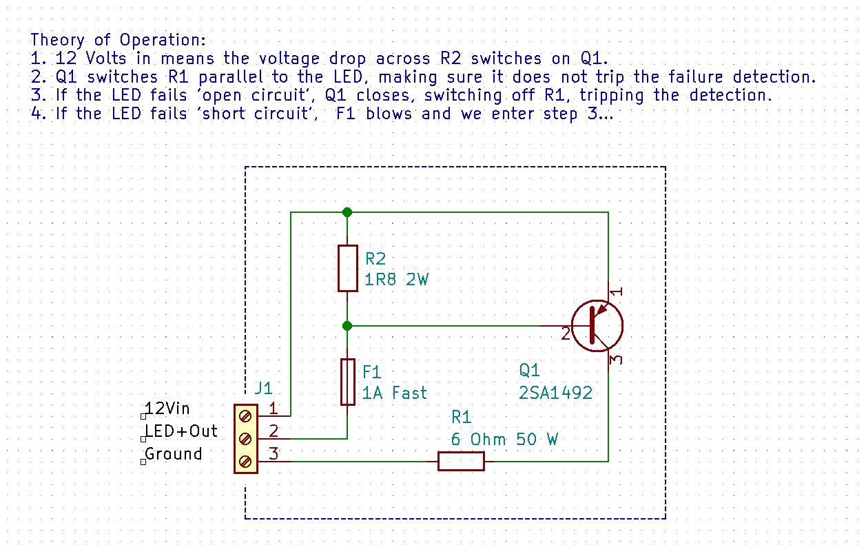

The circuit is now updated to this:

I think we are getting closer.
I don't know how much current the LED lamps will take, but the 1.8 Ohm resistor might need to be changed for a larger value, as with 1.8 Ohm it will take about 350 mA before the transistor turns on, and many LED lights will take less than that.
The 6 Ohm resistor will give well over 2 A at 14 V. As the total current will include the 350 mA, you will get quite a bit more current than a 21 W incandescent light. I think that the 6.8 Ohm or 8.2 Ohm would be fine.
Possibly this is the answer on detecting a faulty LED bulb by a current drop. If R2 is adjustable, maybe with a selector switch, it can switch off Q1 when the current is below the threshold. I can select what power of bulb I am using if I decide to use another LED bulb. The current LED bulbs are 5w each, if I decide to use 10W bulbs, I can switch to another R2 resistance, so the threshold will change.
Maybe I have to power the LED bulbs by a separate power line, with a 12V regulator in front, so we can have more consistant values?
Will do that tomorrow and will report back. Also I think I have to keep in mind that R2 will take a bit of voltage I guess, so the LED bulbs can be a bit dimmer with this setup. Am I correct?
All tested and have found the right value for R2 so when a 5W LED lamp takes less then 2.5 Watt, Q1 will switch off the power to R1 and the car will detect a "broken bulb". With this I have 3 detection points. Shots circuit, open circuit and a dimmed LED caused by failed/burned LED's.
