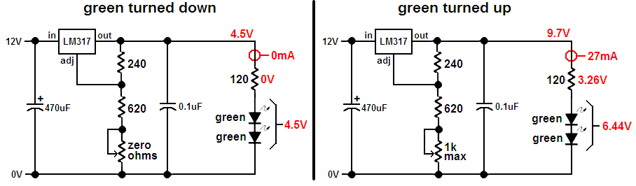

This circuit will work for the green LEDs but the pot will have some slack when the LEDs are off.

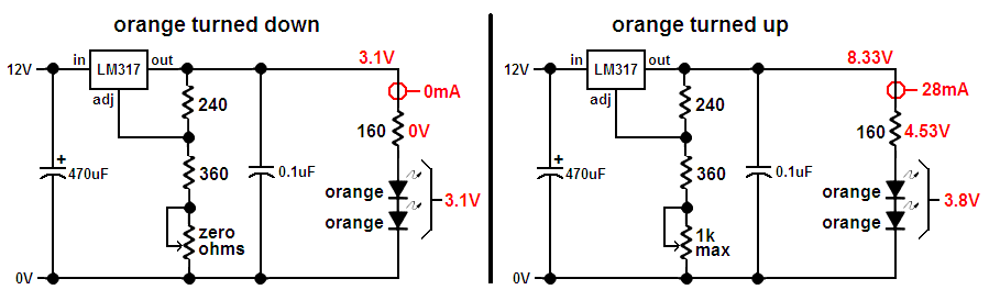

...i'd like to use the same circuit as before as i already have them made...just need to swap out the resistors once this is figured out
This circuit is for your orange LEDs.

okay thanks...these schematics are slightly different from the originals...an extra 0.1 capacitor in there....is this necessary??
Will the other one work properly by just changing the resistors to the values you have in these new ones without adding the capacitor??? :?
All circuits in the datasheet show a capacitor on the output of the regulator to keep it from oscillating if your wiring isn't perfect. Use a ceramic disc capacitor.

Still have a problem with the green LEDs for some reason....they are still dimmly on....they others all work fine :?
What do i need to check for these? circuits are made as per the recent schematic.

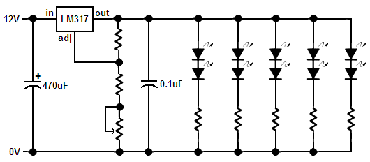

I see 10 LEDs but the circuit has only 2. What did you do? Make a bunch of these circuits?
I would take the two green LEDs with their 120 ohm current-limiting resistor, connect them to my variable voltage supply then turn down the voltage until they were off. Then I would set the circuit's minimum voltage to be a little less.
You can reduce the value of the 620 ohm resistor like this:
each color is on a seperate dimmer...they are wired in parallel series of 2leds
so basically i just change this resistor until they dim off??
Yes, change the resistor until the LEDs are dimmed enough.
Are you connecting LEDs in parallel? You shouldn't because then they would have different brighness levels as your display shows. Also, with LEDs in parallel then they share the current and are half as bright as they should be. Do it this way:
yes...that is how i have them...sorry maybe i'm using the wrong phrasing when i said paralleled series....is that not what this arrangement would be called? But yes its strange that these ones behave this way...some are brighter than others...only on the green leds are doing this...the white and oranges are fine...all the same brightness. :?
yup the 560 resistors did the trick...not sure why why the green leds have variation in brightness??...oh well...i can live with it..its only when they are very dim.
