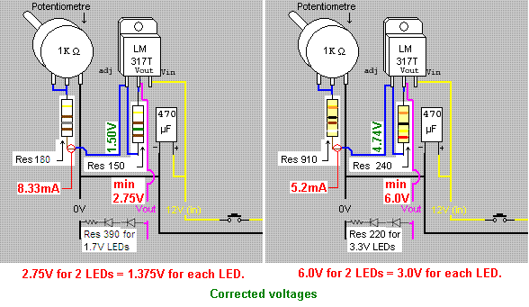

There aren't any curves on the datasheets for your LEDs so I am just guessing. The LM317 circuits for your Sea Green and White LEDs will be similar to this:

okay...a slight problem...all the LEDS are still on when the pots are turned down....so i need to reduce the value of the 180 resistor for 1.7volt leds and the 910 resistor for the for the 3.3volt leds schematics accordingly??
How much do I need to reduce it?? what do you suggest to try??
The orange LEDs are the only ones that dim totally off with the pot....but turning it up to max, the LED's are no where near as bright as they should be...what should i check on these?? The resistor for the LED in a series of 2 seems to be correct at 390. So does the resistor on the pot that you are saying to change also affect the max brightness of it...as these are the only ones that dim totally off but are not nearly as bright??

Did you build both circuits?
When the pots are turned down, measure the voltage of the regulators' outputs and the voltage across each LED.
Then in the 1st circuit, reduce the value of the 180 ohm resistor and in the 2nd circuit, reduce the value of the 910 ohm resistor.
I guess your LEDs are lower than 1.7V and 3.3V, so calculate the values of new resistors using Ohm's Law.

for the 1.7 leds i'm getting 2.77 where you have 2.75 and 1.53 where you have 1.25...i have no idea how to get a mA reading out of my meter..none of the settings i turn it to give me anything close the number you have there :? .
for the 3.3 leds i'm getting 6.02 where you have 6.0 and 4.77 where you have 1.25!?

Hi Airbrush,
I goofed on my calculation of the voltage at the ADJ terminals, your measurements were very close to my corrected calculations.
The current readings are determined by Ohm's Law, since you must break a connection to put a current meter in series. A current meter has a voltage drop so its reading would have error anyway.
The 1.7 circuit puts a max of 26.7mA through two 1.7V LEDs. The max continuous current rating for most LEDs is 30mA. So your orange LEDs are operating near their max.

Ok, if the green and white LEDs are rated at 3.3V each, then with two in series with a 220 ohm resistor, why do they light with the 6.02V that you measured? The only way to reduce their brightness is to measure their voltage then change the circuit to match.
You can'simply reduce the value of the 910 ohm resistor to dim the LEDs at minimum pot setting, because then their max brightness will also be reduced. The resistance of the 240 ohm resistor also must be reduced but not as much as the reduction of the value of the 910 ohm resistor.
So how do i keep their max brightness and still have then dim totally off...so is that why my orange ones that dim off are not as bright as they could be?? So you're saying that adjusting the 910 will adjust their min so the dim off and then adjusting the 240 will keep their max brightness?

Yes, but the resistors affect each other. We need to know the actual operating voltage of the LEDs and their series resistor to recalculate the resistors properly.

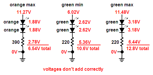

alright, here's what i have:
orange pot min:
2.77 vout
2.77 at the resistor
1.32 at the LEDs
orange pot max:
11.27 vout
2.78 at the resistor
1.88 at the LEDs
green pot min:
6.02 vout
5.36 at the resistor
2.62 at the LEDs
green pot max:
11.48 vout
6.44 at the resistor
3.18 at the LEDs
The voltages don't add correctly so I don't know what you are measuring.
To calculate the current of the LEDs, we need to know the voltage across the 390 ohm and 220 ohm resistors.
