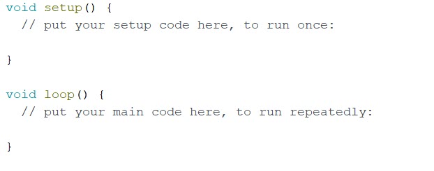

I haven't yet tried to run any program (or, in Arduino terminology 'sketch') but I have two questions.
Question 1:
I wrote the following code for PIC18 years ago and was wondering if there is a way to write the code in similar fashion in Arduino IDE as well. As you already know Arduino sketch is written using this format.
C:
#include <18f46k22.h>
#fuses  PLLEN,NOWDT, NOPUT, NOPROTECT, NOBROWNOUT,NOLVP INTRC_IO
#use delay(clock=64000000)
#define LED PIN_D2
void main() {
output_high(pin_d3);
while(TRUE) {
   delay_ms(15000);
   output_toggle(LED);
Question 2:

Question 1.
C:
#define LED  PIN_D2
void setup() {
  pinMode(LED, OUTPUT);    // sets the digital PIN_D2 as output
void loop() {
  digitalWrite(LED, HIGH); // sets the digital PIN_D2 on
  delay(1000);            // waits for a second
  digitalWrite(LED, LOW);  // sets the digital PIN_D2 off

The original code was written in C for CCS compiler. Arduino IDE also uses C language then why different syntax; for example, why "digitalWrite" instead of "output_high". Does it depend more on the compiler or IDE than on the language used for coding?
On the other hand, my original question was different but I phrased it poorly. In the code I mentioned, there is no "void setup()" or "void loop()"; the C code only uses "void main()". I wanted to ask if there is a way to configure Arduino IDE code so that we can write the code using "void main()".
No it doesn't, it uses C++, but (as far as I'm aware?) 'output_high' isn't a standard C function anyway, and nor is 'digitalwrite' a standard C++ function - both are specific individual functions of the particular compiler/IDE. In the digitalwrite case (at least) it hides the hardware from you, and GREATLY slows the speed of access.
The whole point of the chipKIT is to use the Arduino IDE, and the VAST amount of code that's already out there - if you want to run plain C then use MPLABX and connect a PK3/4 to the chipKIT, overwrite the bootloader, and forget about Arduino all together (but in which case, why buy a chipKIT?).

As per Nigel's comments... The Arduino IDE is indeed primarily a C++ environment.. BUT!!! The whole thing is based on the AVR C compiler and can be used with C style syntax with no issues..
The sketch
// We have globals first as all code
// then the setup() function
void setup(void)
   // stuff todo..
then we have a loop() function
void loop(void)
   // stuff todo..
//THEN!! this bit is added on compile.. You do not see this!!
void main(void)
   setup();
   while(1)
      loop();
So the arduino creates the same code as normal C/C++ coders use before the compile process..
No need to think any different.
As to the pinmode() function etc.. All these are prewritten wrapper functions...
