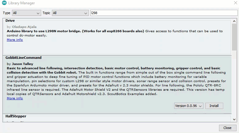

I found a couple of other libraries for L298N in Arduino IDE as shown below; not sure if some other library is better than the one mentioned below in the code.
l298-gif.127084

Be wary... Although the chipkit32 works in the Arduino environment.. Not all libraries will work... Be prepared to tweak the libraries if necessary ..
ie... Some programmers can be a tad lazy, I count myself in this category.. Some will use definitive registers within the code so they may not work outside the AVR family.. I would find a PIC32 library and call it from the Arduino IDE..

Q1 and Q2 are as is.... These are answered... A library for the pic32 is needed..
