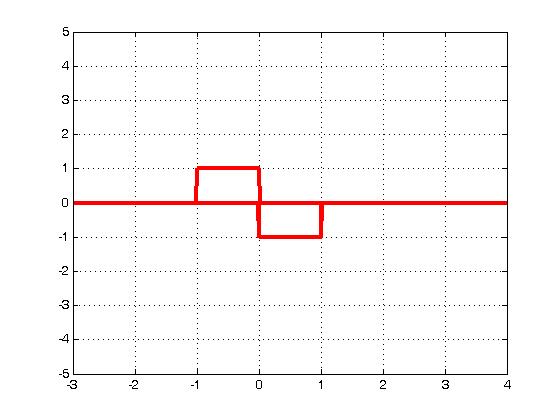

Hi again,
The code #1 isn't working. The code #2 works but isn't perfect as is evident from the plot. I'm sure you can see what I'm trying to do. Could you please tell me how I can do it in simple way? Thank you for the help.
% CODE #1
clc;
x=[-3:0.01:4];
y=1*ones(1,length(x)).*(x>=-1 & x<=0) & (y=-1*ones(1,length(x)).*(x>=0 & x<=1))
plot(x,y),axis([-3 4 -5 5]);
% CODE #2
clc;
x=[-3:0.01:4];
y=1*ones(1,length(x)).*(x>=-1 & x<=0);
z=-1*ones(1,length(x)).*(x>=0 & x<=1);
plot(x,y,'r',x,z,'r','linewidth',3),axis([-3 4 -5 5]),grid on;
In the first piece of code you have a stray "y=" halfway along the assignment of y.
I assume you want the displayed output to be the same as your attached image but without the apparent continuous line along y=0. Your code could be adapted to the following:
clc;
x=[-3:0.01:4];
y=1*(x>=-1 & x<=0) + -1*(x>=0 & x<=1);
plot(x,y,'r','linewidth',3),axis([-3 4 -5 5]),grid on;
The expression: "x > 2" will result in a vector as long as x, but the entries will be 0 where the corresponding x(i) value is <= 2 and 1 where x(i) > 2. So e.g. if x = 1:5, then x > 2 will be [0 0 1 1 1]. Therefore you don't need to multiply elementwise by ones(1, length(x)), which actually will have no effect.
